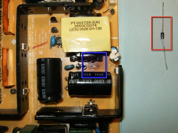

    • This is the LG 17LX1R that will no longer turn on.
    • Remove the cover from the stand by.
    • Press down on the two tabs. The cover should come off easily.
    • Remove the four screws that hold the stand assembly to the chassis.
  2. Repairing LG 17LX1R LCD Television Power board: crwdns2935265:02crwdnd2935265:01crwdnd2935265:03crwdne2935265:0 Repairing LG 17LX1R LCD Television Power board: crwdns2935265:02crwdnd2935265:02crwdnd2935265:03crwdne2935265:0 Repairing LG 17LX1R LCD Television Power board: crwdns2935265:02crwdnd2935265:03crwdnd2935265:03crwdne2935265:0
    • Remove the four Phillips head screws that attach the stand to the chassis.
    • Remove the eight Phillips screws that hold the back to the chassis. Once the screws are removed, the back will simply snap off.
    • Remove the metal shield. It is fastened with six Phillips screws.
  3. Repairing LG 17LX1R LCD Television Power board: crwdns2935265:03crwdnd2935265:01crwdnd2935265:03crwdne2935265:0 Repairing LG 17LX1R LCD Television Power board: crwdns2935265:03crwdnd2935265:02crwdnd2935265:03crwdne2935265:0 Repairing LG 17LX1R LCD Television Power board: crwdns2935265:03crwdnd2935265:03crwdnd2935265:03crwdne2935265:0
    • After the shield is removed, the power board and the main board are visible.
    • Power Board
    • Main Board
    • Fuse
    • Check all capacitors for blown tops and/or leakage.
    • Thoroughly inspect the boards. Brown discoloration around Diode D102 is evidence of a short circuit, possibly a blown component.
    • Disconnect all connectors from the power board
    • Remove the four screws that mount the power board to the chassis.

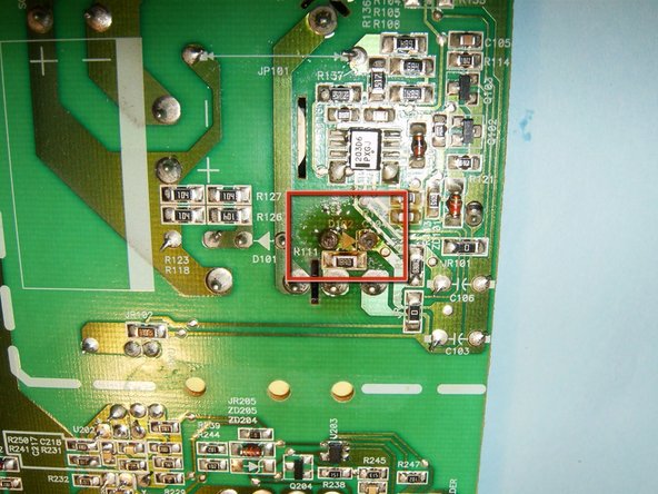

    • These are the chassis with the power board removed.

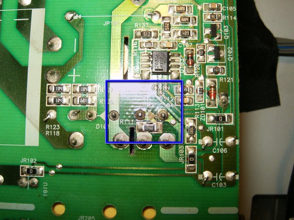

    • Discoloration of the back side of the power board is a sign of a faulty diode.
    • Unsolder the diode from the power board.
    • Replacement diode
  5. Repairing LG 17LX1R LCD Television Power board: crwdns2935265:05crwdnd2935265:01crwdnd2935265:03crwdne2935265:0 Repairing LG 17LX1R LCD Television Power board: crwdns2935265:05crwdnd2935265:02crwdnd2935265:03crwdne2935265:0 Repairing LG 17LX1R LCD Television Power board: crwdns2935265:05crwdnd2935265:03crwdnd2935265:03crwdne2935265:0

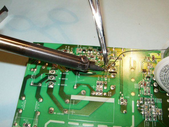

    • Here is the removed diode. Description on the diode reads LT526 IN4007.
    • Solder the new diode onto the power board. Use a pair of tweezers or hemostat to hold the diode in place while soldering.
    • Once the diode is replaced, clean the board with isopropyl alcohol to get rid of any debris or old flux.
  6. Repairing LG 17LX1R LCD Television Power board: crwdns2935265:06crwdnd2935265:01crwdnd2935265:01crwdne2935265:0
    • Device powers on and has audio and video after the repair.
