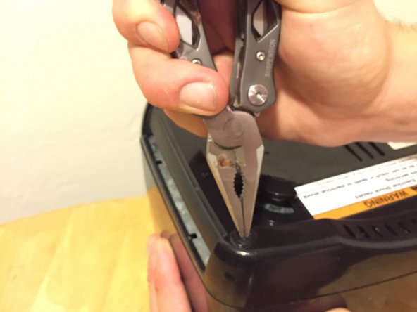

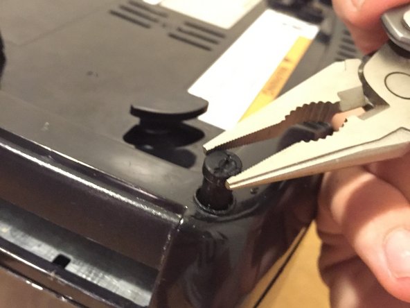

    • Flip the toaster upside down.
    • Use needle nose pliers to remove the rubber screw covers located on the four corners of the bottom of the toaster.
  4. Repairing Kitchenaid KMT422CU1 Catch Lever: crwdns2935265:04crwdnd2935265:01crwdnd2935265:02crwdne2935265:0 Repairing Kitchenaid KMT422CU1 Catch Lever: crwdns2935265:04crwdnd2935265:02crwdnd2935265:02crwdne2935265:0

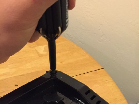

    • Use the screwdriver to remove the four 12.5 mm Phillips #1 screws. The screws are located on the four corners of the toaster under the rubber covers.
    • To remove the screws, turn the screwdriver counterclockwise.

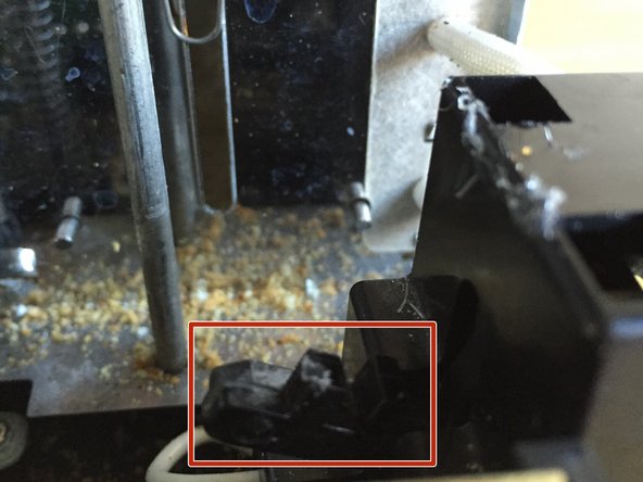

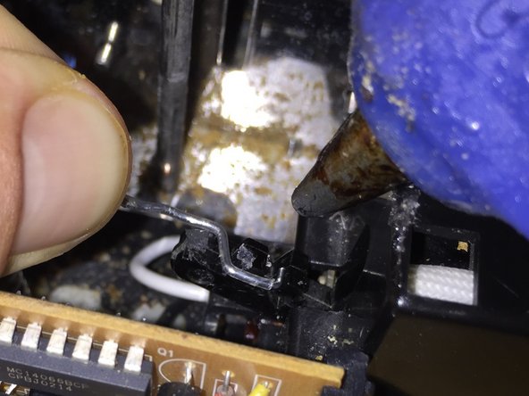

    • Locate broken metal lever catch to the right of the large spring. It should look like a paperclip.
    • Remove it carefully with your fingers or needle nose pliers.
  7. Repairing Kitchenaid KMT422CU1 Catch Lever: crwdns2935265:07crwdnd2935265:01crwdnd2935265:03crwdne2935265:0 Repairing Kitchenaid KMT422CU1 Catch Lever: crwdns2935265:07crwdnd2935265:02crwdnd2935265:03crwdne2935265:0 Repairing Kitchenaid KMT422CU1 Catch Lever: crwdns2935265:07crwdnd2935265:03crwdnd2935265:03crwdne2935265:0

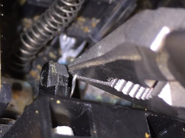

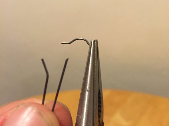

    • Use needle nose plyers to pry off the remaining piece of the broken metal lever catch.
    • The broken metal lever catch pieces are pictured in the third picture.
  8. Repairing Kitchenaid KMT422CU1 Catch Lever: crwdns2935265:08crwdnd2935265:01crwdnd2935265:03crwdne2935265:0 Repairing Kitchenaid KMT422CU1 Catch Lever: crwdns2935265:08crwdnd2935265:02crwdnd2935265:03crwdne2935265:0 Repairing Kitchenaid KMT422CU1 Catch Lever: crwdns2935265:08crwdnd2935265:03crwdnd2935265:03crwdne2935265:0

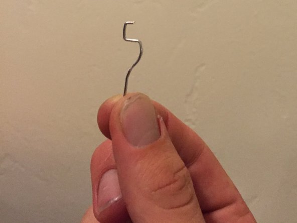

    • Take new paperclip with needle nose plyers.
    • Bend in paperclip into the hook shape pictured so it will be able to loop around the divots on the plastic lever.
    • The divots on the plastic lever are shown in the third picture.
  9. Repairing Kitchenaid KMT422CU1 Catch Lever: crwdns2935265:09crwdnd2935265:01crwdnd2935265:03crwdne2935265:0 Repairing Kitchenaid KMT422CU1 Catch Lever: crwdns2935265:09crwdnd2935265:02crwdnd2935265:03crwdne2935265:0 Repairing Kitchenaid KMT422CU1 Catch Lever: crwdns2935265:09crwdnd2935265:03crwdnd2935265:03crwdne2935265:0

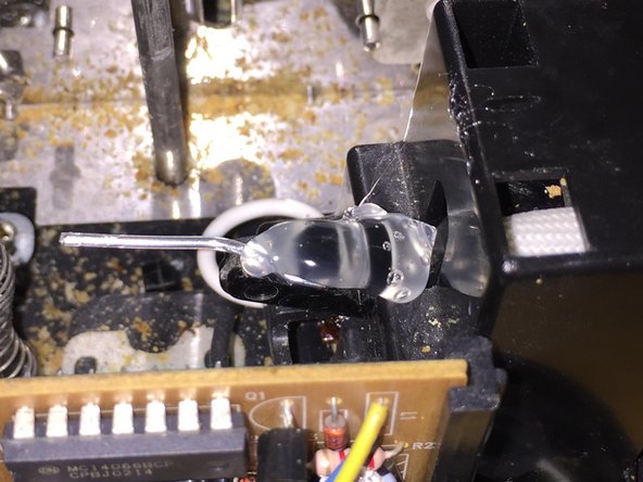

    • Place the newly bent paperclip onto plastic lever weaving it through the divots. Make sure that when the main spring comes down it engages the paperclip to push the lever down.
    • When the plastic lever is pushed down, the magnet engages and the timer on the toaster starts. As long as the paperclip stays glued on, the toaster will function fine because the magnet actually holds the toast down. The plastic lever just engages the magnet. The paperclip's main purpose is to extend the lever so it will be able to engage.
    • Use an adhesive to bond the paperclip to the plastic lever. A plastic welding adhesive such as JB weld will work best but super glue or even a hot glue gun will work as well. As long as the paperclip stays glued on, the toaster will function fine. Make sure to fully cover the paperclip with the adhesive.
