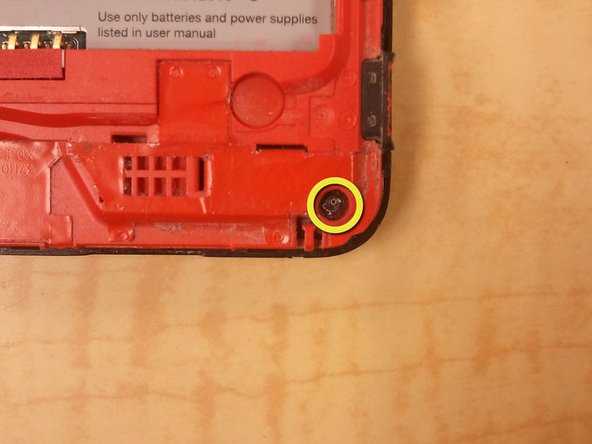

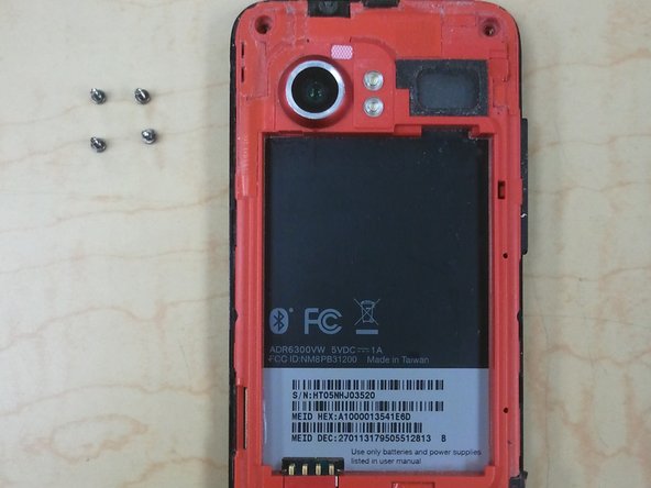

  4. Repairing HTC Droid Incredible Logic Board: crwdns2935265:04crwdnd2935265:01crwdnd2935265:03crwdne2935265:0 Repairing HTC Droid Incredible Logic Board: crwdns2935265:04crwdnd2935265:02crwdnd2935265:03crwdne2935265:0 Repairing HTC Droid Incredible Logic Board: crwdns2935265:04crwdnd2935265:03crwdnd2935265:03crwdne2935265:0
    • Remove 4 corner screws, you may have to remove a "VOID" sticker from one of the screw heads.

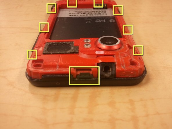

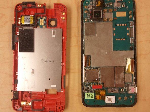

  5. Repairing HTC Droid Incredible Logic Board: crwdns2935265:05crwdnd2935265:01crwdnd2935265:03crwdne2935265:0 Repairing HTC Droid Incredible Logic Board: crwdns2935265:05crwdnd2935265:02crwdnd2935265:03crwdne2935265:0 Repairing HTC Droid Incredible Logic Board: crwdns2935265:05crwdnd2935265:03crwdnd2935265:03crwdne2935265:0
    • Using a spudger, unclip the nine clips holding the back panel to the front panel, highlighted in included pictures.
    • Start at the top, and work clockwise, being careful not to break the clips.
    • There are, 1, 3, 2, and 3 clips on each side, respectively.
    • After the clips are disengaged, there are no cables holding the back panel in place.
  6. Repairing HTC Droid Incredible Logic Board, Logic Board: crwdns2935265:06crwdnd2935265:01crwdnd2935265:01crwdne2935265:0
    • Use your spudger to release the remaining clips, disconnecting the ribbon cables from the logic board.

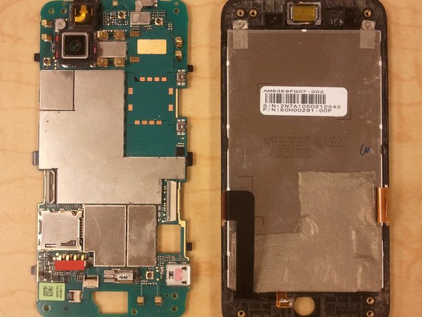

  7. Repairing HTC Droid Incredible Logic Board: crwdns2935265:07crwdnd2935265:01crwdnd2935265:02crwdne2935265:0 Repairing HTC Droid Incredible Logic Board: crwdns2935265:07crwdnd2935265:02crwdnd2935265:02crwdne2935265:0
    • Remove 2 Phillips Screws holding the logic board to the front panel.
    • Gently lift the logic board off the front panel.
