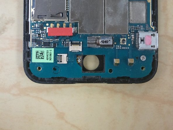

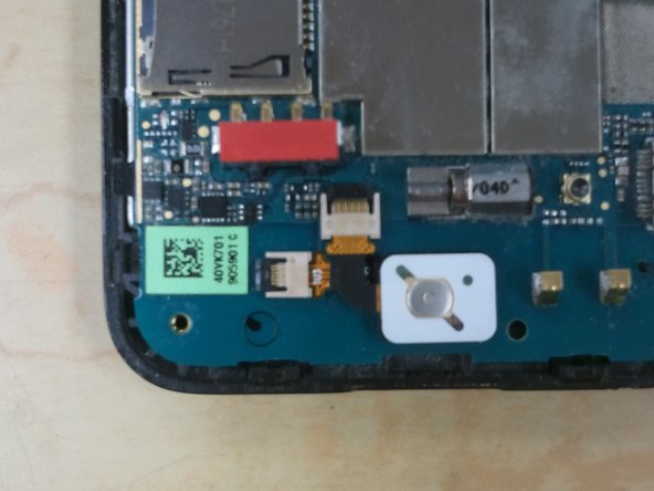

  6. Repairing HTC Droid Incredible Digitizer, Optical Track Pad: crwdns2935265:06crwdnd2935265:01crwdnd2935265:03crwdne2935265:0 Repairing HTC Droid Incredible Digitizer, Optical Track Pad: crwdns2935265:06crwdnd2935265:02crwdnd2935265:03crwdne2935265:0 Repairing HTC Droid Incredible Digitizer, Optical Track Pad: crwdns2935265:06crwdnd2935265:03crwdnd2935265:03crwdne2935265:0
    • Use your spudger to release the jaw clip holding the Optical Track Pad cable to the logic board.
    • Remove Optical Track Pad from logic board.
  7. Repairing HTC Droid Incredible Digitizer, Logic Board: crwdns2935265:07crwdnd2935265:01crwdnd2935265:01crwdne2935265:0
    • Use your spudger to release the remaining clips, disconnecting the ribbon cables from the logic board.

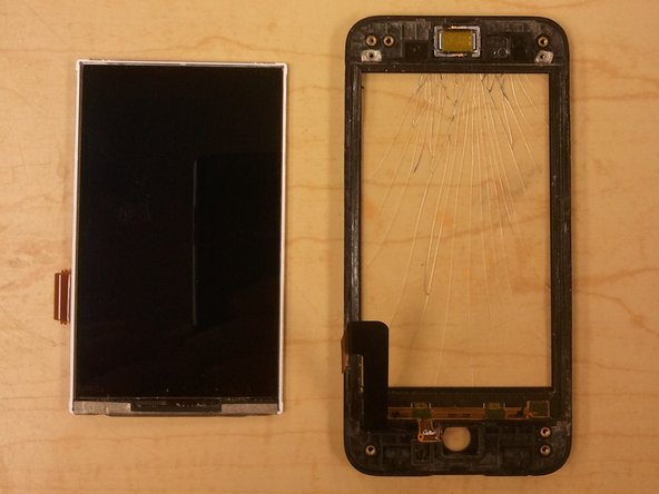

  9. Repairing HTC Droid Incredible Digitizer, LCD: crwdns2935265:09crwdnd2935265:01crwdnd2935265:02crwdne2935265:0 Repairing HTC Droid Incredible Digitizer, LCD: crwdns2935265:09crwdnd2935265:02crwdnd2935265:02crwdne2935265:0
    • Remove the two phillips screws from the top of the LCD frame.
    • Use your spudger to pry the LCD out of the frame.

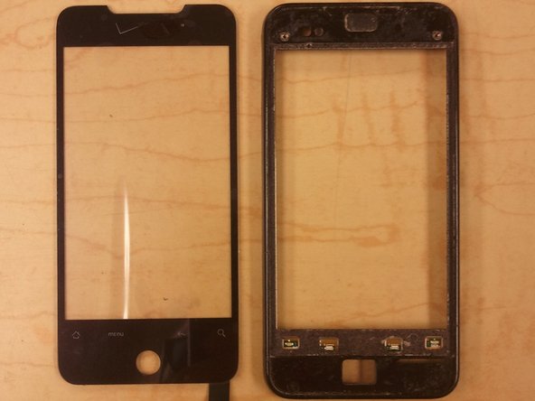

  10. Repairing HTC Droid Incredible Digitizer, Digitizer Assembly: crwdns2935265:010crwdnd2935265:01crwdnd2935265:02crwdne2935265:0 Repairing HTC Droid Incredible Digitizer, Digitizer Assembly: crwdns2935265:010crwdnd2935265:02crwdnd2935265:02crwdne2935265:0
    • Once the LCD has been removed from the frame, the Digitizer can be gently pushed out from the back.
    • Be sure to catch the speaker cover as it is released from the digitizer, you will need to replace it when reinstalling the digitizer.
    • There is adhesive tape holding the Digitizer to the front panel, heating around the edges of the digitizer will help to loosen it, if it sticks.
    • After the digitizer is removed, you may wish to remove the adhesive tape and reapply before replacing the digitizer.
