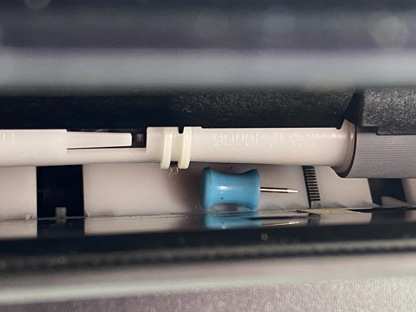

    • Check the input tray for any foreign objects.
    • You may need to hold down the input tray and shine a flashlight inside to have a better look.
    • Long tweezers are recommended to remove objects such as thumbnails and tacks.

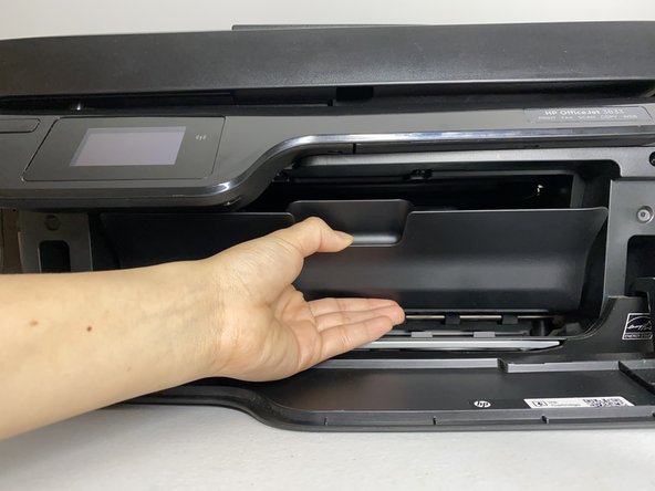

  4. Repairing HP OfficeJet 3833 Paper Jam: crwdns2935265:04crwdnd2935265:01crwdnd2935265:02crwdne2935265:0 Repairing HP OfficeJet 3833 Paper Jam: crwdns2935265:04crwdnd2935265:02crwdnd2935265:02crwdne2935265:0
    • Check the output tray, located in the front of the printer, for paper remains and remove them.

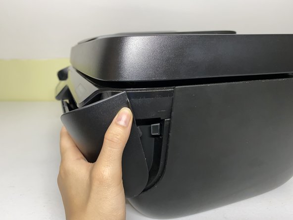

    • Pull back on the front sides of the printer to remove the front panel.
    • Then pull the handle inside to remove the ink cartridge panel.
