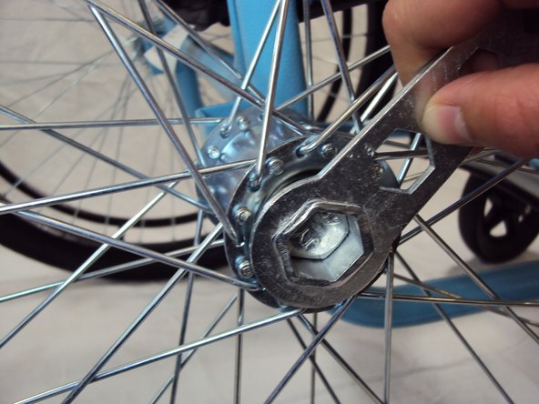

    • Unscrew the axle nut with a 19 mm wrench.
    • Unscrew the the axle bolt with a 19 mm socket wrench.
    • Remove the wheel from the wheelchair.

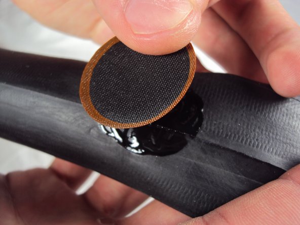

    • Apply a thin layer of rubber cement over the area that was marked.
    • The layer should be slightly bigger than the size of the hole.
    • Let the rubber cement set for 5 minutes.
    • Peel the patch off of the plastic backing.
    • Place patch over the area with the rubber cement and firmly press down until the patch is securely attached.

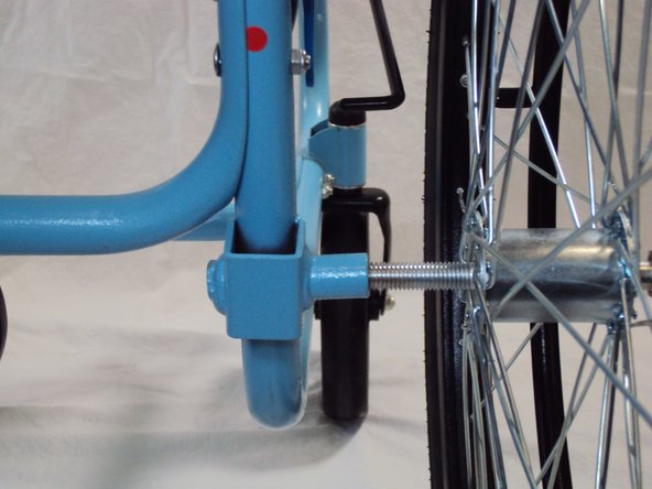

    • Insert the axle bolt into the center of the rear wheel.
    • Insert the wheel with the axle bolt into the lower back of the frame by screwing in the bolt.
  10. Repairing GEN 2 Wheelchair Patching a Tire Tube: crwdns2935265:010crwdnd2935265:01crwdnd2935265:02crwdne2935265:0 Repairing GEN 2 Wheelchair Patching a Tire Tube: crwdns2935265:010crwdnd2935265:02crwdnd2935265:02crwdne2935265:0
    • Secure the nut on the opposite side of the axle bolt and wheel. Tighten with 1/2 in or 19 mm wrench.
