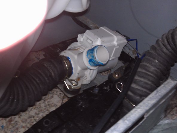

    • Follow all basic appliance repair safety protocols.
    • Make sure the washing machine is drained of water. Since the washing machine drain pump is malfunctioning this may be accomplished, strangely, by blowing air into the drain tube. Then continuing the cycle in the menu. I don't know what to do otherwise because this worked for me.
    • Unplug the power plug from the wall outlet.

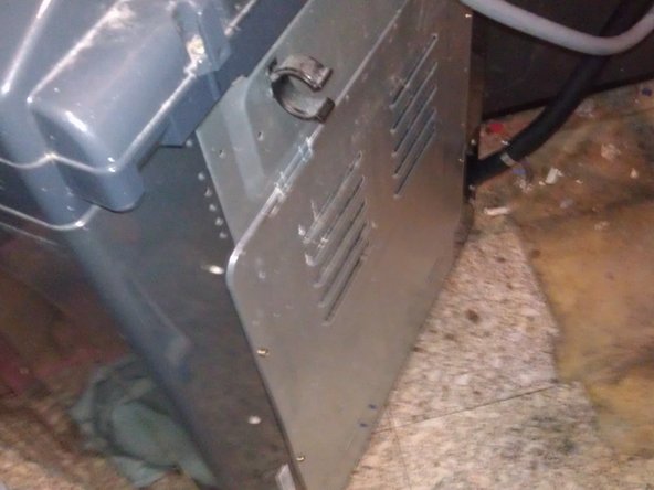

    • Remove the back panel. Four Screws.
  2. Repairing GE Washer WPGT9350COPL Drain Pump: crwdns2935265:02crwdnd2935265:01crwdnd2935265:03crwdne2935265:0 Repairing GE Washer WPGT9350COPL Drain Pump: crwdns2935265:02crwdnd2935265:02crwdnd2935265:03crwdne2935265:0 Repairing GE Washer WPGT9350COPL Drain Pump: crwdns2935265:02crwdnd2935265:03crwdnd2935265:03crwdne2935265:0

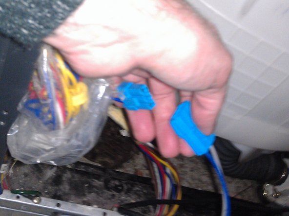

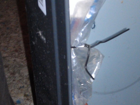

    • There is a plastic bag around the wire harness at the left edge of the opening.
    • Untwist the wire wrap and open this "bag".
    • Remove the pump wire from the wire clips along the bottom of the machine until the pump wire is free except where it connects to the pump and the wire bundle in the "bag".
    • Unplug the pump wire connector.
    • With the machine completely drained of water remove the hoses from the drain pump. !!!BUT WOAH ANY WATER LEFT IN THE MACHINE WILL FLY OUT OF THESE HOSES!!! I encountered a few gallons but there can be much much more depending on how well the machine is drained.

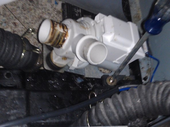

  3. Repairing GE Washer WPGT9350COPL Drain Pump: crwdns2935265:03crwdnd2935265:01crwdnd2935265:03crwdne2935265:0 Repairing GE Washer WPGT9350COPL Drain Pump: crwdns2935265:03crwdnd2935265:02crwdnd2935265:03crwdne2935265:0 Repairing GE Washer WPGT9350COPL Drain Pump: crwdns2935265:03crwdnd2935265:03crwdnd2935265:03crwdne2935265:0

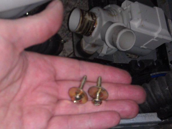

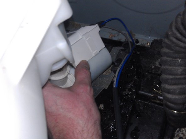

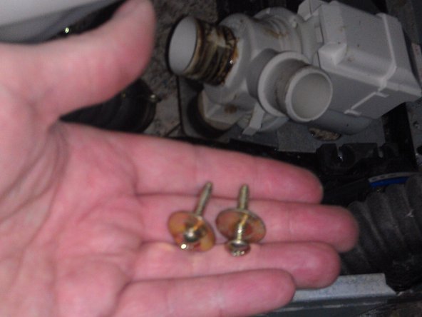

    • Remove two screws from the pump mount. These are located on the side of the pump closest to the opening.
    • Rock the pump back away from you off of the screw holes and pull the pump free.

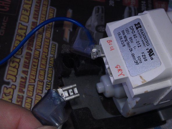

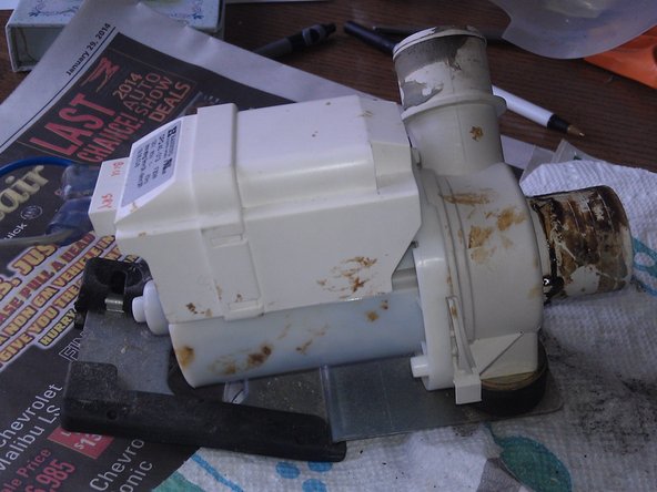

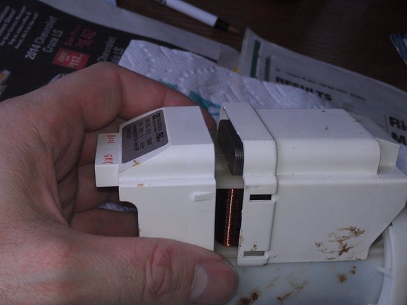

    • Bring pump to a bench.
    • Label the terminals with a permanent marker indicating wire color.
    • Remove the screws from the base and remove the base.
  5. Repairing GE Washer WPGT9350COPL Drain Pump: crwdns2935265:05crwdnd2935265:01crwdnd2935265:03crwdne2935265:0 Repairing GE Washer WPGT9350COPL Drain Pump: crwdns2935265:05crwdnd2935265:02crwdnd2935265:03crwdne2935265:0 Repairing GE Washer WPGT9350COPL Drain Pump: crwdns2935265:05crwdnd2935265:03crwdnd2935265:03crwdne2935265:0

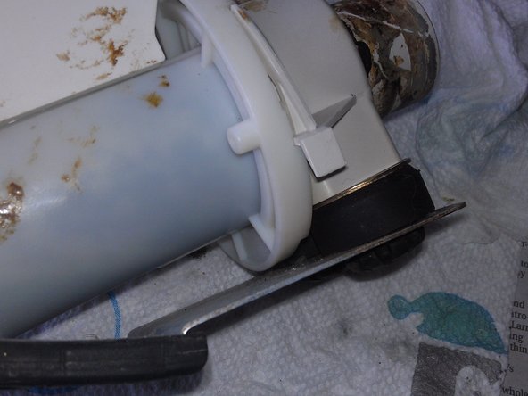

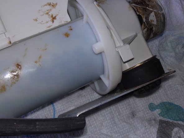

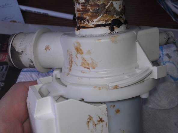

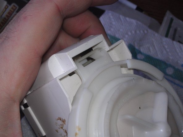

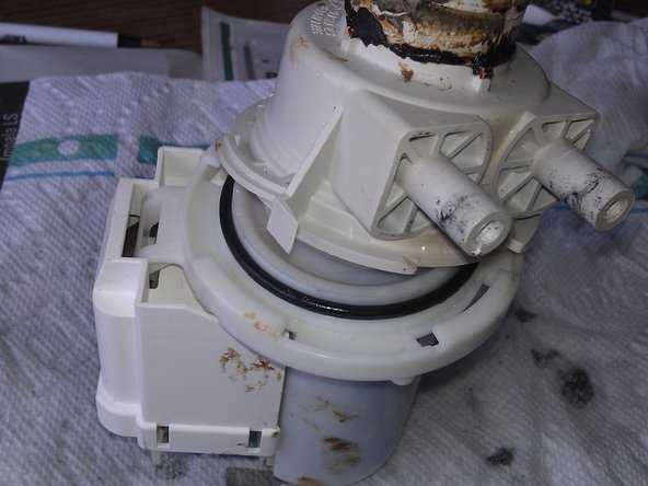

    • Remove the rear cover from the pump motor. (Notice it's a brushless motor, NICE! :) )
    • Look at the side of the pump body and locate a latch. (image 2)
    • Carefully lift the latch with a screwdriver and rotate the pump body clockwise. The pump body will come off.

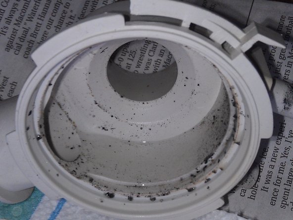

  6. Repairing GE Washer WPGT9350COPL Drain Pump: crwdns2935265:06crwdnd2935265:01crwdnd2935265:03crwdne2935265:0 Repairing GE Washer WPGT9350COPL Drain Pump: crwdns2935265:06crwdnd2935265:02crwdnd2935265:03crwdne2935265:0 Repairing GE Washer WPGT9350COPL Drain Pump: crwdns2935265:06crwdnd2935265:03crwdnd2935265:03crwdne2935265:0

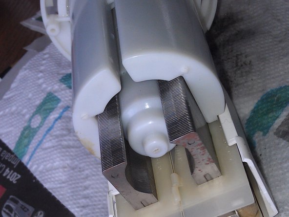

    • There is a clip at the top of the pump motor that can be undone with a flat screwdriver.

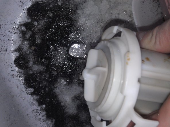

    • The motor coils and cover can then slide back leaving just the plastic motor body containing the magnetic spindle.
    • The plastic motor body has a large reservoir to collect any accumulated debris and keep it separated from the motor spindle.
    • This was packed with accumulated sand and interfered with the motor spindle.
  7. Repairing GE Washer WPGT9350COPL Drain Pump: crwdns2935265:07crwdnd2935265:01crwdnd2935265:03crwdne2935265:0 Repairing GE Washer WPGT9350COPL Drain Pump: crwdns2935265:07crwdnd2935265:02crwdnd2935265:03crwdne2935265:0 Repairing GE Washer WPGT9350COPL Drain Pump: crwdns2935265:07crwdnd2935265:03crwdnd2935265:03crwdne2935265:0
    • The pump is now fully disassembled. The non-electrical parts can be cleaned, specifically the motor body's dirt reservoirs.
    • Repeatedly fill the motor body with water and flush out the collected sand. The plastic flange under the impeller can be lifted slightly allowing an easy path for the sand and water.

    • Replace the o-ring on the pump. I used a small amount of petroleum jelly to lubricate and seal the o-ring.
    • Align and twist the pump body into position counter clockwise until the latch engages.
    • Reinstall the pump base with its two screws.

  11. Repairing GE Washer WPGT9350COPL Drain Pump: crwdns2935265:011crwdnd2935265:01crwdnd2935265:03crwdne2935265:0 Repairing GE Washer WPGT9350COPL Drain Pump: crwdns2935265:011crwdnd2935265:02crwdnd2935265:03crwdne2935265:0 Repairing GE Washer WPGT9350COPL Drain Pump: crwdns2935265:011crwdnd2935265:03crwdnd2935265:03crwdne2935265:0
    • Reinstall the pump into the washing machine.
    • Hook the back edge of the pump into its mounts and rock it forward onto the mounting screw points.
    • Install the two mounting screws.

    • Route the pump wire back through the clips that are built into the floor of the washer.
    • Reconnect the pump wire plug.
    • Tuck the connectors back into the "bag" and secure the wire wrap.

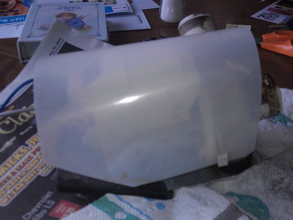

  14. Repairing GE Washer WPGT9350COPL Drain Pump: crwdns2935265:014crwdnd2935265:01crwdnd2935265:02crwdne2935265:0 Repairing GE Washer WPGT9350COPL Drain Pump: crwdns2935265:014crwdnd2935265:02crwdnd2935265:02crwdne2935265:0
    • Reinstall the plastic pump umbrella, since it falls off in the installation process.
    • Replace the back cover of the washer.
    • Allow the RTV to cure for a few hours before testing the repair.

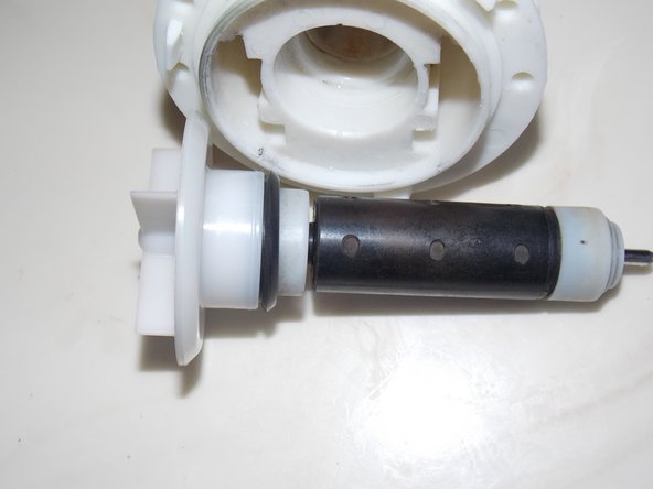

    • For this discussion the core comprises of the following as one unit: rotary blade, lid, rubber seal, spindle and magnet. To remove the core, gently pry with a flat head screw driver all around the top edge and gently lift the core out of the case housing.
    • The location to pry is NOT directly under the rotary blade, but under the cover piece which resides directly BELOW the rotary blade. If you look at the picture for this step, you see the pump standing upright.
    • Going from top to bottom, first is the rotary blade, then below the rotary blade is the lid (which covers the pump case housing), then there is a small gap between the lid and the case housing and then the black o-ring and then the rest of the case housing. Gently pry in the small gap between the lid and the case housing to remove the core.
    • The core is only being held in place by the rubber stopper and the magnetic forces. One advantage to removing the core, is that you will have full access to clean the junk out of the side chambers in the pump and it will be easier to clean out.
