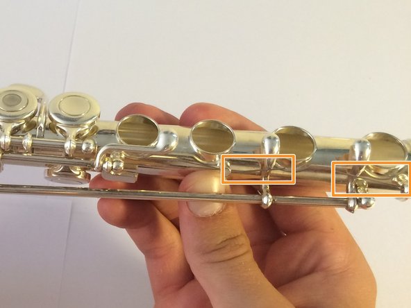

    • Do not grab the body of the flute by its keys when removing it from the case.
    • Instead, grasp it by the tenon section, where you won't put stress on the springs.
    • Remove the head piece in a similar fashion.
    • Avoid contact with the nickel-silver portion of the tenon when holding the head piece. The sweat from your skin leaves behind acids that can eventually corrode it.
    • Also, don't grab the head piece by its lip plate. If you are wearing a ring, you could scratch the embouchure hole.
    • It is okay to grab the foot joint by the bottom two keys (the ones connected to the B and C rollers).

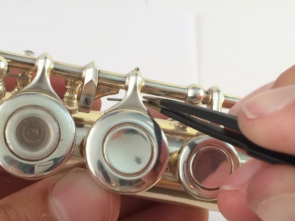

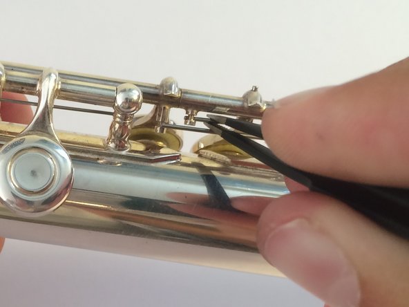

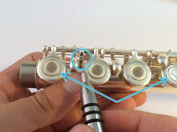

  3. Repairing Flute Felt Key Pads, Identifying the Misaligned Keys: crwdns2935265:03crwdnd2935265:01crwdnd2935265:03crwdne2935265:0 Repairing Flute Felt Key Pads, Identifying the Misaligned Keys: crwdns2935265:03crwdnd2935265:02crwdnd2935265:03crwdne2935265:0 Repairing Flute Felt Key Pads, Identifying the Misaligned Keys: crwdns2935265:03crwdnd2935265:03crwdnd2935265:03crwdne2935265:0
    • Use tweezers to hold the rolling paper.
    • Press the key lightly on the paper and pull outward.
    • Try this at eight different angles from the center of the key.
    • If the felt pad is making proper contact, you should feel a drag. If you feel that there is little or no drag, then you have identified the key that needs to be repaired.
    • Hopefully, there is only one side of the key that has this issue. Otherwise, you may need a new felt pad.

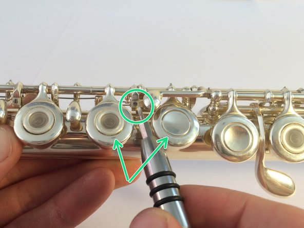

  4. Repairing Flute Felt Key Pads, Place Holding the Repair: crwdns2935265:04crwdnd2935265:01crwdnd2935265:01crwdne2935265:0
    • Mark the felt pad and the metal next to it where you felt little or no contact.
    • This step is important! We will use this later as a reference for the fix.

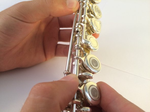

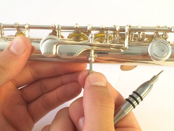

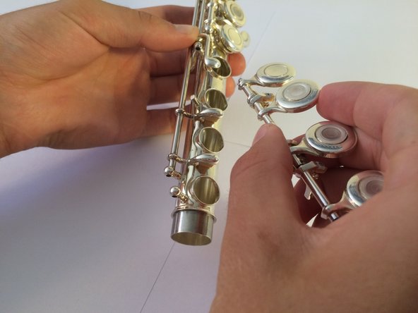

  5. Repairing Flute Felt Key Pads, Removing Keys from the Body: crwdns2935265:05crwdnd2935265:01crwdnd2935265:02crwdne2935265:0 Repairing Flute Felt Key Pads, Removing Keys from the Body: crwdns2935265:05crwdnd2935265:02crwdnd2935265:02crwdne2935265:0
    • Remove the screw connected to the F, E, and D keys.
    • Keep track of which screw goes where for when you reassemble it.
  6. Repairing Flute Felt Key Pads: crwdns2935265:06crwdnd2935265:01crwdnd2935265:02crwdne2935265:0 Repairing Flute Felt Key Pads: crwdns2935265:06crwdnd2935265:02crwdnd2935265:02crwdne2935265:0
    • Repeat this step for the rail below the first one.
    • The keys will become lose and the rails will become misaligned. Relax, this is supposed to happen!
  7. Repairing Flute Felt Key Pads: crwdns2935265:07crwdnd2935265:01crwdnd2935265:02crwdne2935265:0 Repairing Flute Felt Key Pads: crwdns2935265:07crwdnd2935265:02crwdnd2935265:02crwdne2935265:0
    • On the other side of the flute, remove the screw connected to the same rail from the previous step.
    • That rail should be free when you loosen the screw.

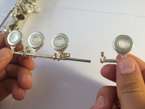

  8. Repairing Flute Felt Key Pads: crwdns2935265:08crwdnd2935265:01crwdnd2935265:03crwdne2935265:0 Repairing Flute Felt Key Pads: crwdns2935265:08crwdnd2935265:02crwdnd2935265:03crwdne2935265:0 Repairing Flute Felt Key Pads: crwdns2935265:08crwdnd2935265:03crwdnd2935265:03crwdne2935265:0
    • Remove the rail that has the F, E, and D keys.
    • The long rail can budge to the left enough for the shorter rail to slip out.
  9. Repairing Flute Felt Key Pads: crwdns2935265:09crwdnd2935265:01crwdnd2935265:02crwdne2935265:0 Repairing Flute Felt Key Pads: crwdns2935265:09crwdnd2935265:02crwdnd2935265:02crwdne2935265:0
    • The D key should be free to slide from the rail. Be sure not to lose it!

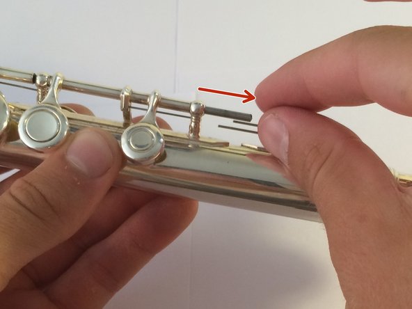

    • Push the rail out of the small groove.
    • Weave the two trill keys (D and D#) out from underneath the springs.
    • It's OKAY if they bend.

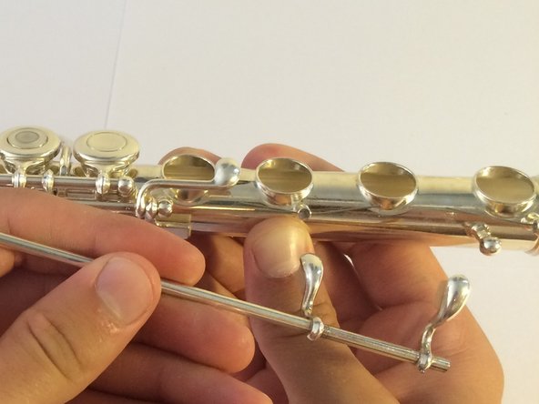

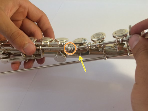

  12. Repairing Flute Felt Key Pads: crwdns2935265:012crwdnd2935265:01crwdnd2935265:03crwdne2935265:0 Repairing Flute Felt Key Pads: crwdns2935265:012crwdnd2935265:02crwdnd2935265:03crwdne2935265:0 Repairing Flute Felt Key Pads: crwdns2935265:012crwdnd2935265:03crwdnd2935265:03crwdne2935265:0
    • Next, loosen the screw connected to the C, B flat, and A keys. This screw is actually a rod. Pull this rod out using your fingers.
  13. Repairing Flute Felt Key Pads: crwdns2935265:013crwdnd2935265:01crwdnd2935265:03crwdne2935265:0 Repairing Flute Felt Key Pads: crwdns2935265:013crwdnd2935265:02crwdnd2935265:03crwdne2935265:0 Repairing Flute Felt Key Pads: crwdns2935265:013crwdnd2935265:03crwdnd2935265:03crwdne2935265:0
    • Remove the C key. This will make the next steps easier to complete .
    • On the same rail, remove the rest of the keys (B flat and G).
    • There should be a point where it connects. Just pop it out and remove the rail.

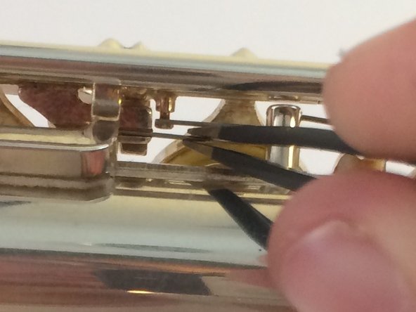

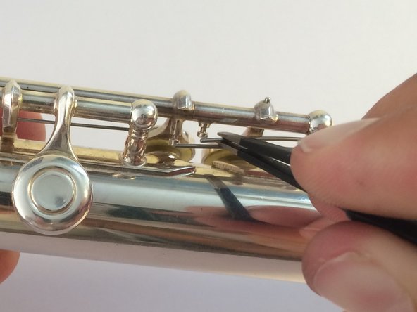

    • The next step is to loosen the screw that holds the inline G keys.
    • Same drill: pull out the rod that holds it together.
    • There are a few rods involved in this disassembly. To avoid confusion, place them aside in an order that will remind you how to put them back.
  15. Repairing Flute Felt Key Pads: crwdns2935265:015crwdnd2935265:01crwdnd2935265:03crwdne2935265:0 Repairing Flute Felt Key Pads: crwdns2935265:015crwdnd2935265:02crwdnd2935265:03crwdne2935265:0 Repairing Flute Felt Key Pads: crwdns2935265:015crwdnd2935265:03crwdnd2935265:03crwdne2935265:0

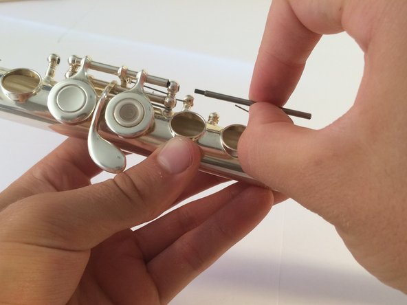

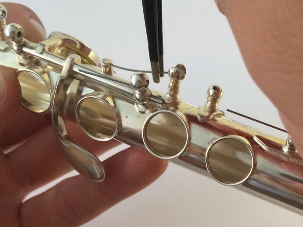

    • To make the removal of the inline G keys easier, use tweezers to move the spring out of position.
    • The spring will hang loose for now.

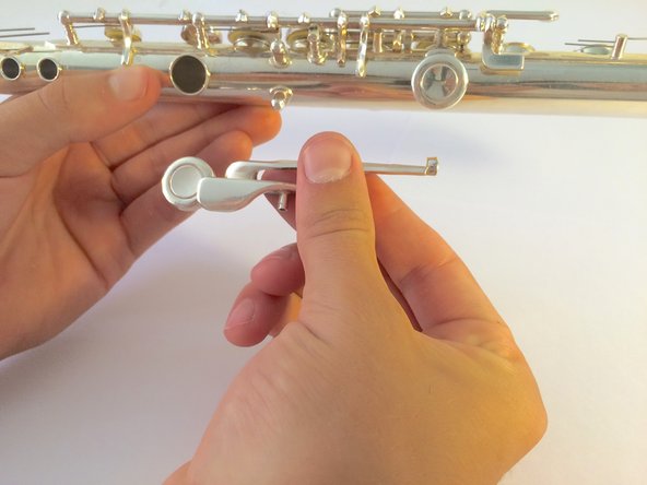

  16. Repairing Flute Felt Key Pads: crwdns2935265:016crwdnd2935265:01crwdnd2935265:02crwdne2935265:0 Repairing Flute Felt Key Pads: crwdns2935265:016crwdnd2935265:02crwdnd2935265:02crwdne2935265:0
    • The inline G keys should come out easily.
    • Now, loosen the rod connected to the G# lever.
  17. Repairing Flute Felt Key Pads: crwdns2935265:017crwdnd2935265:01crwdnd2935265:02crwdne2935265:0 Repairing Flute Felt Key Pads: crwdns2935265:017crwdnd2935265:02crwdnd2935265:02crwdne2935265:0
    • This is the most difficult rod to remove, so to make it a little easier on yourself, get the spring out of the way by moving it up into the groove.
    • Don't worry about bending the spring too much. If it loses it's original tension, it can be easily be corrected by stretching it in the opposite direction.
  18. Repairing Flute Felt Key Pads: crwdns2935265:018crwdnd2935265:01crwdnd2935265:02crwdne2935265:0 Repairing Flute Felt Key Pads: crwdns2935265:018crwdnd2935265:02crwdnd2935265:02crwdne2935265:0
    • Be careful when removing this rod! The spring opposing your direction of motion means business! You can use your free hand to hold it out of the way if necessary.
    • Carefully slide the rod out.

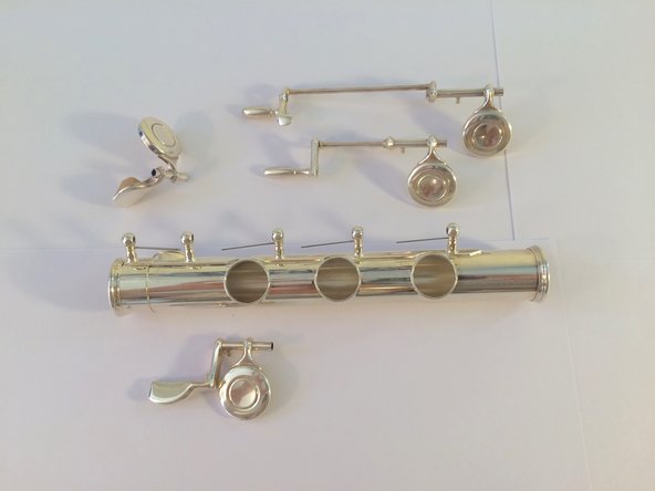

  19. Repairing Flute Felt Key Pads: crwdns2935265:019crwdnd2935265:01crwdnd2935265:02crwdne2935265:0 Repairing Flute Felt Key Pads: crwdns2935265:019crwdnd2935265:02crwdnd2935265:02crwdne2935265:0
    • The G# lever should come out easily.
    • This is the last key to be removed from the body.

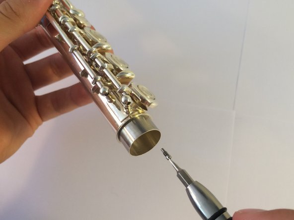

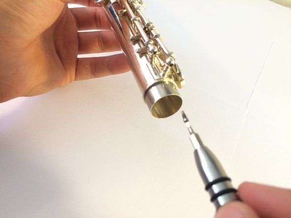

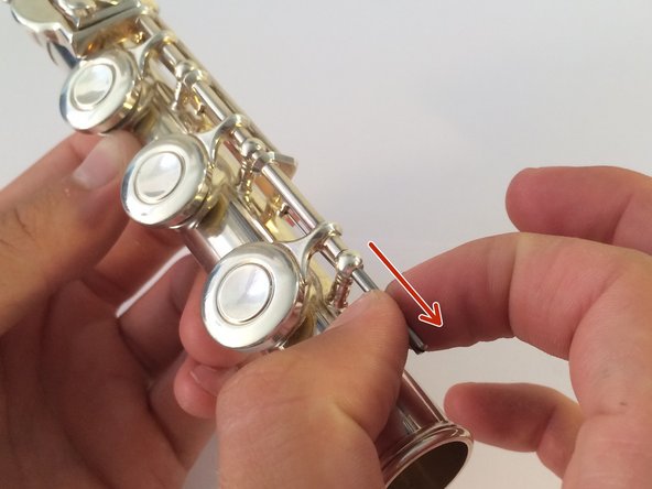

  20. Repairing Flute Felt Key Pads, Removing Keys from the Foot Joint: crwdns2935265:020crwdnd2935265:01crwdnd2935265:03crwdne2935265:0 Repairing Flute Felt Key Pads, Removing Keys from the Foot Joint: crwdns2935265:020crwdnd2935265:02crwdnd2935265:03crwdne2935265:0 Repairing Flute Felt Key Pads, Removing Keys from the Foot Joint: crwdns2935265:020crwdnd2935265:03crwdnd2935265:03crwdne2935265:0

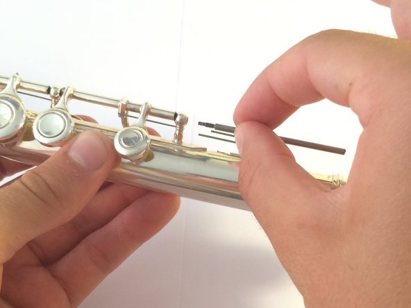

    • Disassembling the foot joint is simple. Loosen the screw at the end of the rail and pull out the long rod holding it all together.
    • This is by far the longest rod in the flute!
  21. Repairing Flute Felt Key Pads: crwdns2935265:021crwdnd2935265:01crwdnd2935265:02crwdne2935265:0 Repairing Flute Felt Key Pads: crwdns2935265:021crwdnd2935265:02crwdnd2935265:02crwdne2935265:0
    • When you pull out the rod, everything will fall apart. This is okay, it is what is supposed to happen. Just be sure not to lose any parts in the process!

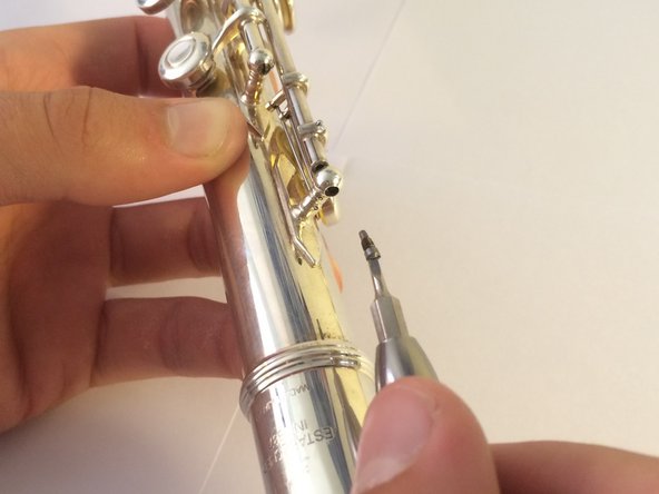

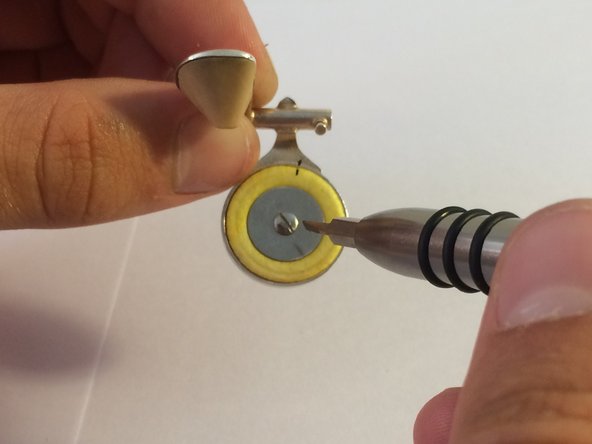

  22. Repairing Flute Felt Key Pads, Repairing the Finger Key: crwdns2935265:022crwdnd2935265:01crwdnd2935265:03crwdne2935265:0 Repairing Flute Felt Key Pads, Repairing the Finger Key: crwdns2935265:022crwdnd2935265:02crwdnd2935265:03crwdne2935265:0 Repairing Flute Felt Key Pads, Repairing the Finger Key: crwdns2935265:022crwdnd2935265:03crwdnd2935265:03crwdne2935265:0
    • Once you've been able to remove the malfunctioning finger key, it is time to take it apart.
    • Be careful removing the screw, it is tiny, as well as nonmagnetic. It is very easy to lose!

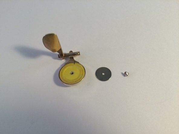

  23. Repairing Flute Felt Key Pads: crwdns2935265:023crwdnd2935265:01crwdnd2935265:02crwdne2935265:0 Repairing Flute Felt Key Pads: crwdns2935265:023crwdnd2935265:02crwdnd2935265:02crwdne2935265:0
    • Using the screwdriver, gently lift the pad out of the cup.
    • Behind the pad there will most likely be a couple paper shims that were placed there previously.
    • The items laid out left to right go in the cup from bottom to top, respectively.

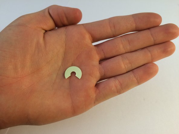

  24. Repairing Flute Felt Key Pads: crwdns2935265:024crwdnd2935265:01crwdnd2935265:03crwdne2935265:0 Repairing Flute Felt Key Pads: crwdns2935265:024crwdnd2935265:02crwdnd2935265:03crwdne2935265:0 Repairing Flute Felt Key Pads: crwdns2935265:024crwdnd2935265:03crwdnd2935265:03crwdne2935265:0

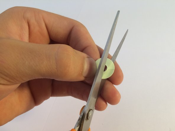

    • The amount of additional paper shims you may need ultimately depends on the condition of the repair.
    • Using scissors, cut out about a third of a new paper shim.
  25. Repairing Flute Felt Key Pads: crwdns2935265:025crwdnd2935265:01crwdnd2935265:03crwdne2935265:0 Repairing Flute Felt Key Pads: crwdns2935265:025crwdnd2935265:02crwdnd2935265:03crwdne2935265:0 Repairing Flute Felt Key Pads: crwdns2935265:025crwdnd2935265:03crwdnd2935265:03crwdne2935265:0
    • Place the cut paper shim back into the cup after the supporting, whole shims. You may need to place more than one cut paper shim if the misalignment is more severe.
    • Important: Be sure that the orientation of the cut shim aligns with the mark made on the metal of the cup.

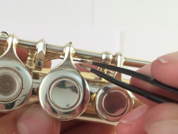

    • After putting back the inline G keys, make sure to put back the spring behind the peg.
    • This is the only spring you removed during disassembly.
  31. Repairing Flute Felt Key Pads: crwdns2935265:031crwdnd2935265:01crwdnd2935265:02crwdne2935265:0 Repairing Flute Felt Key Pads: crwdns2935265:031crwdnd2935265:02crwdnd2935265:02crwdne2935265:0
    • This is the spring by the C key.
    • Notice that the spring is in front of the metal groove.
    • Use the tweezers to put the spring behind it and in the groove.

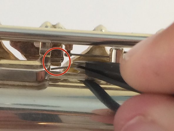

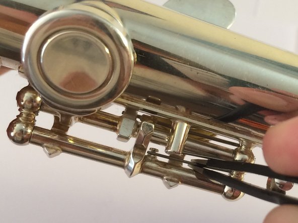

  32. Repairing Flute Felt Key Pads: crwdns2935265:032crwdnd2935265:01crwdnd2935265:03crwdne2935265:0 Repairing Flute Felt Key Pads: crwdns2935265:032crwdnd2935265:02crwdnd2935265:03crwdne2935265:0 Repairing Flute Felt Key Pads: crwdns2935265:032crwdnd2935265:03crwdnd2935265:03crwdne2935265:0
    • This is the spring of the B flat key (next to the C key).
    • Again, this spring needs to go behind the small plate, into a little slot.
  33. Repairing Flute Felt Key Pads: crwdns2935265:033crwdnd2935265:01crwdnd2935265:01crwdne2935265:0
    • This spring needs to be put back behind its peg.
    • For reference, that plate with the spring in its groove is the spring that was fixed in the previous step.

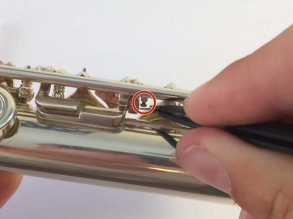

  34. Repairing Flute Felt Key Pads: crwdns2935265:034crwdnd2935265:01crwdnd2935265:02crwdne2935265:0 Repairing Flute Felt Key Pads: crwdns2935265:034crwdnd2935265:02crwdnd2935265:02crwdne2935265:0
    • If you did not remove the B tab, skip this step.
    • Align the two separate tabs so that the rod fits back through.
    • Make sure that the tip at the end of the skinny tab returns under its corresponding strip of metal.
  35. Repairing Flute Felt Key Pads: crwdns2935265:035crwdnd2935265:01crwdnd2935265:02crwdne2935265:0 Repairing Flute Felt Key Pads: crwdns2935265:035crwdnd2935265:02crwdnd2935265:02crwdne2935265:0
    • In order for the reassembly to work for this piece, remember to put the trill keys under the corresponding springs.
    • Make sure the rail is rejoined at that point.
    • That tab fits behind the one fixed there.
  36. Repairing Flute Felt Key Pads: crwdns2935265:036crwdnd2935265:01crwdnd2935265:03crwdne2935265:0 Repairing Flute Felt Key Pads: crwdns2935265:036crwdnd2935265:02crwdnd2935265:03crwdne2935265:0 Repairing Flute Felt Key Pads: crwdns2935265:036crwdnd2935265:03crwdnd2935265:03crwdne2935265:0
    • After putting the screws back, fix the springs that connect to the trill keys.
    • It will be easier if you do the top one first.
  37. Repairing Flute Felt Key Pads: crwdns2935265:037crwdnd2935265:01crwdnd2935265:02crwdne2935265:0 Repairing Flute Felt Key Pads: crwdns2935265:037crwdnd2935265:02crwdnd2935265:02crwdne2935265:0
    • These are the springs behind the F and E finger keys.
    • The top spring goes behind the peg.

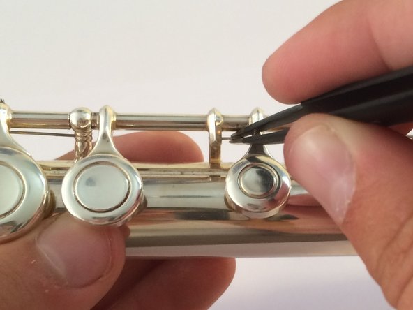

  38. Repairing Flute Felt Key Pads: crwdns2935265:038crwdnd2935265:01crwdnd2935265:03crwdne2935265:0 Repairing Flute Felt Key Pads: crwdns2935265:038crwdnd2935265:02crwdnd2935265:03crwdne2935265:0 Repairing Flute Felt Key Pads: crwdns2935265:038crwdnd2935265:03crwdnd2935265:03crwdne2935265:0
    • The bottom spring goes behind the small plate in a groove.
  39. Repairing Flute Felt Key Pads: crwdns2935265:039crwdnd2935265:01crwdnd2935265:03crwdne2935265:0 Repairing Flute Felt Key Pads: crwdns2935265:039crwdnd2935265:02crwdnd2935265:03crwdne2935265:0 Repairing Flute Felt Key Pads: crwdns2935265:039crwdnd2935265:03crwdnd2935265:03crwdne2935265:0
    • This spring between the F and E keys isn't hard to reach. Fit it in the small groove.
    • The spring between the E and D keys goes behind a small peg.

    • When putting your flute back together, some keys may seem either too easy or to hard to press. This is related to the tightness of the screws in the rails, as well as small screws between finger keys that have not yet been mentioned.
    • The tighter the screw, the more finger keys that will resist being closed.
    • To adjust the G# lever, change the tightness in the corresponding screw in the railing.
    • To adjust the inline G keys, play with the screw in the attached rail on top of the G# lever railing.
    • The B tab on the other side of the flute is also adjusted in this fashion.
    • This screw, as well as the next two screws in this step, do not hold anything together. They act as modifiers that adjust the synchronization of connected keys not attached to a rod backbone.
    • This alters the F and F# pair.
    • This screw changes the coordination of the D and F# keys.
  41. Repairing Flute Felt Key Pads, Fixing Sticky Keys: crwdns2935265:041crwdnd2935265:01crwdnd2935265:03crwdne2935265:0 Repairing Flute Felt Key Pads, Fixing Sticky Keys: crwdns2935265:041crwdnd2935265:02crwdnd2935265:03crwdne2935265:0 Repairing Flute Felt Key Pads, Fixing Sticky Keys: crwdns2935265:041crwdnd2935265:03crwdnd2935265:03crwdne2935265:0
    • When practicing the flute for a good amount of time, finger keys often get sticky. This can affect the time it takes for the pressed key to return to its original open position, something fast playing musicians can't afford.
    • Put an oil absorbing sheet under the sticky key and lightly press down on the sheet.
    • Release and gently remove the sheet.
    • DO NOT pull the sheet out like the rolling paper. This could lead to misalignment of the felt pad.
    • When cleaning the silver plating on the flute, do not wipe underneath the keys. Similarly, this could also lead to damage of the felt pads.
    • You'd be amazed by the amount of grime you might find trapped in the keys. Oil absorbing sheets work best to get the moisture out of the keys, in addition to the grime.
    • Dollar bills also can work, but not everyone has that kind of money.

    • In the case that you are missing a felt pad entirely (just a bare cup), you can still fix your flute temporarily.
    • Cut a small strip of teflon tape (about 4" )
    • Holding both ends, slip the tape under the key with the missing felt pad. It's quite the surgery, but manageable.
    • Make sure the part where the key makes contact with the body is fully covered.
    • With the remaining tape, twist it together at the top to hold it in place.
    • This is a temporary fix, but works perfectly.
