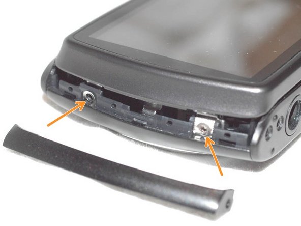

  3. Repairing Casio Exilim EX-Z350 Lens mechanics, Remove clip cover: crwdns2935265:03crwdnd2935265:01crwdnd2935265:02crwdne2935265:0 Repairing Casio Exilim EX-Z350 Lens mechanics, Remove clip cover: crwdns2935265:03crwdnd2935265:02crwdnd2935265:02crwdne2935265:0
    • With screwdriver remove the cover that hides more screws
    • Remove two additional screws.
    • On the picture, the previous owner hasn´t removed the screws but openend the camera nevertheless

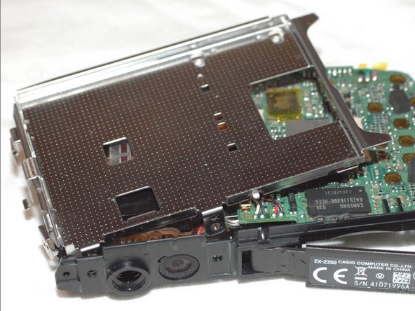

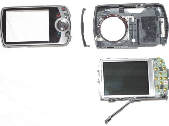

  4. Repairing Casio Exilim EX-Z350 Lens mechanics, Remove rear cover: crwdns2935265:04crwdnd2935265:01crwdnd2935265:03crwdne2935265:0 Repairing Casio Exilim EX-Z350 Lens mechanics, Remove rear cover: crwdns2935265:04crwdnd2935265:02crwdnd2935265:03crwdne2935265:0 Repairing Casio Exilim EX-Z350 Lens mechanics, Remove rear cover: crwdns2935265:04crwdnd2935265:03crwdnd2935265:03crwdne2935265:0
    • Carefully lift rear cover with a spudger. Start with bottom side first, then top side.

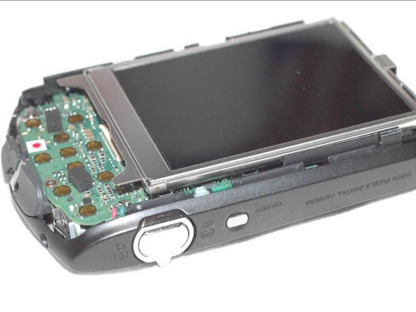

  5. Repairing Casio Exilim EX-Z350 Lens mechanics, Remove camera from front housing: crwdns2935265:05crwdnd2935265:01crwdnd2935265:03crwdne2935265:0 Repairing Casio Exilim EX-Z350 Lens mechanics, Remove camera from front housing: crwdns2935265:05crwdnd2935265:02crwdnd2935265:03crwdne2935265:0 Repairing Casio Exilim EX-Z350 Lens mechanics, Remove camera from front housing: crwdns2935265:05crwdnd2935265:03crwdnd2935265:03crwdne2935265:0
    • Insert spudger as shown to lift camera out of case on bottom area around the tripod thread first
    • Once the bottom part is out, its easy to carefully pull out the camera
    • Parts separated so far on last picture

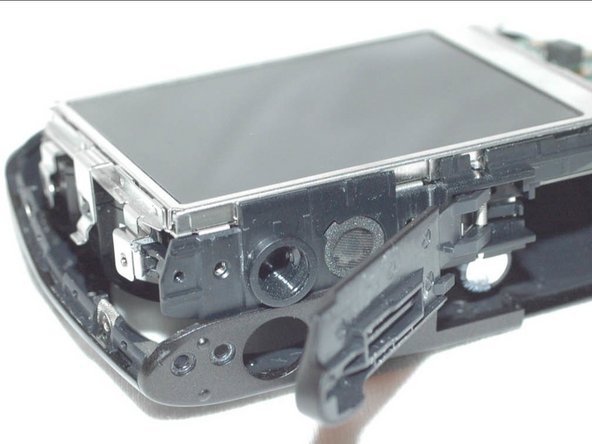

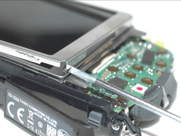

  6. Repairing Casio Exilim EX-Z350 Lens mechanics, Remove display frame: crwdns2935265:06crwdnd2935265:01crwdnd2935265:03crwdne2935265:0 Repairing Casio Exilim EX-Z350 Lens mechanics, Remove display frame: crwdns2935265:06crwdnd2935265:02crwdnd2935265:03crwdne2935265:0 Repairing Casio Exilim EX-Z350 Lens mechanics, Remove display frame: crwdns2935265:06crwdnd2935265:03crwdnd2935265:03crwdne2935265:0

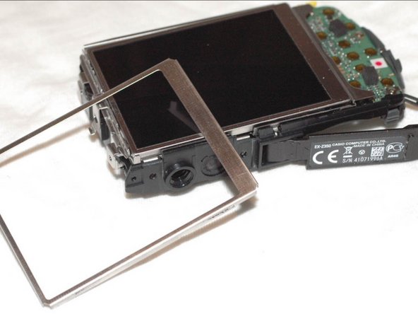

    • With fine tip screwdriver lift metal frame that holds LCD display on one corner.
    • Carefully continue on other corner until metal frame snaps out

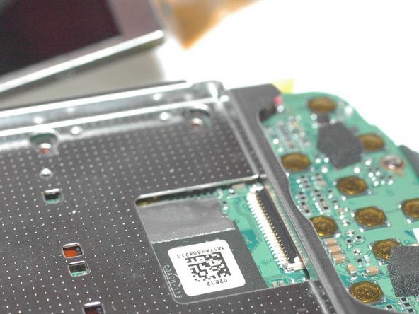

  7. Repairing Casio Exilim EX-Z350 Lens mechanics, Unclip LCD display: crwdns2935265:07crwdnd2935265:01crwdnd2935265:03crwdne2935265:0 Repairing Casio Exilim EX-Z350 Lens mechanics, Unclip LCD display: crwdns2935265:07crwdnd2935265:02crwdnd2935265:03crwdne2935265:0 Repairing Casio Exilim EX-Z350 Lens mechanics, Unclip LCD display: crwdns2935265:07crwdnd2935265:03crwdnd2935265:03crwdne2935265:0

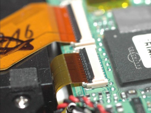

    • To release the LCD ribbon cable lift the tiny black bar carefully with a fla blade screwdriver or spudger
    • Second pic shows open connector
    • Front shot of the camera

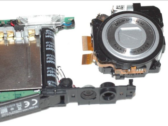

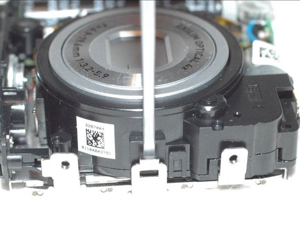

  8. Repairing Casio Exilim EX-Z350 Lens mechanics, Remove metal frame bracket (1): crwdns2935265:08crwdnd2935265:01crwdnd2935265:03crwdne2935265:0 Repairing Casio Exilim EX-Z350 Lens mechanics, Remove metal frame bracket (1): crwdns2935265:08crwdnd2935265:02crwdnd2935265:03crwdne2935265:0 Repairing Casio Exilim EX-Z350 Lens mechanics, Remove metal frame bracket (1): crwdns2935265:08crwdnd2935265:03crwdnd2935265:03crwdne2935265:0
    • Remove the two screws shown in first picture

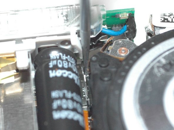

    • Unhook the first easy to access clip on the side of the lens body
    • Unhook the second more obstructed hook. Be careful not to touch the capacitor's connectors (black round thingy), it might still be charged.
    • If the two hooks are unhooked, the lens body can be lifted upwards.

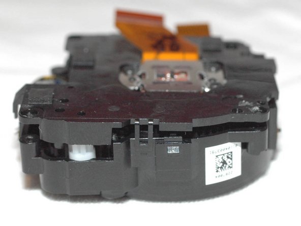

  10. Repairing Casio Exilim EX-Z350 Lens mechanics, Remove lens body ribbon cable: crwdns2935265:010crwdnd2935265:01crwdnd2935265:03crwdne2935265:0 Repairing Casio Exilim EX-Z350 Lens mechanics, Remove lens body ribbon cable: crwdns2935265:010crwdnd2935265:02crwdnd2935265:03crwdne2935265:0 Repairing Casio Exilim EX-Z350 Lens mechanics, Remove lens body ribbon cable: crwdns2935265:010crwdnd2935265:03crwdnd2935265:03crwdne2935265:0
    • As before, carefully lift the two black flaps of the camera sensor and lens connectors
    • Second picture shows flap up
    • The lens body (and sensor) are removed

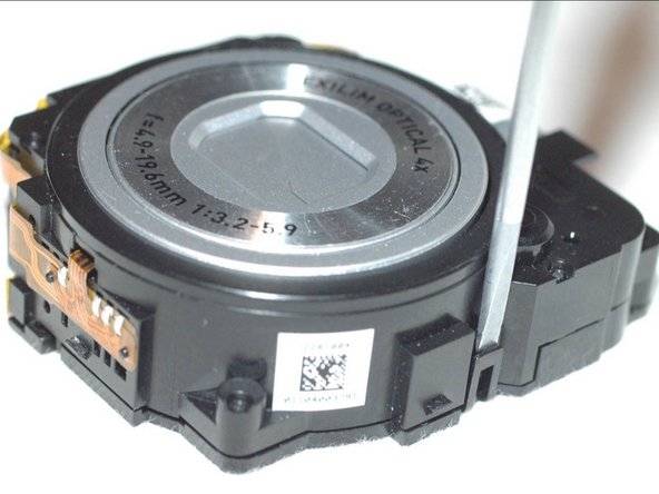

  11. Repairing Casio Exilim EX-Z350 Lens mechanics, Open lens / sensor assembly: crwdns2935265:011crwdnd2935265:01crwdnd2935265:03crwdne2935265:0 Repairing Casio Exilim EX-Z350 Lens mechanics, Open lens / sensor assembly: crwdns2935265:011crwdnd2935265:02crwdnd2935265:03crwdne2935265:0 Repairing Casio Exilim EX-Z350 Lens mechanics, Open lens / sensor assembly: crwdns2935265:011crwdnd2935265:03crwdnd2935265:03crwdne2935265:0
    • Remove four phillips screws, one is hidden under a small cover
    • Unhook one clip
    • Place the lens facing down before continuing.
    • Carefully pry the box open as shown. The top part is the sensor, so once open do try to keep it clean.

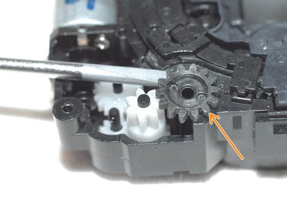

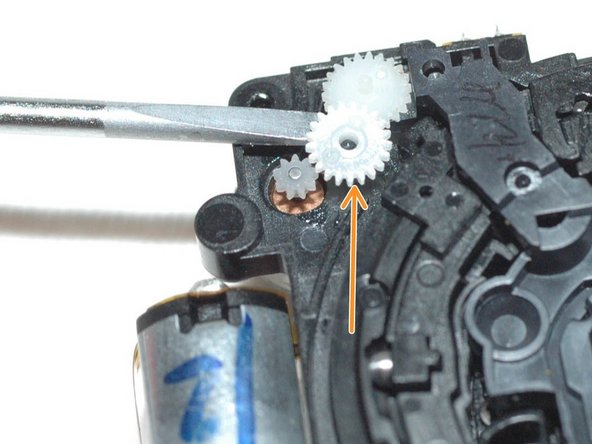

  12. Repairing Casio Exilim EX-Z350 Lens mechanics, Disassemble lens (1): crwdns2935265:012crwdnd2935265:01crwdnd2935265:03crwdne2935265:0 Repairing Casio Exilim EX-Z350 Lens mechanics, Disassemble lens (1): crwdns2935265:012crwdnd2935265:02crwdnd2935265:03crwdne2935265:0 Repairing Casio Exilim EX-Z350 Lens mechanics, Disassemble lens (1): crwdns2935265:012crwdnd2935265:03crwdnd2935265:03crwdne2935265:0
    • First a picture of the sensor and the rest

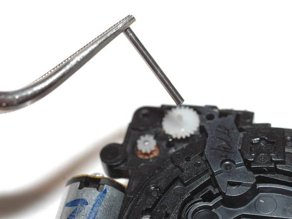

    • Now remove two small gears as shown

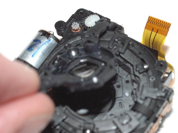

  13. Repairing Casio Exilim EX-Z350 Lens mechanics, Disassemble lens (2): crwdns2935265:013crwdnd2935265:01crwdnd2935265:03crwdne2935265:0 Repairing Casio Exilim EX-Z350 Lens mechanics, Disassemble lens (2): crwdns2935265:013crwdnd2935265:02crwdnd2935265:03crwdne2935265:0 Repairing Casio Exilim EX-Z350 Lens mechanics, Disassemble lens (2): crwdns2935265:013crwdnd2935265:03crwdnd2935265:03crwdne2935265:0
    • Remove small axis with a pair of good pliers. The axis needs to be removed as otherwise the zoom lens will not come off easily
    • Last picture shows the assembly with zoom lens still on.

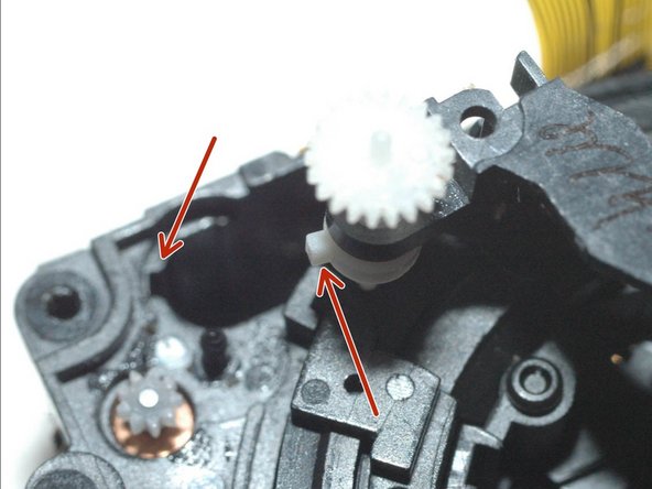

    • When lifting the zoom lens, the stabilizer lens will swing up. Remember this upon assembly, as you will have to move it back (down) again

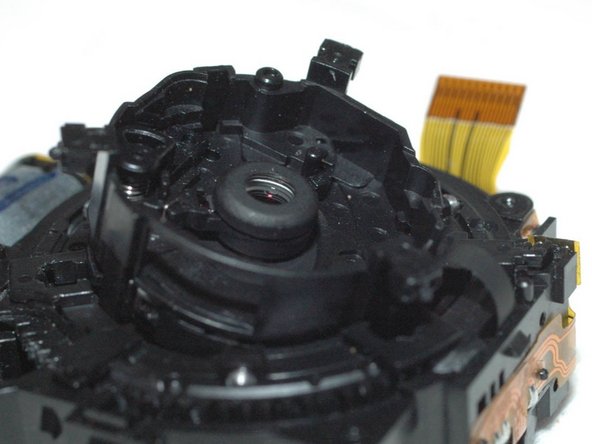

  14. Repairing Casio Exilim EX-Z350 Lens mechanics, Disassemble lens (3): crwdns2935265:014crwdnd2935265:01crwdnd2935265:03crwdne2935265:0 Repairing Casio Exilim EX-Z350 Lens mechanics, Disassemble lens (3): crwdns2935265:014crwdnd2935265:02crwdnd2935265:03crwdne2935265:0 Repairing Casio Exilim EX-Z350 Lens mechanics, Disassemble lens (3): crwdns2935265:014crwdnd2935265:03crwdnd2935265:03crwdne2935265:0
    • Here´s the stabilizer lens visible
    • Lift the zoom lens as shown
    • The small gear has a notch in the housing that the nose must be fitted back in upon assembly

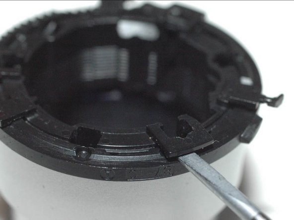

  15. Repairing Casio Exilim EX-Z350 Lens mechanics, Disassemble lens (4): crwdns2935265:015crwdnd2935265:01crwdnd2935265:03crwdne2935265:0 Repairing Casio Exilim EX-Z350 Lens mechanics, Disassemble lens (4): crwdns2935265:015crwdnd2935265:02crwdnd2935265:03crwdne2935265:0 Repairing Casio Exilim EX-Z350 Lens mechanics, Disassemble lens (4): crwdns2935265:015crwdnd2935265:03crwdnd2935265:03crwdne2935265:0

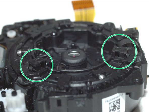

    • The stabilizer lens (or what I call it, it might be the focus after all) is kept in place with three clips.
    • Red arrow shows direction in which stabilizer lens must be moved upon assembly
    • Unhook all three and the little noses come out of their holder
    • Carefully pull out the inner lens body.
    • Do not pull as it is connected with a tiny ribbon wire

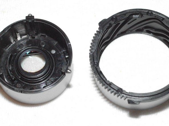

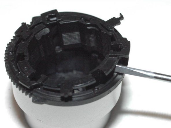

  16. Repairing Casio Exilim EX-Z350 Lens mechanics, Disassemble lens (5): crwdns2935265:016crwdnd2935265:01crwdnd2935265:03crwdne2935265:0 Repairing Casio Exilim EX-Z350 Lens mechanics, Disassemble lens (5): crwdns2935265:016crwdnd2935265:02crwdnd2935265:03crwdne2935265:0 Repairing Casio Exilim EX-Z350 Lens mechanics, Disassemble lens (5): crwdns2935265:016crwdnd2935265:03crwdnd2935265:03crwdne2935265:0
    • Lift the lens barrel out by pushing slightly from the front
    • Unhook the inner control ring as shown. The spudger needs almost no force and the ring springs out
    • The inner ring can be lifted out. It has three guides with different shape, so fitting back in is possible without a marking
  17. Repairing Casio Exilim EX-Z350 Lens mechanics, Disassemble lens (6): crwdns2935265:017crwdnd2935265:01crwdnd2935265:03crwdne2935265:0 Repairing Casio Exilim EX-Z350 Lens mechanics, Disassemble lens (6): crwdns2935265:017crwdnd2935265:02crwdnd2935265:03crwdne2935265:0 Repairing Casio Exilim EX-Z350 Lens mechanics, Disassemble lens (6): crwdns2935265:017crwdnd2935265:03crwdnd2935265:03crwdne2935265:0
    • Now the last two parts can be separated.
    • Rotate the parts carefully against each other until the three metal noses move out of their guidance rails.

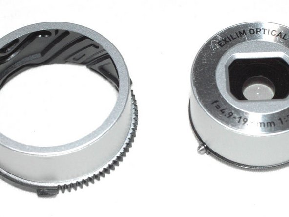

  18. Repairing Casio Exilim EX-Z350 Lens mechanics, Done: crwdns2935265:018crwdnd2935265:01crwdnd2935265:01crwdne2935265:0
    • Here´s a overview of all the parts we´ve got.
