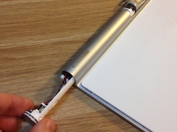

  3. Repairing Apple Wireless Keyboard without destroying it., Removing the Logic Board: crwdns2935265:03crwdnd2935265:01crwdnd2935265:03crwdne2935265:0 Repairing Apple Wireless Keyboard without destroying it., Removing the Logic Board: crwdns2935265:03crwdnd2935265:02crwdnd2935265:03crwdne2935265:0 Repairing Apple Wireless Keyboard without destroying it., Removing the Logic Board: crwdns2935265:03crwdnd2935265:03crwdnd2935265:03crwdne2935265:0
    • With care, rotate the logic board assembly anti-clockwise (looking at the power button) until the circuit board is ~90° from it's starting position and now facing up.
    • Slide the assembly out of the keyboard through the end with the power button. If you encounter resistance try rotating the board slightly more or less until it slides out with ease.
    • Take care to hold the delicate ribbon cable out of the way while doing this to avoid accidentally tearing it.

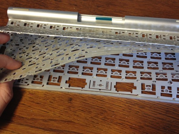

  7. Repairing Apple Wireless Keyboard without destroying it., Removing the aluminium 'foil' plate.: crwdns2935265:07crwdnd2935265:01crwdnd2935265:01crwdne2935265:0
    • Make certain you have drilled out every weld, then begin to pry the edges of the plate up. It is extremely thin and you will not be able to remove it without bending it slightly. Don't worry, that can be fixed later.
    • If you encounter a weld that is still stuck, stop, and re-drill it. Again don't rush or be tempted to pull and bend the plate.

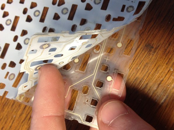

  9. Repairing Apple Wireless Keyboard without destroying it., Locating the fault: crwdns2935265:09crwdnd2935265:01crwdnd2935265:03crwdne2935265:0 Repairing Apple Wireless Keyboard without destroying it., Locating the fault: crwdns2935265:09crwdnd2935265:02crwdnd2935265:03crwdne2935265:0 Repairing Apple Wireless Keyboard without destroying it., Locating the fault: crwdns2935265:09crwdnd2935265:03crwdnd2935265:03crwdne2935265:0
    • The membrane is composed of two thin layers of plastic that are - guess what...glued together. They are very difficult to separate and patience is key.
    • Use a thin blade to separate the layers at a corner (it helps to start at the corner closest to the faulty keys) and very slowly peel the layers apart. You probably won't need to separate them all the way, just enough to expose the region of the defective key should do.

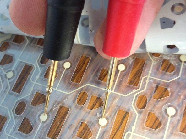

    • On the inside you'll find a mess of white lines and dots. These are the conductive traces. Track down the two pads that align under the key(s) you are having problems with.
    • With your multimeter, set to measure continuity, check there are no breaks in the tracks between the pad in question and it's neighbours. You can follow the lines to see which ones should be electrically connected. Some areas are coated in plastic, so you'll have to work around them.
    • Try to find the exact point where the track is broken, and make a note of where it is. A page marker is great for this.
    • If there are any obviously discoloured/oxidised areas on the pads, even if there are no breaks in the line feeding it, this may be the issue. Touch these areas up to in the next step.
