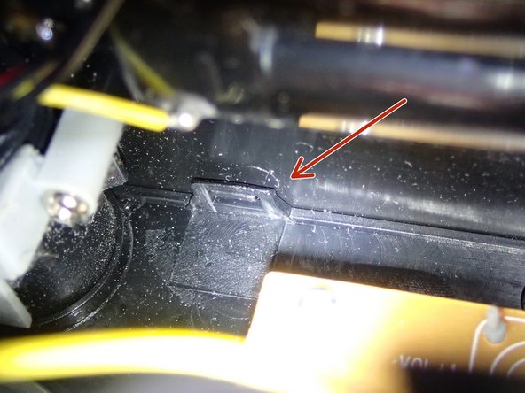

    • After removing the 2 screws on the bottom, carefully open the bottom frame, see location of the plastic snaps snaps

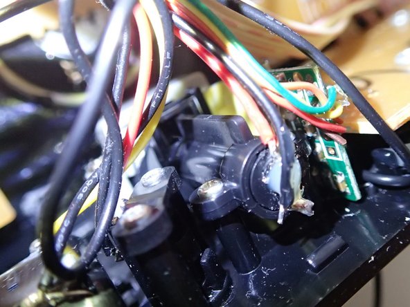

    • Removes the back panel, taking care of the other plastic snaps
    • The projector and its optics is shown in the blue square
  4. Repairing Alarm Clock Clock Projector, The optics: crwdns2935265:04crwdnd2935265:01crwdnd2935265:03crwdne2935265:0 Repairing Alarm Clock Clock Projector, The optics: crwdns2935265:04crwdnd2935265:02crwdnd2935265:03crwdne2935265:0 Repairing Alarm Clock Clock Projector, The optics: crwdns2935265:04crwdnd2935265:03crwdnd2935265:03crwdne2935265:0

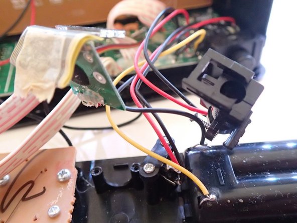

    • cables are tied together with a simple ribbon, in general the inner construction seems very cheap
    • The Projector is made of three parts:
    • A red LED
    • The display with its controller
    • the lens with focus mechanics
    • All parts are kept by tiny screws that you have to remove
    • Take extra caution when handling the display, the flat cable is very weak and can be damaged by improper handling
  5. Repairing Alarm Clock Clock Projector: crwdns2935265:05crwdnd2935265:01crwdnd2935265:03crwdne2935265:0 Repairing Alarm Clock Clock Projector: crwdns2935265:05crwdnd2935265:02crwdnd2935265:03crwdne2935265:0 Repairing Alarm Clock Clock Projector: crwdns2935265:05crwdnd2935265:03crwdnd2935265:03crwdne2935265:0

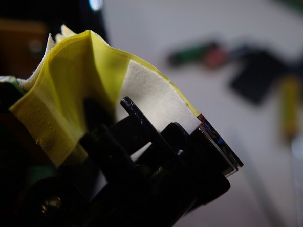

    • Carefully remove display from its supporting frame
    • The issue should be ralated to flat cable connecting display to controller
  6. Repairing Alarm Clock Clock Projector: crwdns2935265:06crwdnd2935265:01crwdnd2935265:03crwdne2935265:0 Repairing Alarm Clock Clock Projector: crwdns2935265:06crwdnd2935265:02crwdnd2935265:03crwdne2935265:0 Repairing Alarm Clock Clock Projector: crwdns2935265:06crwdnd2935265:03crwdnd2935265:03crwdne2935265:0
    • Verify that moving the flat the display returns to work
    • put a stiffner on controller side and close to the display
    • if everything is working, reassemble the clock by doing the steps in reverse order
  7. Repairing Alarm Clock Clock Projector: crwdns2935265:07crwdnd2935265:01crwdnd2935265:01crwdne2935265:0
    • Problem solved.
