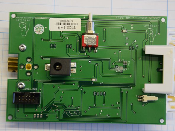

    • Just for information, it is NOT necessary to remove the printed circuit board! There are three connectors: speaker, battery and sensor.

    • Just for information, it is NOT necessary for the repair!

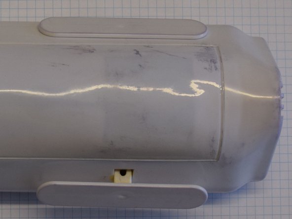

  4. Repair of a cat for therapy: crwdns2935265:04crwdnd2935265:01crwdnd2935265:02crwdne2935265:0 Repair of a cat for therapy: crwdns2935265:04crwdnd2935265:02crwdnd2935265:02crwdne2935265:0
    • Button: pick the membrane and the adhesive stick up, clean with glass fiber brush and some Isopropyl alcohol. Let it dry, reassemble it. Fix it with some tape of Teflon.
    • Test it, you should feel the pressure point with a click.
  5. Repair of a cat for therapy, Secure the membrane with adhesive tape: crwdns2935265:05crwdnd2935265:01crwdnd2935265:03crwdne2935265:0 Repair of a cat for therapy, Secure the membrane with adhesive tape: crwdns2935265:05crwdnd2935265:02crwdnd2935265:03crwdne2935265:0 Repair of a cat for therapy, Secure the membrane with adhesive tape: crwdns2935265:05crwdnd2935265:03crwdnd2935265:03crwdne2935265:0
    • Example of securing with Teflon tape or similar thin adhesive tape.
    • I did not try the following: One could add a coil spring arround the white part of the push button of the case. The Spring could relieve the small button.
