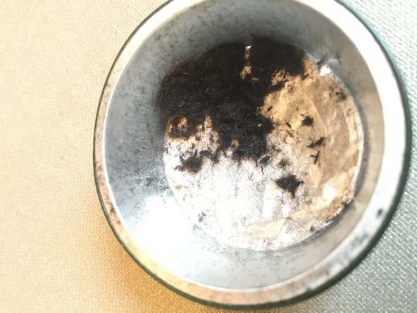

  3. Repair cigarette burn holes in formal suit, Required materials: crwdns2935265:03crwdnd2935265:01crwdnd2935265:02crwdne2935265:0 Repair cigarette burn holes in formal suit, Required materials: crwdns2935265:03crwdnd2935265:02crwdnd2935265:02crwdne2935265:0
    • First image shows the repair tape used. one side looks slightly reflective as it has hot glue on. The suit material had an ironing symbol of medium heat (two dots), but I found using the iron between medium and hot for 30secs was ok. Its worth practising on other material then on an unseen hem first.
    • The second image shows some cut up material taken from the hem. The area of material was about 5 times that of the holes. The material was shredded as finely as possible with scissors.

    • A line was cut between the holes such that a piece of folded repair tape was tucked between the material and its lining. Using tweezers, the tape was unfolded and suitably positioned with the adhesive side up.
    • Then the shredded material was place over the holes. Then a clean medium hot iron was pressed firmly over the holes for about 30 seconds and then allowed to cool. Any surplus shredded material was brushed away.
    • The repair is shown in the image is not perfect but looks better by eye than in the camera.
