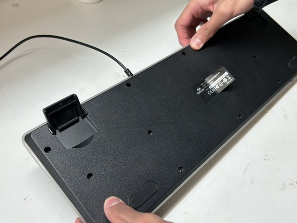

    • Unplug the USB cable to prevent issues during the repair.
  2. Repair Redragon S107 Unresponsive Keys: crwdns2935265:02crwdnd2935265:01crwdnd2935265:02crwdne2935265:0 Repair Redragon S107 Unresponsive Keys: crwdns2935265:02crwdnd2935265:02crwdnd2935265:02crwdne2935265:0
    • Remove all 13 Phillips screws located on the underside of the keyboard and gently remove the casing.

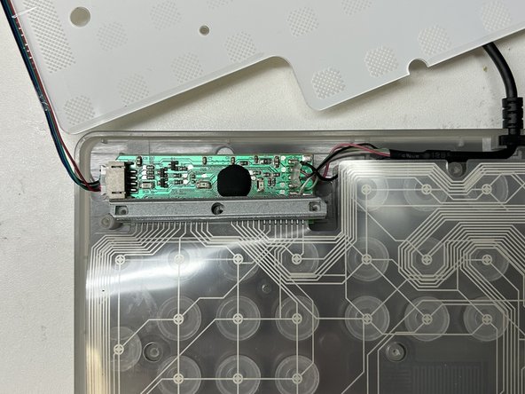

  3. Repair Redragon S107 Unresponsive Keys: crwdns2935265:03crwdnd2935265:01crwdnd2935265:01crwdne2935265:0
    • Lay the RGB LED panel flat on the desk.
    • Make sure that you do not damage the black wire on the left corner of the keyboard connected to the LED panel.

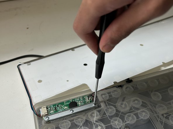

  4. Repair Redragon S107 Unresponsive Keys: crwdns2935265:04crwdnd2935265:01crwdnd2935265:02crwdne2935265:0 Repair Redragon S107 Unresponsive Keys: crwdns2935265:04crwdnd2935265:02crwdnd2935265:02crwdne2935265:0
    • Remove the three screws on the metal bracket located towards the top left on the keyboard.
    • Remove the rubber underneath the metal bar.

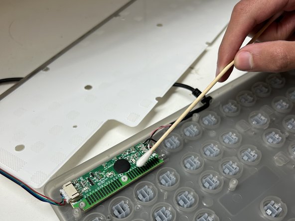

  5. Repair Redragon S107 Unresponsive Keys: crwdns2935265:05crwdnd2935265:01crwdnd2935265:02crwdne2935265:0 Repair Redragon S107 Unresponsive Keys: crwdns2935265:05crwdnd2935265:02crwdnd2935265:02crwdne2935265:0

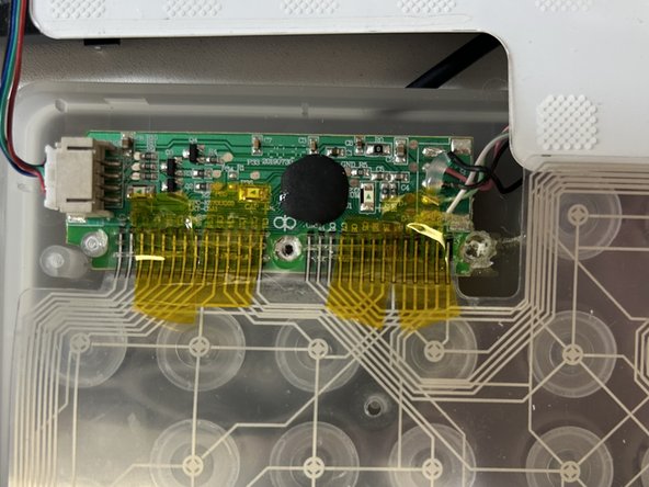

    • Use a cotton swab and add isopropyl alcohol to thoroughly clean the green membrane sheet and place the green membrane back onto the key switches.

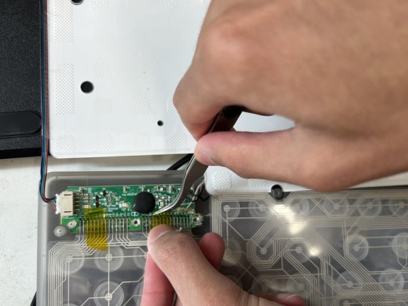

  6. Repair Redragon S107 Unresponsive Keys: crwdns2935265:06crwdnd2935265:01crwdnd2935265:03crwdne2935265:0 Repair Redragon S107 Unresponsive Keys: crwdns2935265:06crwdnd2935265:02crwdnd2935265:03crwdne2935265:0 Repair Redragon S107 Unresponsive Keys: crwdns2935265:06crwdnd2935265:03crwdnd2935265:03crwdne2935265:0
    • Use electrical tape to fix each contact strip that connects the green membrane to the motherboard into place.
    • Align the contact strips in place with the black lined traces provided on the motherboard.

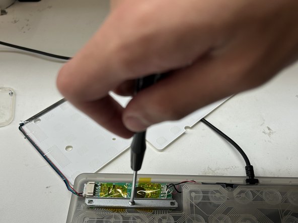

  7. Repair Redragon S107 Unresponsive Keys: crwdns2935265:07crwdnd2935265:01crwdnd2935265:03crwdne2935265:0 Repair Redragon S107 Unresponsive Keys: crwdns2935265:07crwdnd2935265:02crwdnd2935265:03crwdne2935265:0 Repair Redragon S107 Unresponsive Keys: crwdns2935265:07crwdnd2935265:03crwdnd2935265:03crwdne2935265:0
    • Place the rubber and metal bar back into place. Reinstall the three screws tightly as this will ensure no complications with the alignment of contact strips.
