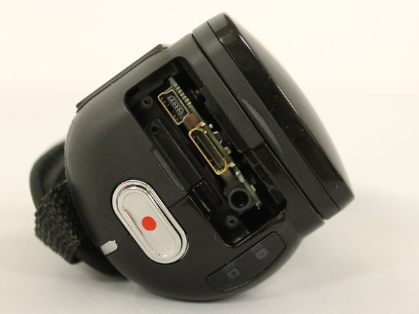

    • Find the device's HDMI/TV cover.
  5. Repair Broken Connections in the Pyrus PY21S03211: crwdns2935265:05crwdnd2935265:01crwdnd2935265:01crwdne2935265:0
    • Open the cover to reveal the device ports.

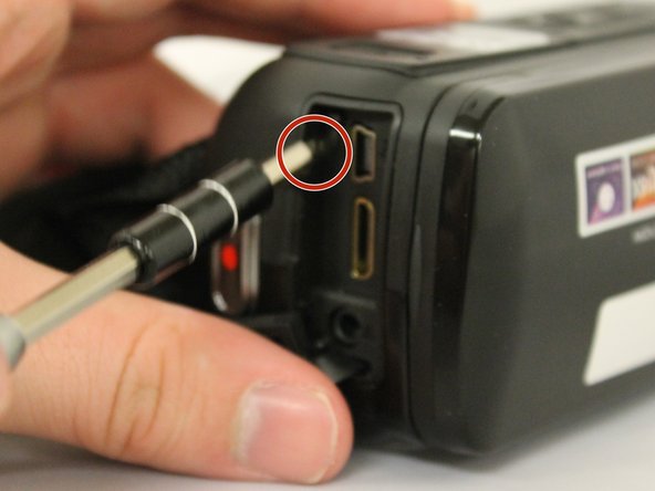

  6. Repair Broken Connections in the Pyrus PY21S03211: crwdns2935265:06crwdnd2935265:01crwdnd2935265:02crwdne2935265:0 Repair Broken Connections in the Pyrus PY21S03211: crwdns2935265:06crwdnd2935265:02crwdnd2935265:02crwdne2935265:0
    • Use the screwdriver to remove the 2 4mm screws from the port cover.

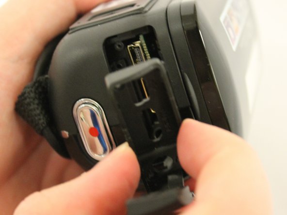

  7. Repair Broken Connections in the Pyrus PY21S03211: crwdns2935265:07crwdnd2935265:01crwdnd2935265:03crwdne2935265:0 Repair Broken Connections in the Pyrus PY21S03211: crwdns2935265:07crwdnd2935265:02crwdnd2935265:03crwdne2935265:0 Repair Broken Connections in the Pyrus PY21S03211: crwdns2935265:07crwdnd2935265:03crwdnd2935265:03crwdne2935265:0
    • Use the tweezers to remove the plastic port cover.

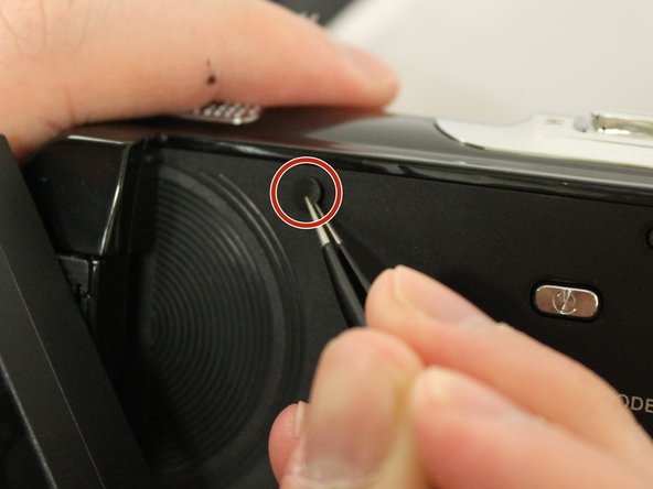

  9. Repair Broken Connections in the Pyrus PY21S03211: crwdns2935265:09crwdnd2935265:01crwdnd2935265:03crwdne2935265:0 Repair Broken Connections in the Pyrus PY21S03211: crwdns2935265:09crwdnd2935265:02crwdnd2935265:03crwdne2935265:0 Repair Broken Connections in the Pyrus PY21S03211: crwdns2935265:09crwdnd2935265:03crwdnd2935265:03crwdne2935265:0
    • Use tweezers to carefully pull out the circular stickers to reveal the 4mm screws.

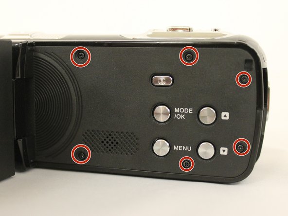

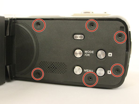

  10. Repair Broken Connections in the Pyrus PY21S03211: crwdns2935265:010crwdnd2935265:01crwdnd2935265:02crwdne2935265:0 Repair Broken Connections in the Pyrus PY21S03211: crwdns2935265:010crwdnd2935265:02crwdnd2935265:02crwdne2935265:0
    • Use the screwdriver to remove all six 4mm screws from the side of the device.

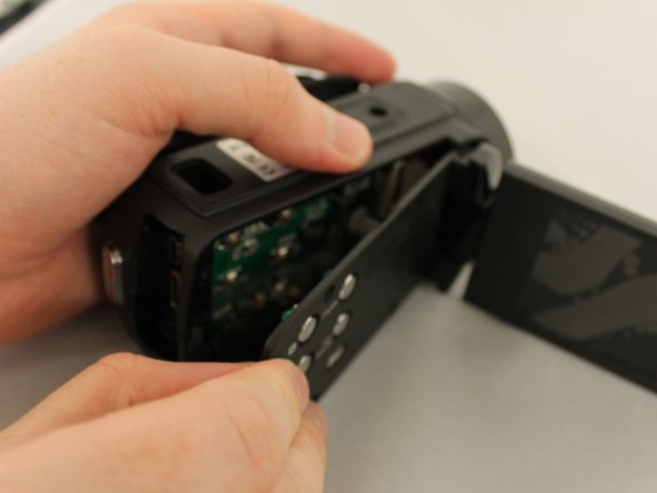

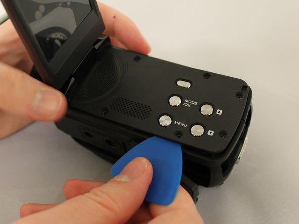

  11. Repair Broken Connections in the Pyrus PY21S03211: crwdns2935265:011crwdnd2935265:01crwdnd2935265:03crwdne2935265:0 Repair Broken Connections in the Pyrus PY21S03211: crwdns2935265:011crwdnd2935265:02crwdnd2935265:03crwdne2935265:0 Repair Broken Connections in the Pyrus PY21S03211: crwdns2935265:011crwdnd2935265:03crwdnd2935265:03crwdne2935265:0
    • Use a thin plastic pick to pry off the side of the device and carefully remove the display.
  12. Repair Broken Connections in the Pyrus PY21S03211: crwdns2935265:012crwdnd2935265:01crwdnd2935265:01crwdne2935265:0
    • Carefully remove the side face from the device. Avoid pulling on the white connector.
  13. Repair Broken Connections in the Pyrus PY21S03211: crwdns2935265:013crwdnd2935265:01crwdnd2935265:01crwdne2935265:0
    • To remove the side face entirely, find the large white connector, flip open the grey lip with tweezers, and gently remove the white connector.

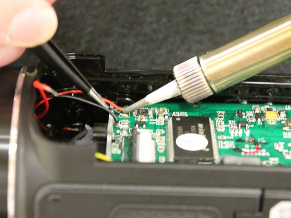

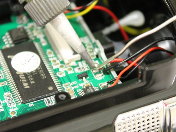

  14. Repair Broken Connections in the Pyrus PY21S03211: crwdns2935265:014crwdnd2935265:01crwdnd2935265:01crwdne2935265:0
    • Find the broken wire.
  15. Repair Broken Connections in the Pyrus PY21S03211: crwdns2935265:015crwdnd2935265:01crwdnd2935265:03crwdne2935265:0 Repair Broken Connections in the Pyrus PY21S03211: crwdns2935265:015crwdnd2935265:02crwdnd2935265:03crwdne2935265:0 Repair Broken Connections in the Pyrus PY21S03211: crwdns2935265:015crwdnd2935265:03crwdnd2935265:03crwdne2935265:0
