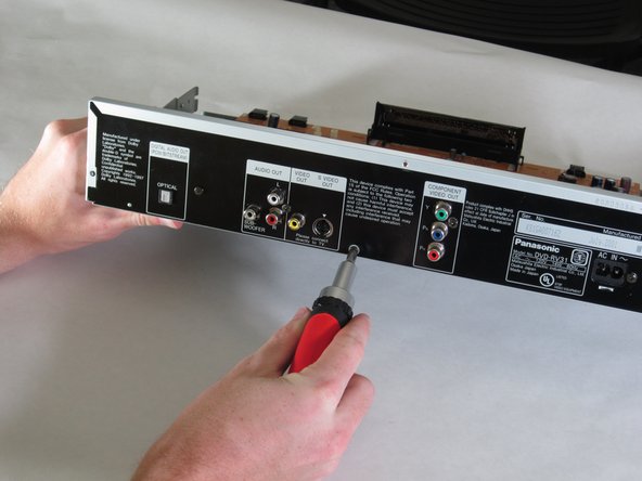

  3. Removinging Panasonic DVD-RV31 Player Rear Panel, Rear Panel: crwdns2935265:03crwdnd2935265:01crwdnd2935265:02crwdne2935265:0 Removinging Panasonic DVD-RV31 Player Rear Panel, Rear Panel: crwdns2935265:03crwdnd2935265:02crwdnd2935265:02crwdne2935265:0
    • Be sure case cover has been removed prior to back panel removal.
    • Remove 5 screws from panel, as shown.

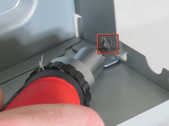

  4. Removinging Panasonic DVD-RV31 Player Rear Panel: crwdns2935265:04crwdnd2935265:01crwdnd2935265:02crwdne2935265:0 Removinging Panasonic DVD-RV31 Player Rear Panel: crwdns2935265:04crwdnd2935265:02crwdnd2935265:02crwdne2935265:0
    • Use flat-head screwdriver to push in square tabs, located on each side of the back panel.
    • Use caution, the edges are sharp.
