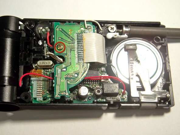

    1. Removing the Phone Keypad, Keypad: crwdns2935265:03crwdnd2935265:01crwdnd2935265:02crwdne2935265:0 Removing the Phone Keypad, Keypad: crwdns2935265:03crwdnd2935265:02crwdnd2935265:02crwdne2935265:0
      • Locate and unscrew the circled screw using a Philips head #2 screw driver or screw driver head.
    2. Removing the Phone Keypad: crwdns2935265:04crwdnd2935265:01crwdnd2935265:01crwdne2935265:0
      • Lift the motherboard away from the phone housing.
      • Be careful when lifting the motherboard. To prevent damage to the motherboard, gradually lift it from its place in the assembly.

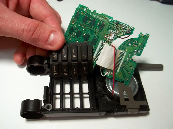

    3. Removing the Phone Keypad: crwdns2935265:05crwdnd2935265:01crwdnd2935265:02crwdne2935265:0 Removing the Phone Keypad: crwdns2935265:05crwdnd2935265:02crwdnd2935265:02crwdne2935265:0
      • Now that the motherboard has been lifted out of place, the keypad can be accessed.
      • Using your fingers push the buttons from the the phone toward the lifted motherboard.
      • Remove the keypad from the assembly.
