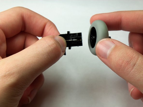

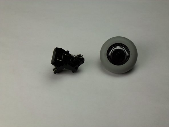

    • Place the replacement spring on the correct side of the wheel (shown in the images) with the prongs pointing down.
  6. Removing the Logitech MBJ58 Scroll Wheel from its Mount, Wheel Mount: crwdns2935265:06crwdnd2935265:01crwdnd2935265:03crwdne2935265:0 Removing the Logitech MBJ58 Scroll Wheel from its Mount, Wheel Mount: crwdns2935265:06crwdnd2935265:02crwdnd2935265:03crwdne2935265:0 Removing the Logitech MBJ58 Scroll Wheel from its Mount, Wheel Mount: crwdns2935265:06crwdnd2935265:03crwdnd2935265:03crwdne2935265:0
    • Locate the black wheel mount.
    • Note: Make sure that the spring hidden in the mount does not fall out.
    • Separate the wheel from its mount.
