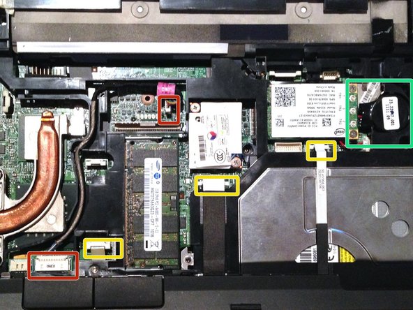

    • Turn the laptop upside down with the front toward you.
    • Locate and remove seven Torx T8 2.5×7.0 screws.
    • The screws may have rubber caps over them. If so remove with a spudger or similar tool.
    • Locate and remove one Philips M2.0×5.0 screw.
    • Turn the laptop right-side up with the front toward you.

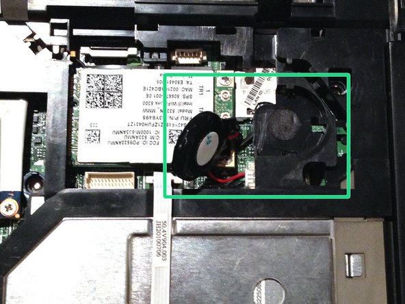

    • Release the three ZIF connectors and disconnect the ribbon cables.
    • This cable is routed over the top cover and needs to be disconnected at one end to allow the top cover to be removed.
    • Remove the RTC battery from its holder
  14. Removing the HP Elitebook 6930p Top Cover: crwdns2935265:014crwdnd2935265:01crwdnd2935265:01crwdne2935265:0
    • Lift the rear edge of the top cover until it separates from the base of the laptop and lifting it straight up.
