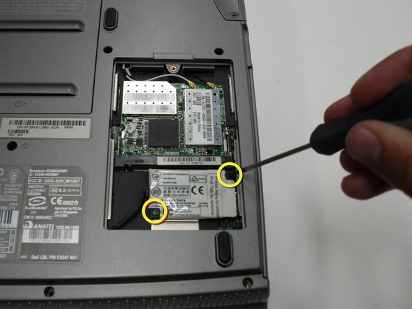

    • Turn the laptop upside down and locate the panel labeled C
    • Unscrew the single screw holding the cover in place.
    • Lift up the cover and remove it to expose the Modem Card.
  3. Removing the Dell Inspiron 1150 Modem Card: crwdns2935265:03crwdnd2935265:01crwdnd2935265:02crwdne2935265:0 Removing the Dell Inspiron 1150 Modem Card: crwdns2935265:03crwdnd2935265:02crwdnd2935265:02crwdne2935265:0
    • Locate the Modem card.
    • Remove the screws.

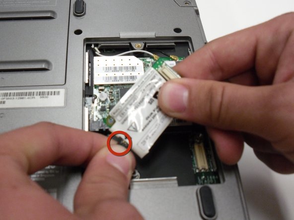

  4. Removing the Dell Inspiron 1150 Modem Card: crwdns2935265:04crwdnd2935265:01crwdnd2935265:02crwdne2935265:0 Removing the Dell Inspiron 1150 Modem Card: crwdns2935265:04crwdnd2935265:02crwdnd2935265:02crwdne2935265:0
    • Pull tab to lift the card out of the connector on the main board.
    • Disconnect the cable attached to the left edge of the Modem card
