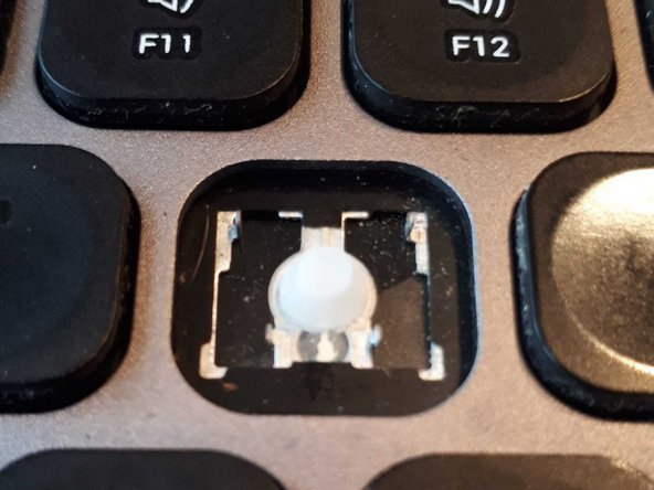

  2. Removing and replacing keys, (REFERENCE) Cap removed, armature still in place: crwdns2935265:02crwdnd2935265:01crwdnd2935265:02crwdne2935265:0 Removing and replacing keys, (REFERENCE) Cap removed, armature still in place: crwdns2935265:02crwdnd2935265:02crwdnd2935265:02crwdne2935265:0
    • These photos are to give you a reference for what it looks like when the armature is correctly in place. This may be helpful if you removed the armature and need to get it back in correctly.

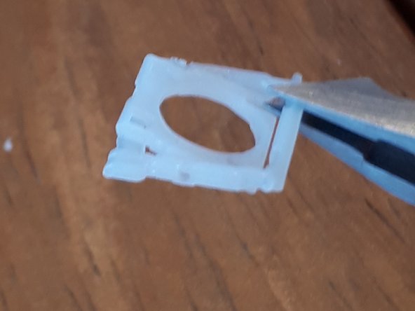

  3. Removing and replacing keys, (REFERENCE) Cap and armature removed: crwdns2935265:03crwdnd2935265:01crwdnd2935265:02crwdne2935265:0 Removing and replacing keys, (REFERENCE) Cap and armature removed: crwdns2935265:03crwdnd2935265:02crwdnd2935265:02crwdne2935265:0
    • This is just a visual reference showing the armature removed.
  4. Removing and replacing keys, (REFERENCE) The armature correctly pieced together: crwdns2935265:04crwdnd2935265:01crwdnd2935265:03crwdne2935265:0 Removing and replacing keys, (REFERENCE) The armature correctly pieced together: crwdns2935265:04crwdnd2935265:02crwdnd2935265:03crwdne2935265:0 Removing and replacing keys, (REFERENCE) The armature correctly pieced together: crwdns2935265:04crwdnd2935265:03crwdnd2935265:03crwdne2935265:0

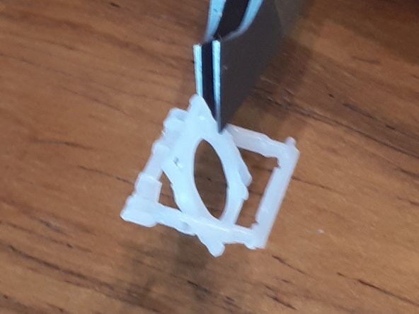

    • If you removed the key cap from the top edge first, the armature should have remained attached to the keyboard. This is the ideal situation (unless you need to remove the armature to clear something from it, in which case you'll likely need to remove it).
    • WHAT IF — perhaps like me, you may have attempted removing a key cap without instructions, and you didn't do it from the top edge. In which case, it's quite likely the armature came out, and may have come apart (it has two parts).
    • These photos show you what the armature should look like when correctly pieced together as one articulating component.
    • The armature should be pieced together as one component. See photos in previous step for how it will look when correctly pieced together.
    • The armature attaches in two locations. At the bottom edge, and at the top edge. You need to install the armature from the bottom edge first. There are tiny metal hooks toward the centre of the bottom edge, and there are two tiny hooks at each corner along the top edge.
    • You need to slide the bottom edge of the armature under the hooks so that the two holes in the armature get hooked onto the keyboard.
    • Then drop the top edge down onto the keyboard, and gently push the top left and top right corners so they click onto the small metal hooks in those locations.
    • The armature should now be reattached. Test it to ensure it's attached.
