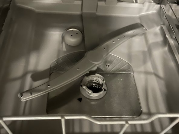

    • Open the dishwasher door to access the interior and locate the dishwasher spray arm
  2. Removing and Cleaning Dishwasher Spray Arm: crwdns2935265:02crwdnd2935265:01crwdnd2935265:01crwdne2935265:0
    • Remove the spray arm by grabbing the edge and slowly lifting it up with a bit of force.
  3. Removing and Cleaning Dishwasher Spray Arm: crwdns2935265:03crwdnd2935265:01crwdnd2935265:02crwdne2935265:0 Removing and Cleaning Dishwasher Spray Arm: crwdns2935265:03crwdnd2935265:02crwdnd2935265:02crwdne2935265:0

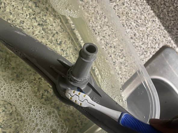

    • Place the spray arm and soak it in a big bowl of warm, soapy water to help loosen any debris on the spray arm.
  4. Removing and Cleaning Dishwasher Spray Arm: crwdns2935265:04crwdnd2935265:01crwdnd2935265:03crwdne2935265:0 Removing and Cleaning Dishwasher Spray Arm: crwdns2935265:04crwdnd2935265:02crwdnd2935265:03crwdne2935265:0 Removing and Cleaning Dishwasher Spray Arm: crwdns2935265:04crwdnd2935265:03crwdnd2935265:03crwdne2935265:0

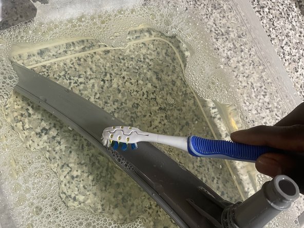

    • Equip your toothbrush (soft brush is fine too) and clean around the edges and nozzles to get out any dirt or debris.
  5. Removing and Cleaning Dishwasher Spray Arm: crwdns2935265:05crwdnd2935265:01crwdnd2935265:03crwdne2935265:0 Removing and Cleaning Dishwasher Spray Arm: crwdns2935265:05crwdnd2935265:02crwdnd2935265:03crwdne2935265:0 Removing and Cleaning Dishwasher Spray Arm: crwdns2935265:05crwdnd2935265:03crwdnd2935265:03crwdne2935265:0

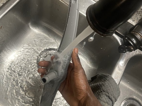

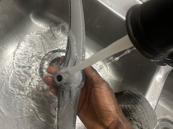

    • Take out your spray arm, use any type of clean water source (e.g your sink) and rinse the spray arm thoroughly with warm water.
  6. Removing and Cleaning Dishwasher Spray Arm: crwdns2935265:06crwdnd2935265:01crwdnd2935265:03crwdne2935265:0 Removing and Cleaning Dishwasher Spray Arm: crwdns2935265:06crwdnd2935265:02crwdnd2935265:03crwdne2935265:0 Removing and Cleaning Dishwasher Spray Arm: crwdns2935265:06crwdnd2935265:03crwdnd2935265:03crwdne2935265:0

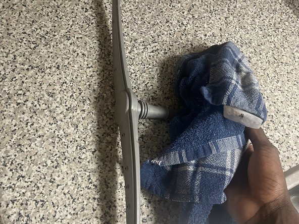

    • Equip your dishcloth and start drying around the edges and nozzles.
  7. Removing and Cleaning Dishwasher Spray Arm: crwdns2935265:07crwdnd2935265:01crwdnd2935265:03crwdne2935265:0 Removing and Cleaning Dishwasher Spray Arm: crwdns2935265:07crwdnd2935265:02crwdnd2935265:03crwdne2935265:0 Removing and Cleaning Dishwasher Spray Arm: crwdns2935265:07crwdnd2935265:03crwdnd2935265:03crwdne2935265:0
    • Take your spray arm and place it back in its original compartment. Do this by grabbing the edge and slowly pushing down with a bit of force.
