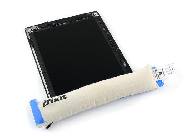

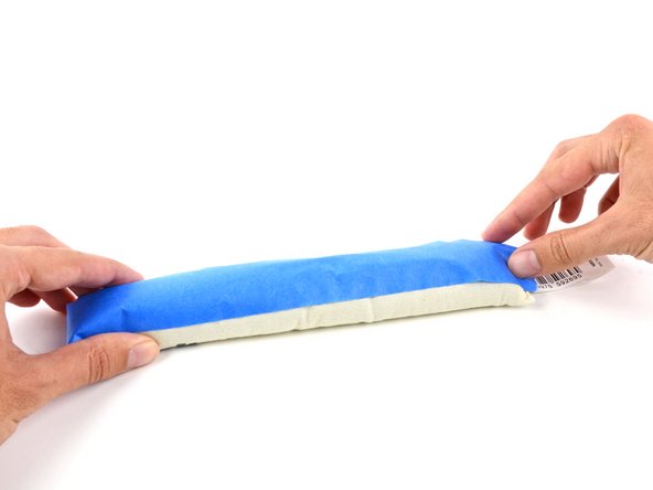

    • For the next step, you'll need to apply your iOpener directly to the broken glass left adhered to the iPad.
    • To protect your iOpener from the glass and keep it from filling with glass dust, stick some masking tape to one side.
    • Heat the iOpener and apply it to one edge of the iPad, directly on top of the pieces of glass that are still adhered to the rear case of the iPad.
    • Leave the iOpener there for at least 90 seconds, to soften the adhesive holding these small pieces in place.
    • Be careful not to touch or otherwise disturb the LCD.

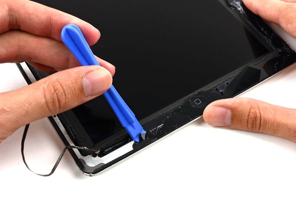

    • Did you take off your safety glasses? If so, put them back on now. Seriously.
    • Grab your favorite plastic tool and start prying out the remaining pieces of glass from the iPad frame.
    • This is a slow and tedious process, but benefits greatly from heating the adhesive.
    • There is a serious risk of cutting yourself while working with this glass. Work slowly and with controlled force. You may wish to wear thin leather gloves.
    • Remove all of the glass and residual adhesive and continue your repair.

During step 9, if you can manage to grab an end of the adhesive going under glass, see if you can slowly pull it out and to the side of the frame. If the strip doesn’t break too much, this should greatly reduce shard spread and increase speed!
