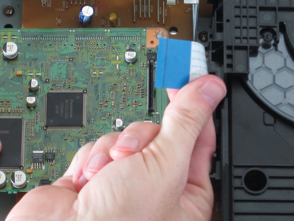

  6. Removing Panasonic DVD-RV31 Player Motherboard, Motherboard: crwdns2935265:06crwdnd2935265:01crwdnd2935265:02crwdne2935265:0 Removing Panasonic DVD-RV31 Player Motherboard, Motherboard: crwdns2935265:06crwdnd2935265:02crwdnd2935265:02crwdne2935265:0
    • Remove the blue ribbon wire from its connector. When doing this, be cautious to not damage the connector.
    • Place forefinger under cable loop as shown, gripping with thumb.
    • Pull straight up. It should disconnect with little force.

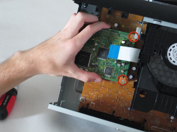

    • Using tweezers or pliers, squeeze the tabs of the plastic fasteners together. While doing this, gently lift up on the motherboard until the fasteners are released.
  8. Removing Panasonic DVD-RV31 Player Motherboard: crwdns2935265:08crwdnd2935265:01crwdnd2935265:01crwdne2935265:0
    • Remove the two screws securing the motherboard using a philips screw driver.
  9. Removing Panasonic DVD-RV31 Player Motherboard: crwdns2935265:09crwdnd2935265:01crwdnd2935265:01crwdne2935265:0
    • Lift the board from the side closest to the front panel (top of photo).
    • Gently apply force until bottom connector releases from power board below.
