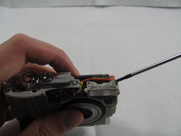

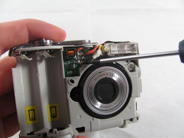

    1. Removing Olympus FE-210 Flash Assembly, Flash Assembly: crwdns2935265:07crwdnd2935265:01crwdnd2935265:02crwdne2935265:0 Removing Olympus FE-210 Flash Assembly, Flash Assembly: crwdns2935265:07crwdnd2935265:02crwdnd2935265:02crwdne2935265:0
      • Remove the two 2.7 mm screws using a #00 screwdriver.
    2. Removing Olympus FE-210 Flash Assembly: crwdns2935265:08crwdnd2935265:01crwdnd2935265:02crwdne2935265:0 Removing Olympus FE-210 Flash Assembly: crwdns2935265:08crwdnd2935265:02crwdnd2935265:02crwdne2935265:0

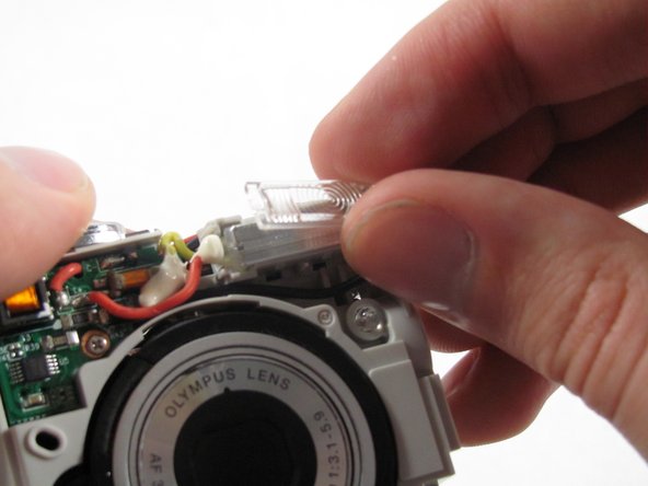

      • Remove the metal casing on the flash, by grabbing with two fingers and pry it off the snaps connecting it to the flash.
      • Remove the plastic cover on the flash, by simply grabbing the plastic with two fingers and pulling.
    3. Removing Olympus FE-210 Flash Assembly: crwdns2935265:09crwdnd2935265:01crwdnd2935265:02crwdne2935265:0 Removing Olympus FE-210 Flash Assembly: crwdns2935265:09crwdnd2935265:02crwdnd2935265:02crwdne2935265:0
      • Remove the 2.7 mm screw holding the front circuit board in place.

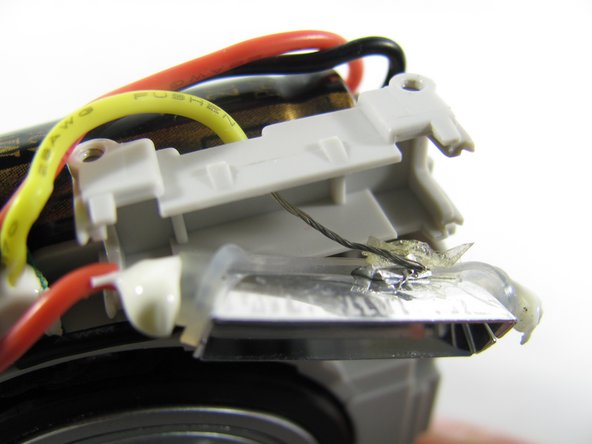

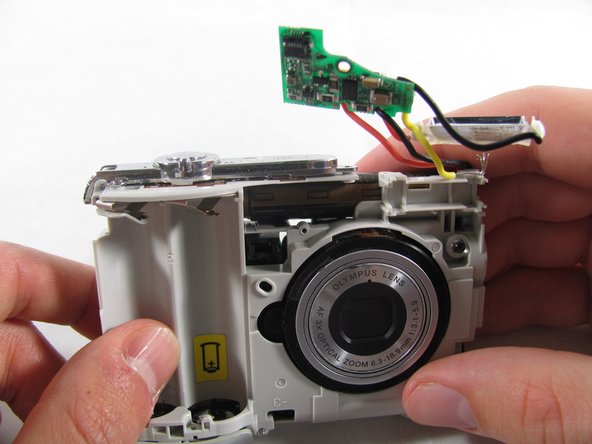

    4. Removing Olympus FE-210 Flash Assembly: crwdns2935265:010crwdnd2935265:01crwdnd2935265:03crwdne2935265:0 Removing Olympus FE-210 Flash Assembly: crwdns2935265:010crwdnd2935265:02crwdnd2935265:03crwdne2935265:0 Removing Olympus FE-210 Flash Assembly: crwdns2935265:010crwdnd2935265:03crwdnd2935265:03crwdne2935265:0
      • Remove the circuit board by prying it out with a spudger.
      • Remove the flashbulb from its place.
      • When taking out the flash bulb, be sure to carefully remove the wire taped to the back of the bulb (as shown in the second image). Gently separate the tape and the wire.

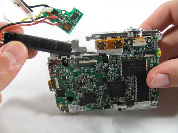

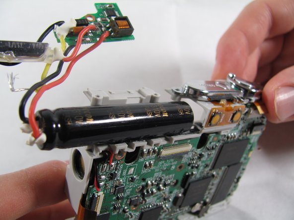

    5. Removing Olympus FE-210 Flash Assembly: crwdns2935265:011crwdnd2935265:01crwdnd2935265:03crwdne2935265:0 Removing Olympus FE-210 Flash Assembly: crwdns2935265:011crwdnd2935265:02crwdnd2935265:03crwdne2935265:0 Removing Olympus FE-210 Flash Assembly: crwdns2935265:011crwdnd2935265:03crwdnd2935265:03crwdne2935265:0
      • To remove the capacitor you must slide it out from the sticky tape that is holding it in place.
      • First insert a spudger between the capacitor and the plastic.
      • Pry with the spudger or pull with your hands to loosen the capacitor.
      • Capacitors can contain a lot of energy. If you touch the terminals you could get a strong shock. So be careful to avoid the terminals with your fingers and don't use any metal tools to interact with the capacitor.
      • The capacitor can be difficult to loosen at first, give it strong pulls and pushes and it should come out.
