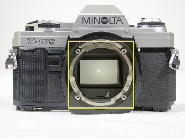

Removing Minolta X-370 Lens Holder

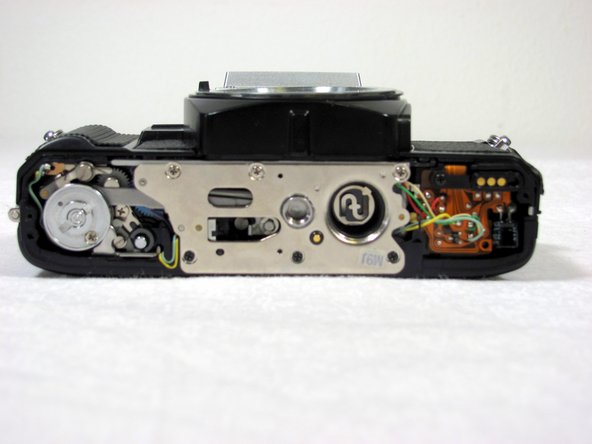

  3. Removing Minolta X-370 Lens Holder, Bottom Cover: crwdns2935265:03crwdnd2935265:01crwdnd2935265:02crwdne2935265:0 Removing Minolta X-370 Lens Holder, Bottom Cover: crwdns2935265:03crwdnd2935265:02crwdnd2935265:02crwdne2935265:0
    • Remove two 4.8mm screws.
    • Remove one 3.4mm screw.
    • Remove one 2.65mm screw.
    • Lift off the back cover.

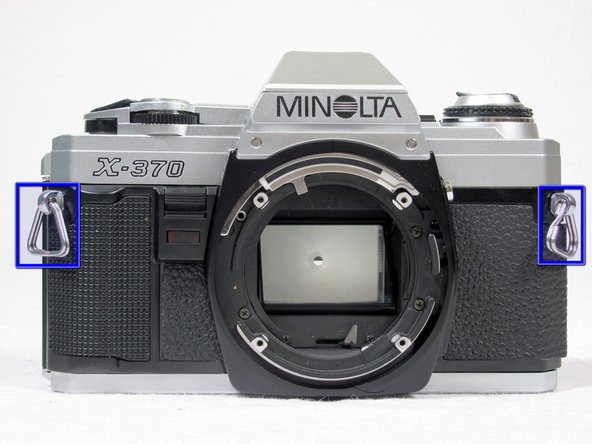

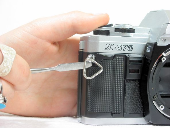

  7. Removing Minolta X-370 Lens Holder: crwdns2935265:07crwdnd2935265:01crwdnd2935265:03crwdne2935265:0 Removing Minolta X-370 Lens Holder: crwdns2935265:07crwdnd2935265:02crwdnd2935265:03crwdne2935265:0 Removing Minolta X-370 Lens Holder: crwdns2935265:07crwdnd2935265:03crwdnd2935265:03crwdne2935265:0
    • Remove the two black stoppers.
    • Using the metal spudger, remove the two triangular hangers.

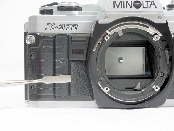

  8. Removing Minolta X-370 Lens Holder: crwdns2935265:08crwdnd2935265:01crwdnd2935265:02crwdne2935265:0 Removing Minolta X-370 Lens Holder: crwdns2935265:08crwdnd2935265:02crwdnd2935265:02crwdne2935265:0

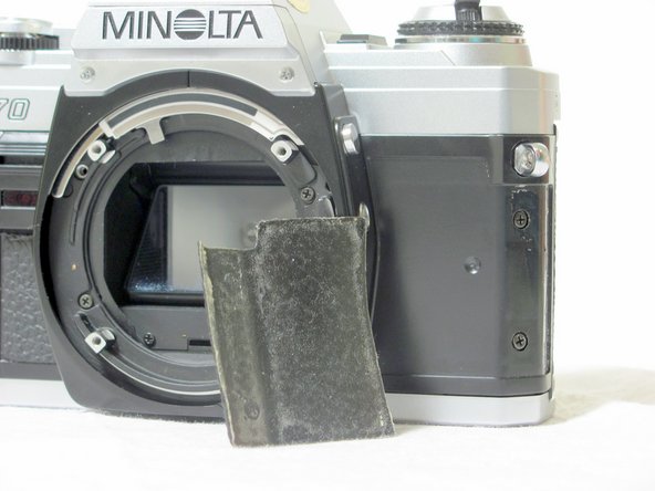

    • Using the metal spudger, peel off the right leather cover.
    • Be careful not to tear the cover because you will need to use it again.

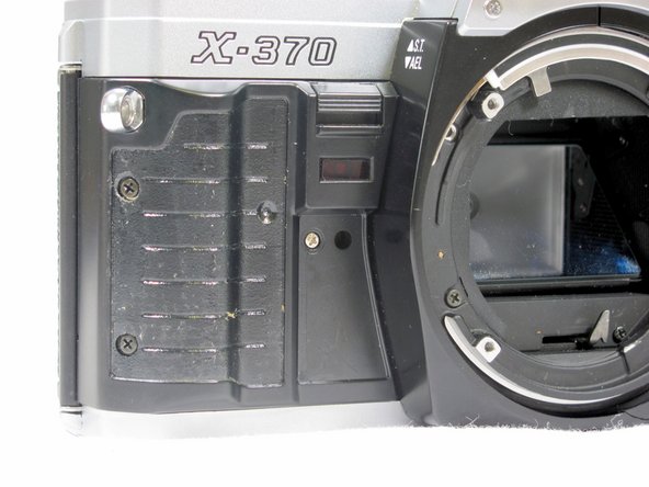

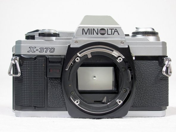

  9. Removing Minolta X-370 Lens Holder: crwdns2935265:09crwdnd2935265:01crwdnd2935265:03crwdne2935265:0 Removing Minolta X-370 Lens Holder: crwdns2935265:09crwdnd2935265:02crwdnd2935265:03crwdne2935265:0 Removing Minolta X-370 Lens Holder: crwdns2935265:09crwdnd2935265:03crwdnd2935265:03crwdne2935265:0
    • Use the metal spudger to remove both the grip cover and the left leather cover.
    • Be careful not to tear the covers because you will need to use them again.

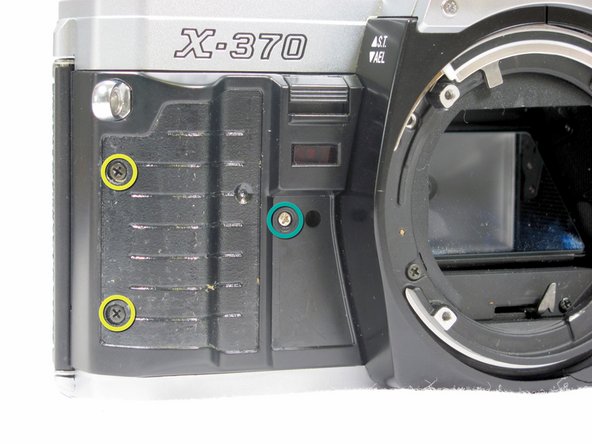

  10. Removing Minolta X-370 Lens Holder: crwdns2935265:010crwdnd2935265:01crwdnd2935265:02crwdne2935265:0 Removing Minolta X-370 Lens Holder: crwdns2935265:010crwdnd2935265:02crwdnd2935265:02crwdne2935265:0
    • Remove two 5.3mm screws.
    • Remove one 2.35mm screws.

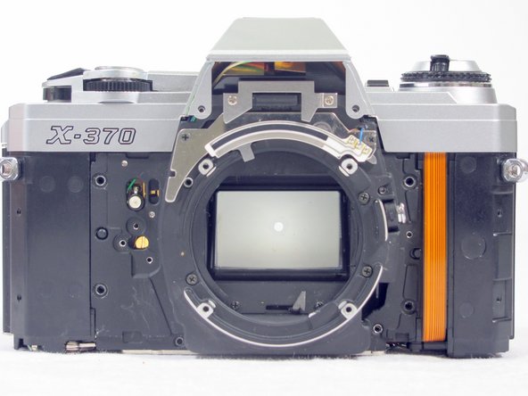

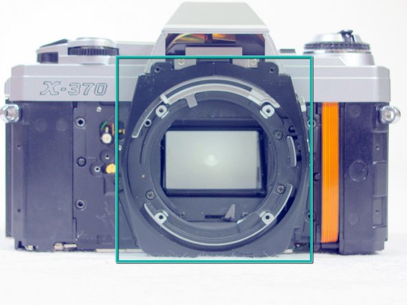

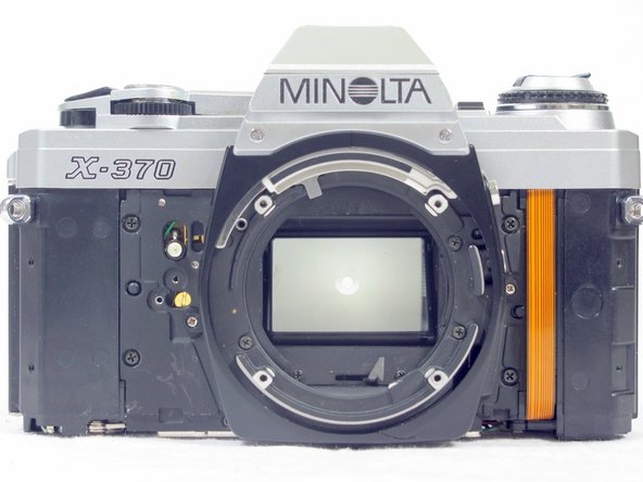

  11. Removing Minolta X-370 Lens Holder: crwdns2935265:011crwdnd2935265:01crwdnd2935265:02crwdne2935265:0 Removing Minolta X-370 Lens Holder: crwdns2935265:011crwdnd2935265:02crwdnd2935265:02crwdne2935265:0
    • Remove the left and right plastic covers.
  12. Removing Minolta X-370 Lens Holder: crwdns2935265:012crwdnd2935265:01crwdnd2935265:03crwdne2935265:0 Removing Minolta X-370 Lens Holder: crwdns2935265:012crwdnd2935265:02crwdnd2935265:03crwdne2935265:0 Removing Minolta X-370 Lens Holder: crwdns2935265:012crwdnd2935265:03crwdnd2935265:03crwdne2935265:0
    • Remove two 6.65mm screws.
    • Remove two 2.93mm screws.
    • Remove four 5.3mm screws.
    • Remove the black plastic lens holder.
