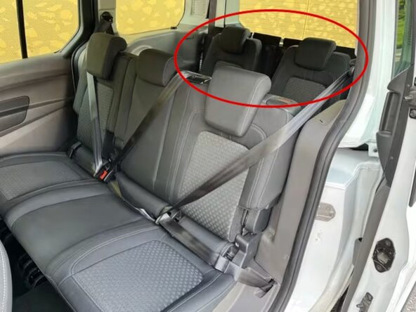

Removing Ford Transit Connect Second Generation Back seat
  1. Removing Ford Transit Connect Second Generation Back seat, Back seats: crwdns2935265:01crwdnd2935265:01crwdnd2935265:01crwdne2935265:0
    • Fold the middle seats to access the two back seats.

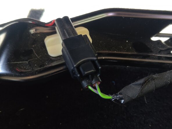

  2. Removing Ford Transit Connect Second Generation Back seat: crwdns2935265:02crwdnd2935265:01crwdnd2935265:02crwdne2935265:0 Removing Ford Transit Connect Second Generation Back seat: crwdns2935265:02crwdnd2935265:02crwdnd2935265:02crwdne2935265:0
    • Unplug the terminal block underneath the seat connecting wires by pressing very hard.
