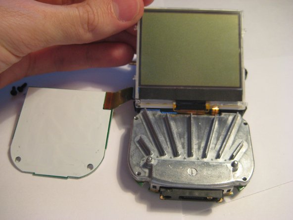

  11. Removing Delphi MyFi XM2GO Keypad: crwdns2935265:011crwdnd2935265:01crwdnd2935265:01crwdne2935265:0
    • Lift up the keyboard carefully from the right side, flipping to the left.
    • NOTE: The keyboard is attached on the left side by a ribbon cable. Do not remove it completely yet.

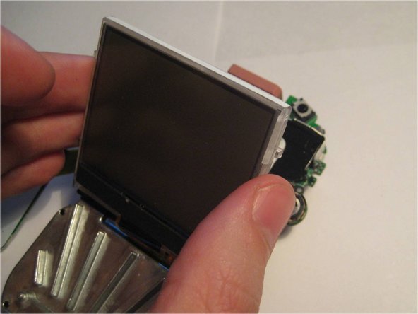

  12. Removing Delphi MyFi XM2GO Keypad: crwdns2935265:012crwdnd2935265:01crwdnd2935265:03crwdne2935265:0 Removing Delphi MyFi XM2GO Keypad: crwdns2935265:012crwdnd2935265:02crwdnd2935265:03crwdne2935265:0 Removing Delphi MyFi XM2GO Keypad: crwdns2935265:012crwdnd2935265:03crwdnd2935265:03crwdne2935265:0
    • Pivot the LCD screen, pulling on the top and sides and keeping the bottom attached.

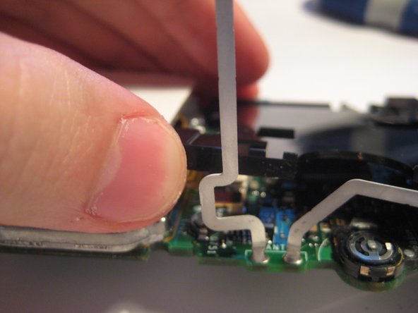

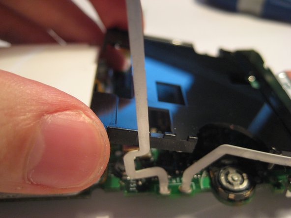

  13. Removing Delphi MyFi XM2GO Keypad: crwdns2935265:013crwdnd2935265:01crwdnd2935265:03crwdne2935265:0 Removing Delphi MyFi XM2GO Keypad: crwdns2935265:013crwdnd2935265:02crwdnd2935265:03crwdne2935265:0 Removing Delphi MyFi XM2GO Keypad: crwdns2935265:013crwdnd2935265:03crwdnd2935265:03crwdne2935265:0

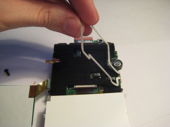

    • Continue to pivot the screen until it is lying on its face.
    • Pivot the wire frame, that was under the LCD, from the left side.
    • CAUTION: The wire bends as the frame pivots. Use the least amount of force necessary.

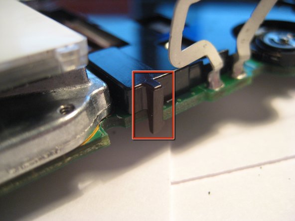

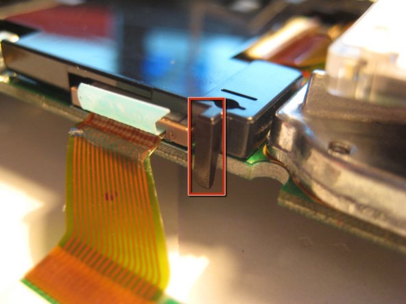

  14. Removing Delphi MyFi XM2GO Keypad: crwdns2935265:014crwdnd2935265:01crwdnd2935265:03crwdne2935265:0 Removing Delphi MyFi XM2GO Keypad: crwdns2935265:014crwdnd2935265:02crwdnd2935265:03crwdne2935265:0 Removing Delphi MyFi XM2GO Keypad: crwdns2935265:014crwdnd2935265:03crwdnd2935265:03crwdne2935265:0
    • With the frame perpendicular to the device, locate the two black, plastic tabs shown in the two red circles.
    • The boxes show more detailed views in the following pictures.

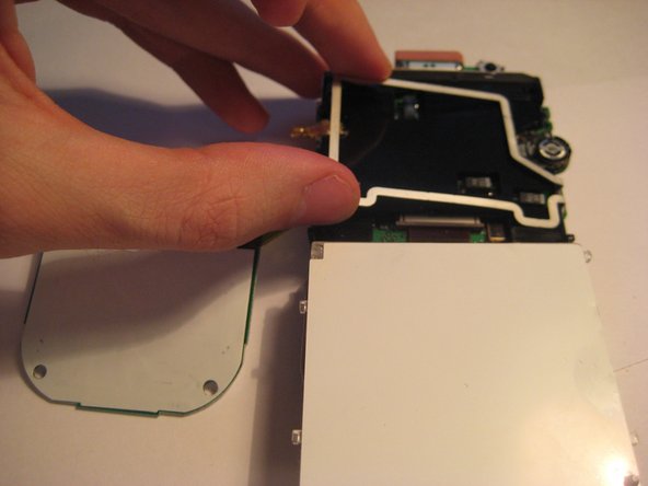

  15. Removing Delphi MyFi XM2GO Keypad: crwdns2935265:015crwdnd2935265:01crwdnd2935265:03crwdne2935265:0 Removing Delphi MyFi XM2GO Keypad: crwdns2935265:015crwdnd2935265:02crwdnd2935265:03crwdne2935265:0 Removing Delphi MyFi XM2GO Keypad: crwdns2935265:015crwdnd2935265:03crwdnd2935265:03crwdne2935265:0
    • WIth both hands, pull the tabs outwards to release the plastic cover from the board.
    • Once the tabs are disengaged, pivot the plastic cover upwards.
    • After the cover is pivoted slightly, remove it from the device.

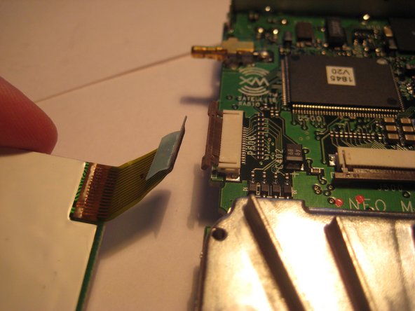

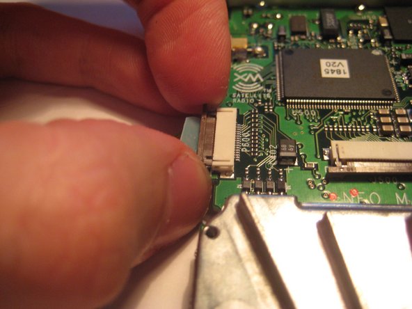

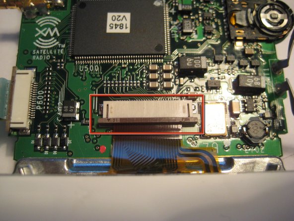

  16. Removing Delphi MyFi XM2GO Keypad: crwdns2935265:016crwdnd2935265:01crwdnd2935265:02crwdne2935265:0 Removing Delphi MyFi XM2GO Keypad: crwdns2935265:016crwdnd2935265:02crwdnd2935265:02crwdne2935265:0
    • After the plastic cover is removed, locate the white, ribbon connector highlighted by the red square.
    • Rotate the device 90 degrees counterclockwise to remove the ribbon connector.

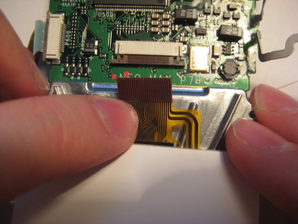

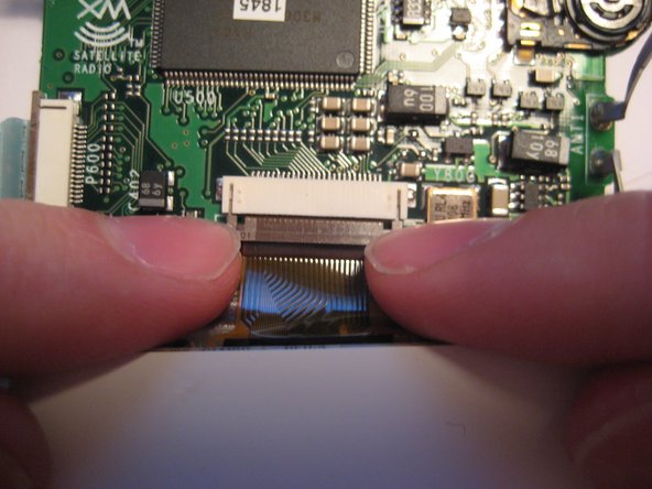

  17. Removing Delphi MyFi XM2GO Keypad: crwdns2935265:017crwdnd2935265:01crwdnd2935265:03crwdne2935265:0 Removing Delphi MyFi XM2GO Keypad: crwdns2935265:017crwdnd2935265:02crwdnd2935265:03crwdne2935265:0 Removing Delphi MyFi XM2GO Keypad: crwdns2935265:017crwdnd2935265:03crwdnd2935265:03crwdne2935265:0
    • To remove the ribbon cable from the board, catch the sides of the connector with fingernails and pull downward.
    • CAUTION: The connector is delicate.
    • After the latch is pulled down, the ribbon cable is free to slide out of the connector housing.

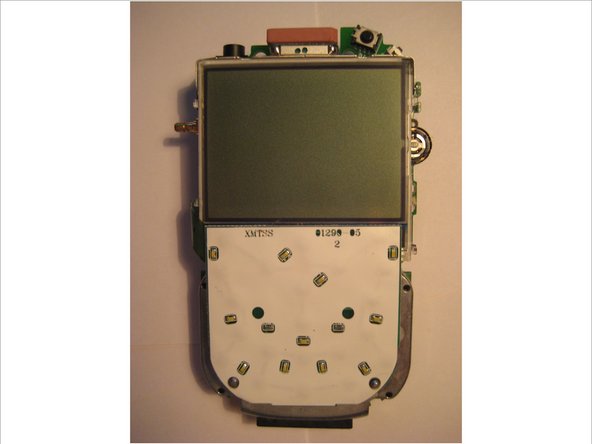

  18. Removing Delphi MyFi XM2GO Keypad: crwdns2935265:018crwdnd2935265:01crwdnd2935265:01crwdne2935265:0
    • After following the prerequisite steps in the guide, the components are laid out as depicted in the picture.
    • The LCD screen is highlighted in red.
  19. Removing Delphi MyFi XM2GO Keypad, Removing Delphi MyFi XM2GO Keypad: crwdns2935265:019crwdnd2935265:01crwdnd2935265:03crwdne2935265:0 Removing Delphi MyFi XM2GO Keypad, Removing Delphi MyFi XM2GO Keypad: crwdns2935265:019crwdnd2935265:02crwdnd2935265:03crwdne2935265:0 Removing Delphi MyFi XM2GO Keypad, Removing Delphi MyFi XM2GO Keypad: crwdns2935265:019crwdnd2935265:03crwdnd2935265:03crwdne2935265:0

  20. Removing Delphi MyFi XM2GO Keypad: crwdns2935265:020crwdnd2935265:01crwdnd2935265:01crwdne2935265:0
    • After following the prerequisite steps and the steps of this guide, all of the components should look like this.
    • The keyboard is highlighted in red.
