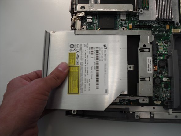

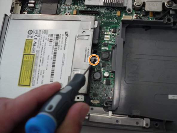

    • Locate the optical disk drive on the bottom left hand side of the laptop.
    • Remove the single screw holding the optical disk drive in the chassis.
    • Remove the optical disk drive by gently pulling on the outer edge.
