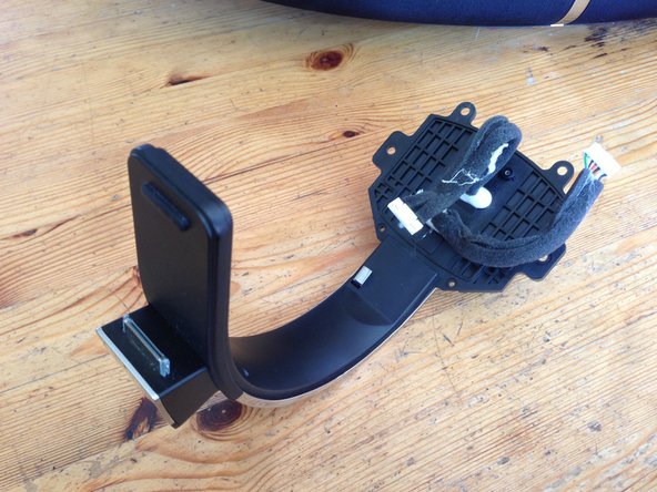

    • Remove the six screws that attach the dock arm to the Zeppelin.
    • Lift up the dock arm.

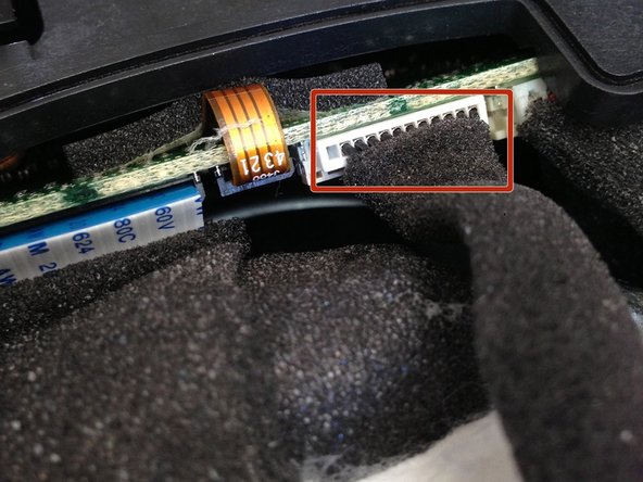

  4. Removing Bowers and Wilkins Zeppelin Air Dock Arm: crwdns2935265:04crwdnd2935265:01crwdnd2935265:03crwdne2935265:0 Removing Bowers and Wilkins Zeppelin Air Dock Arm: crwdns2935265:04crwdnd2935265:02crwdnd2935265:03crwdne2935265:0 Removing Bowers and Wilkins Zeppelin Air Dock Arm: crwdns2935265:04crwdnd2935265:03crwdnd2935265:03crwdne2935265:0
    • Unplug the frontmost connector.
    • You might have to use a knife or the flat end of a spudge to push the tab.
  5. Removing Bowers and Wilkins Zeppelin Air Dock Arm: crwdns2935265:05crwdnd2935265:01crwdnd2935265:02crwdne2935265:0 Removing Bowers and Wilkins Zeppelin Air Dock Arm: crwdns2935265:05crwdnd2935265:02crwdnd2935265:02crwdne2935265:0
    • Unplug the other connector. I just pulled until it unplugged.
    • Remove the dock arm.
