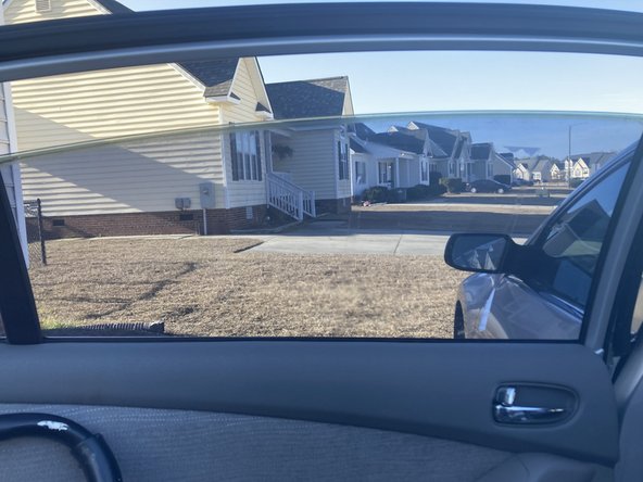

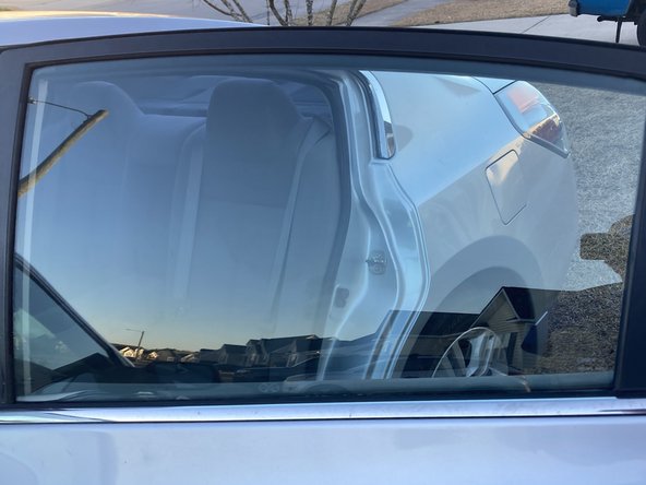

  1. Removing Aftermarket Vehicle Window Tinting, Before Photos: crwdns2935265:01crwdnd2935265:01crwdnd2935265:03crwdne2935265:0 Removing Aftermarket Vehicle Window Tinting, Before Photos: crwdns2935265:01crwdnd2935265:02crwdnd2935265:03crwdne2935265:0 Removing Aftermarket Vehicle Window Tinting, Before Photos: crwdns2935265:01crwdnd2935265:03crwdnd2935265:03crwdne2935265:0
    • This is what your window will look like before.
    • And the third photo shows what it will look like after!

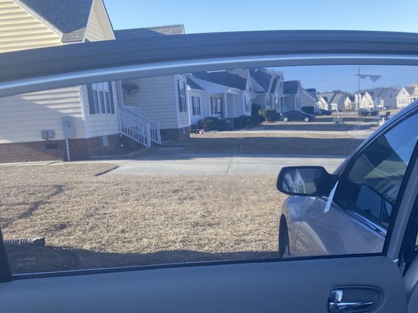

  2. Removing Aftermarket Vehicle Window Tinting: crwdns2935265:02crwdnd2935265:01crwdnd2935265:02crwdne2935265:0 Removing Aftermarket Vehicle Window Tinting: crwdns2935265:02crwdnd2935265:02crwdnd2935265:02crwdne2935265:0

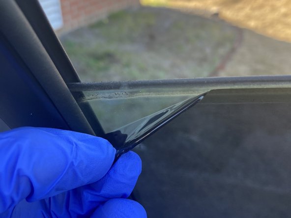

    • Roll down the window about 1/4 of the way so you can start to remove the tint from the top.

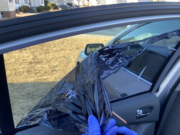

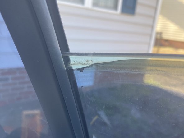

  3. Removing Aftermarket Vehicle Window Tinting: crwdns2935265:03crwdnd2935265:01crwdnd2935265:03crwdne2935265:0 Removing Aftermarket Vehicle Window Tinting: crwdns2935265:03crwdnd2935265:02crwdnd2935265:03crwdne2935265:0 Removing Aftermarket Vehicle Window Tinting: crwdns2935265:03crwdnd2935265:03crwdnd2935265:03crwdne2935265:0
    • Heat the area with a heat gun at the window's edge.
    • Start by using the low setting on the heat gun to gradually heat the surface. After the area has warmed up, you can switch to high heat to make it easier to remove the film.

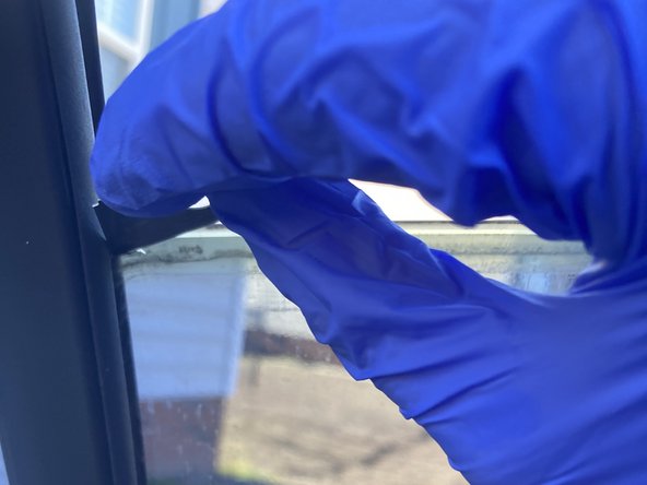

    • Use the razor blade to peel a small area of the tint film up.
  4. Removing Aftermarket Vehicle Window Tinting: crwdns2935265:04crwdnd2935265:01crwdnd2935265:02crwdne2935265:0 Removing Aftermarket Vehicle Window Tinting: crwdns2935265:04crwdnd2935265:02crwdnd2935265:02crwdne2935265:0
    • Once you've peeled enough with the razor blade to use your fingers, heat the area, then peel with your fingers.
    • Don't pull with your fingers and heat the area with the gun simultaneously. You'll burn yourself.
    • Heat the film angling the heat gun up. This will ensure that the film will not rip easily.

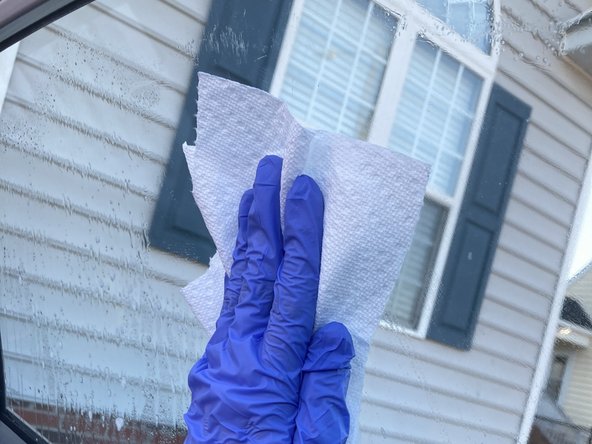

  7. Removing Aftermarket Vehicle Window Tinting: crwdns2935265:08crwdnd2935265:01crwdnd2935265:02crwdne2935265:0 Removing Aftermarket Vehicle Window Tinting: crwdns2935265:08crwdnd2935265:02crwdnd2935265:02crwdne2935265:0

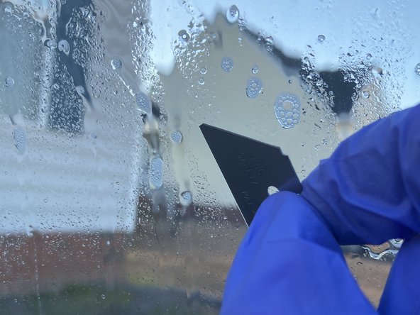

    • Once you have removed all of the film, spray the window with glass cleaner and clean the window with either a rag or paper towel.
  8. Removing Aftermarket Vehicle Window Tinting: crwdns2935265:09crwdnd2935265:01crwdnd2935265:02crwdne2935265:0 Removing Aftermarket Vehicle Window Tinting: crwdns2935265:09crwdnd2935265:02crwdnd2935265:02crwdne2935265:0
    • For areas where some residue is still on the window, spray the area with glass cleaner and use the razor blade to scrape the area to remove the residue.
    • For really tough residue, use Goo Gone in lieu of glass cleaner.

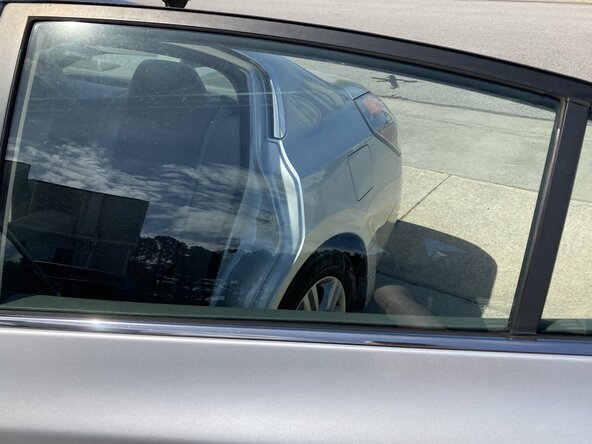

  9. Removing Aftermarket Vehicle Window Tinting: crwdns2935265:010crwdnd2935265:01crwdnd2935265:02crwdne2935265:0 Removing Aftermarket Vehicle Window Tinting: crwdns2935265:010crwdnd2935265:02crwdnd2935265:02crwdne2935265:0

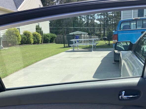

    • First photo: Before
    • Second photo: After
  10. Removing Aftermarket Vehicle Window Tinting, Before and After: crwdns2935265:011crwdnd2935265:01crwdnd2935265:02crwdne2935265:0 Removing Aftermarket Vehicle Window Tinting, Before and After: crwdns2935265:011crwdnd2935265:02crwdnd2935265:02crwdne2935265:0
You are finished! Repeat the steps in this guide for every window you wish to remove the tinting.
