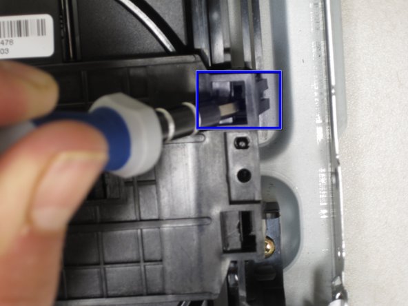

  5. Remove Stuck Disc from Samsung P241: crwdns2935265:05crwdnd2935265:01crwdnd2935265:02crwdne2935265:0 Remove Stuck Disc from Samsung P241: crwdns2935265:05crwdnd2935265:02crwdnd2935265:02crwdne2935265:0
    • You will now pry off the black plastic cover from the disc tray. Insert a flathead screwdriver into the slot indicated and press down while at the same time pulling the screwdriver towards the middle of the device. This will pop the plastic catch out to the side.
  6. Remove Stuck Disc from Samsung P241: crwdns2935265:06crwdnd2935265:01crwdnd2935265:01crwdne2935265:0

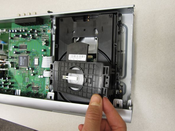

    • Without removing the first screwdriver, insert a second one into the hole indicated and do the same motion.
    • You can now lift up the right side of the cover. Don't pull up too far or you could break the clasps on the left side.
  7. Remove Stuck Disc from Samsung P241: crwdns2935265:07crwdnd2935265:01crwdnd2935265:01crwdne2935265:0
    • Now repeat this process, unclipping the catches on the other side.

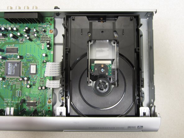

  8. Remove Stuck Disc from Samsung P241: crwdns2935265:08crwdnd2935265:01crwdnd2935265:03crwdne2935265:0 Remove Stuck Disc from Samsung P241: crwdns2935265:08crwdnd2935265:02crwdnd2935265:03crwdne2935265:0 Remove Stuck Disc from Samsung P241: crwdns2935265:08crwdnd2935265:03crwdnd2935265:03crwdne2935265:0
    • You can now pop of the black plastic cover and see the exposed disc drive. If there is anything stuck inside that is jamming the drive, you can remove it.
