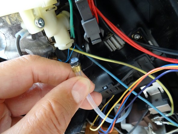

    • Remove the Torx T15 screw from the water inlet.
    • Lift the water inlet and bend it to the side. The hose can remain connected.
  5. Remove Jura Brew unit: crwdns2935265:05crwdnd2935265:01crwdnd2935265:02crwdne2935265:0 Remove Jura Brew unit: crwdns2935265:05crwdnd2935265:02crwdnd2935265:02crwdne2935265:0
    • Pull out the clamp on the pressure hose between the steam valve and the brew unit.
    • Remove the pressure hose.
