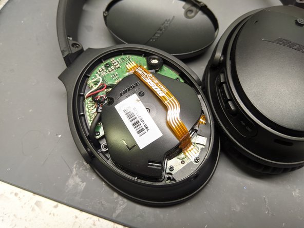

    • Place the headphones down with ear cushions facing you
    • Cushions are held in by small tabs along the perimeter. Remove by hand
  2. Remove Dislodged Plug Parts, Remove Left Driver Pad: crwdns2935265:02crwdnd2935265:01crwdnd2935265:02crwdne2935265:0 Remove Dislodged Plug Parts, Remove Left Driver Pad: crwdns2935265:02crwdnd2935265:02crwdnd2935265:02crwdne2935265:0
    • Pad is held in by two pieces of double-sided tape. You only need to peel back the left piece, as shown
    • Be careful to avoid tearing the pad
  3. Remove Dislodged Plug Parts, Remove Left Backplate: crwdns2935265:03crwdnd2935265:01crwdnd2935265:02crwdne2935265:0 Remove Dislodged Plug Parts, Remove Left Backplate: crwdns2935265:03crwdnd2935265:02crwdnd2935265:02crwdne2935265:0
    • First, remove the two small philips screws securing the backplate to the body
    • Turn the headphones over and carefully wiggle the backplate away from the body. Use soft plastic tools if necessary to avoid scratching the plate
  4. Remove Dislodged Plug Parts, Remove Plug Circuit Board: crwdns2935265:04crwdnd2935265:01crwdnd2935265:02crwdne2935265:0 Remove Dislodged Plug Parts, Remove Plug Circuit Board: crwdns2935265:04crwdnd2935265:02crwdnd2935265:02crwdne2935265:0
    • Remove the two small, shorter philips screws securing the board to the body
    • The board is now held in by vinyl tape (black) and two ribbon cables
    • If you are just removing broken plug pieces, do not disconnect these ribbon cables - be careful not to damage them! Instead, simply lift the board enough to poke tweezers or similar through the plug to dislodge broken bits
    • If replacing the plug, disconnect the ribbon cables (one is soldered in place) from the circuit board and replace the board
Reassembly is the reverse of disassembly - no surprises. Optionally, replace your ear cushions, pads, or double sided tape in the process.
