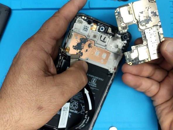

  3. Redmi Note 9 Pro - Reboots, Power On flex Replacement, Motherboard removal - part 1: crwdns2935265:03crwdnd2935265:01crwdnd2935265:03crwdne2935265:0 Redmi Note 9 Pro - Reboots, Power On flex Replacement, Motherboard removal - part 1: crwdns2935265:03crwdnd2935265:02crwdnd2935265:03crwdne2935265:0 Redmi Note 9 Pro - Reboots, Power On flex Replacement, Motherboard removal - part 1: crwdns2935265:03crwdnd2935265:03crwdnd2935265:03crwdne2935265:0
    • Lift up the flex connector to disconnect the battery.
    • Remove the main cameras.
    • Remove the SIM tray.

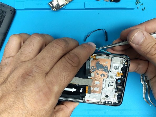

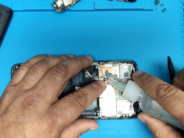

  5. Redmi Note 9 Pro - Reboots, Power On flex Replacement, Power on and volume buttons flex cable removal.: crwdns2935265:05crwdnd2935265:01crwdnd2935265:03crwdne2935265:0 Redmi Note 9 Pro - Reboots, Power On flex Replacement, Power on and volume buttons flex cable removal.: crwdns2935265:05crwdnd2935265:02crwdnd2935265:03crwdne2935265:0 Redmi Note 9 Pro - Reboots, Power On flex Replacement, Power on and volume buttons flex cable removal.: crwdns2935265:05crwdnd2935265:03crwdnd2935265:03crwdne2935265:0
    • Remove the Fingerprint sensor.
    • Remove the volume buttons plastic cap.
    • Use isopropyl alcohol to help remove the glued down flex cable.

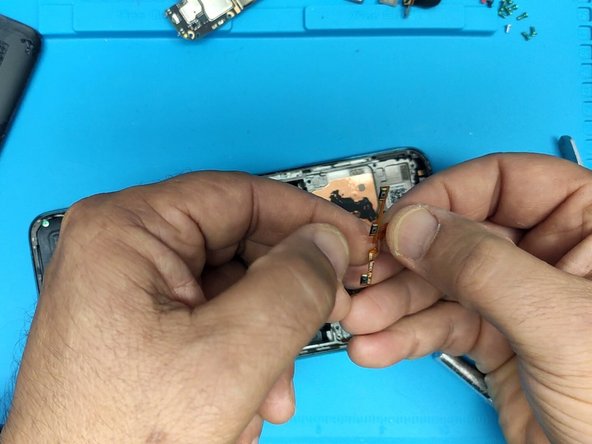

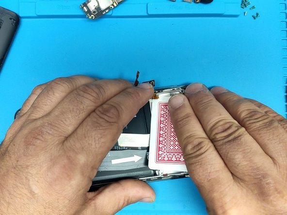

  6. Redmi Note 9 Pro - Reboots, Power On flex Replacement, Power on and volume buttons flex cable removal: crwdns2935265:06crwdnd2935265:01crwdnd2935265:03crwdne2935265:0 Redmi Note 9 Pro - Reboots, Power On flex Replacement, Power on and volume buttons flex cable removal: crwdns2935265:06crwdnd2935265:02crwdnd2935265:03crwdne2935265:0 Redmi Note 9 Pro - Reboots, Power On flex Replacement, Power on and volume buttons flex cable removal: crwdns2935265:06crwdnd2935265:03crwdnd2935265:03crwdne2935265:0
    • Use playing cards to remove the flex cable.
