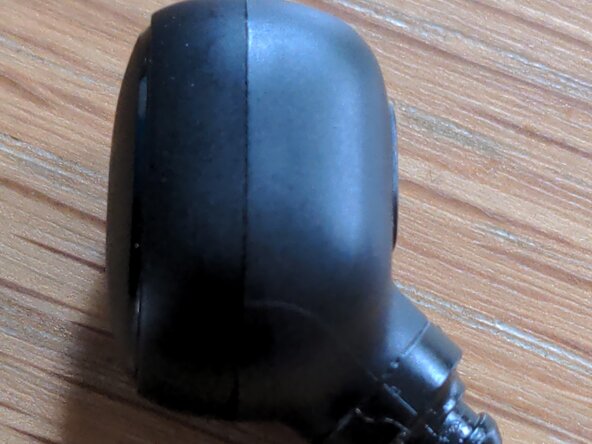

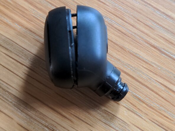

    • These earbuds are held together with plastic clips, rather than the glue seen in more expensive models.

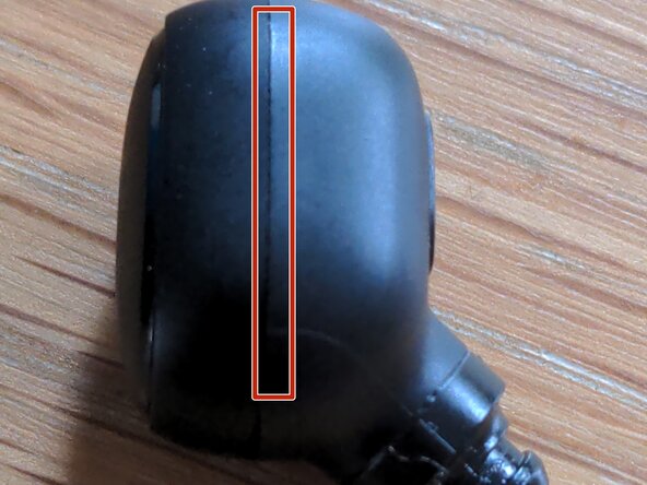

    • Insert a sharp knife into the the seam, and carefully work it around the earbud to create a gap.
    • Carefully separate the two halves, but remember they are still held together by wires.

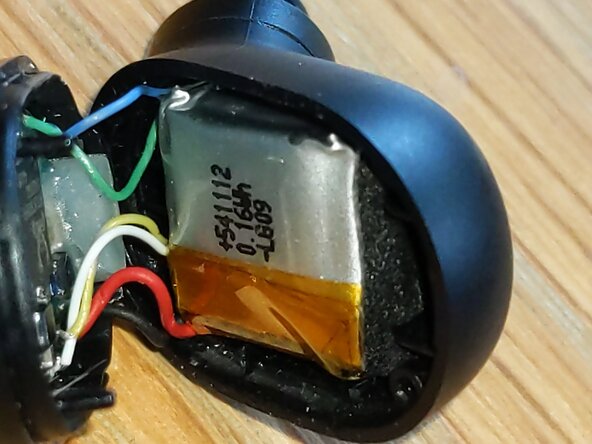

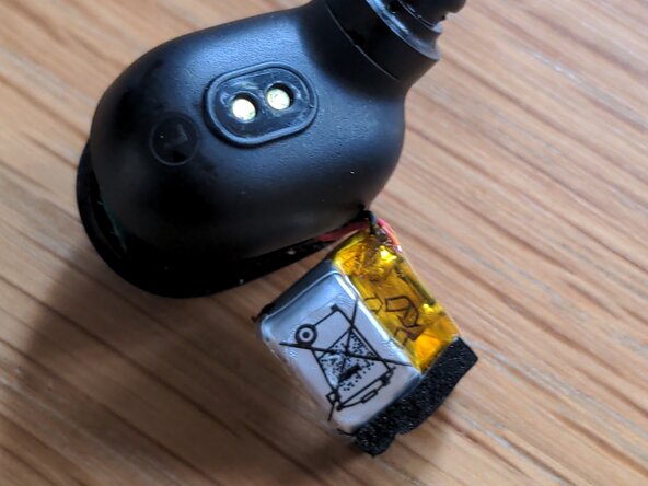

    • Pry out the battery and rotate it so that the back faces towards you
    • Remove the yellow Kapton tape and black foam pad from the old battery
    • The two solder pads on the battery should now be exposed. I don't recommend touching the solder pads on the earbud's circuit board as there is much less space to work with, making it easy to damage.
    • Carefully heat up each solder pad and pull away the wire from each one.

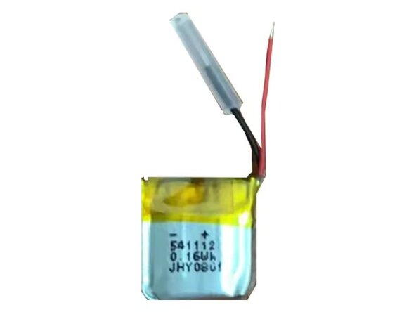

    • If your new battery comes with wires, like in the photo, you should remove them like in the previous step.
    • Line up the red and black wires with the corresponding + and - terminals on your new battery. There should be marking to indicate which is which.
    • Solder the connections. Now try testing the earbud - if it turns on, congratulations! Replace the foam pad and add new Kapton tape if needed.
