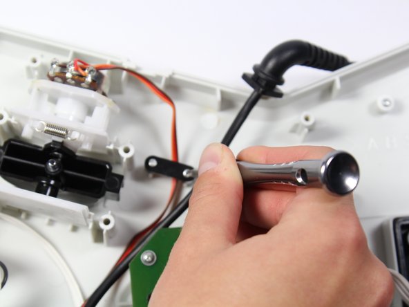

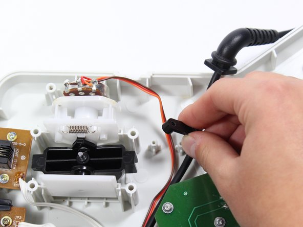

  4. RedOctane X-Plorer Whammy Bar Replacement, Whammy Bar: crwdns2935265:04crwdnd2935265:01crwdnd2935265:03crwdne2935265:0 RedOctane X-Plorer Whammy Bar Replacement, Whammy Bar: crwdns2935265:04crwdnd2935265:02crwdnd2935265:03crwdne2935265:0 RedOctane X-Plorer Whammy Bar Replacement, Whammy Bar: crwdns2935265:04crwdnd2935265:03crwdnd2935265:03crwdne2935265:0
    • Remove the two 7mm Phillips #2 screws from the black wire retainer.
    • Pull off the black wire retainer.

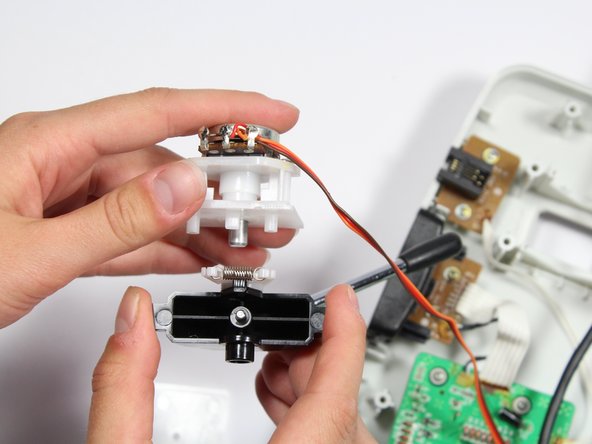

  7. RedOctane X-Plorer Whammy Bar Replacement: crwdns2935265:07crwdnd2935265:01crwdnd2935265:01crwdne2935265:0
    • Remove the two plastic tabs from the whammy bar casing.
    • Keep the spring connected to the plastic tabs throughout this step.
  8. RedOctane X-Plorer Whammy Bar Replacement: crwdns2935265:08crwdnd2935265:01crwdnd2935265:01crwdne2935265:0
    • Using two hands, remove the spring from the plastic tabs.
