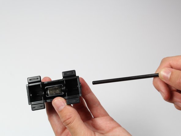

  6. RedOctane X-Plorer Strum Bar Replacement: crwdns2935265:06crwdnd2935265:01crwdnd2935265:02crwdne2935265:0 RedOctane X-Plorer Strum Bar Replacement: crwdns2935265:06crwdnd2935265:02crwdnd2935265:02crwdne2935265:0
    • Remove the string rod by gently pulling it out of the strum bar.

I had a squeaking strum bar so I followed this guide to dismantle and clean the parts. Other than the one step missed in the guide it was easy to follow. It also stopped the squeaking!
Zachary Avery - crwdns2934203:0crwdne2934203:0
Thanks! pretty simple repair. I added a little synthetic lube to the strum bar and all quiet and smooth action now.
