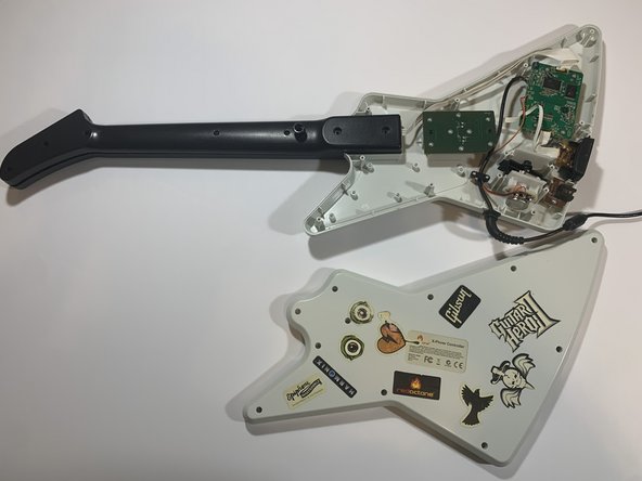

  2. RedOctane X-Plorer Rubber Button Strip Replacement: crwdns2935265:02crwdnd2935265:01crwdnd2935265:01crwdne2935265:0
    • Remove all nine 12mm screws around the perimeter of the body of the controller, using the Phillips #2 screwdriver.
    • Remove the two 15mm screws near the neck of the controller, using the Phillips #2 screwdriver.

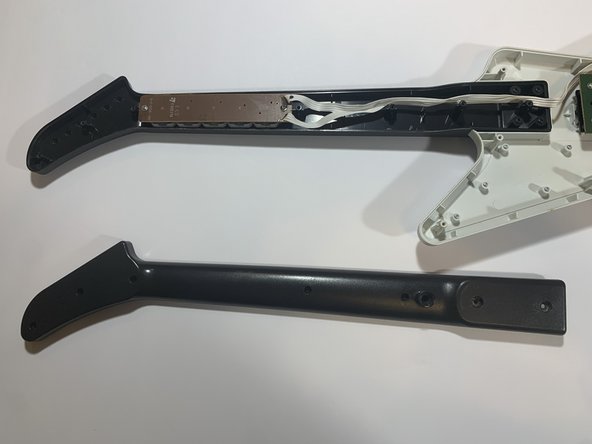

  3. RedOctane X-Plorer Rubber Button Strip Replacement: crwdns2935265:03crwdnd2935265:01crwdnd2935265:02crwdne2935265:0 RedOctane X-Plorer Rubber Button Strip Replacement: crwdns2935265:03crwdnd2935265:02crwdnd2935265:02crwdne2935265:0
    • Using your hands, remove the body shell.

  5. RedOctane X-Plorer Rubber Button Strip Replacement: crwdns2935265:05crwdnd2935265:01crwdnd2935265:02crwdne2935265:0 RedOctane X-Plorer Rubber Button Strip Replacement: crwdns2935265:05crwdnd2935265:02crwdnd2935265:02crwdne2935265:0
    • Using your hands, remove the top shell of neck.

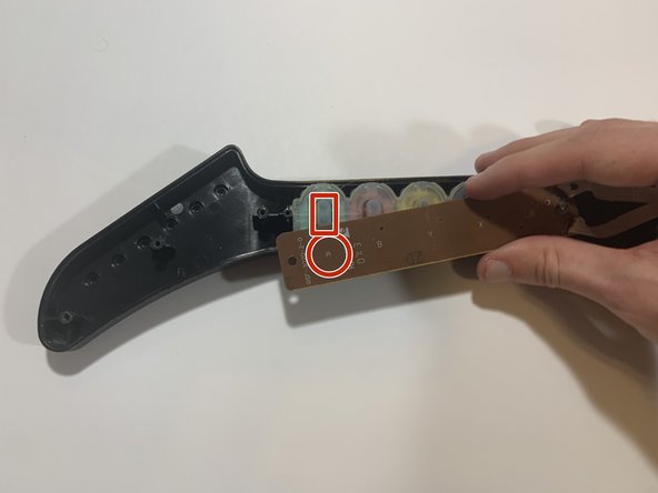

    • Remove the left 1.5mm mm screw (as shown) on the key sensor board, using the 1.5mm flathead screwdriver.
    • Do not remove the other (right-side) screw on key sensor board, as this can cause damage to the circuitry.

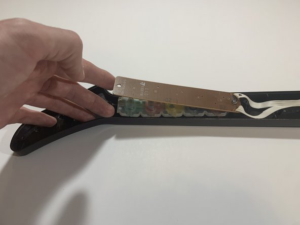

  7. RedOctane X-Plorer Rubber Button Strip Replacement: crwdns2935265:07crwdnd2935265:01crwdnd2935265:02crwdne2935265:0 RedOctane X-Plorer Rubber Button Strip Replacement: crwdns2935265:07crwdnd2935265:02crwdnd2935265:02crwdne2935265:0
    • Using your hands, remove the rubber button strip.

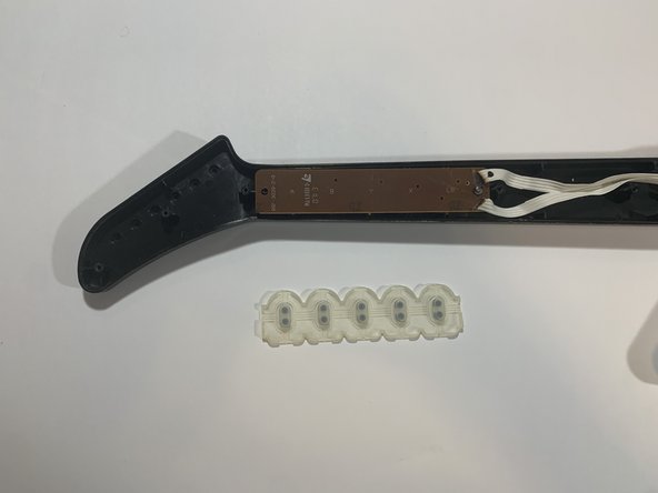

  8. RedOctane X-Plorer Rubber Button Strip Replacement: crwdns2935265:08crwdnd2935265:01crwdnd2935265:02crwdne2935265:0 RedOctane X-Plorer Rubber Button Strip Replacement: crwdns2935265:08crwdnd2935265:02crwdnd2935265:02crwdne2935265:0
    • Using your hands, insert the replacement strip underneath the key sensor board.
