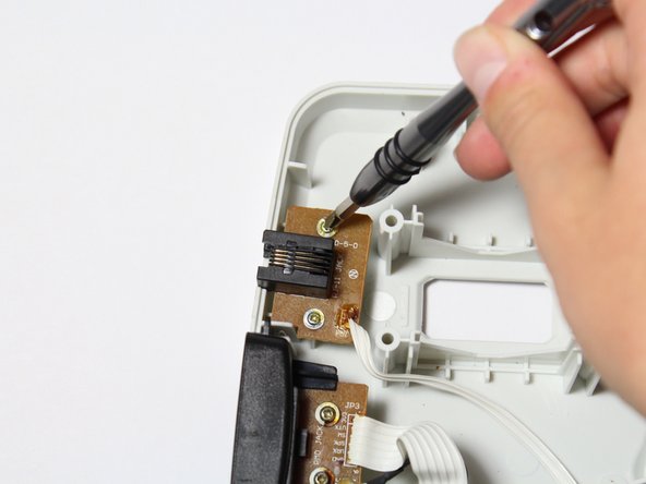

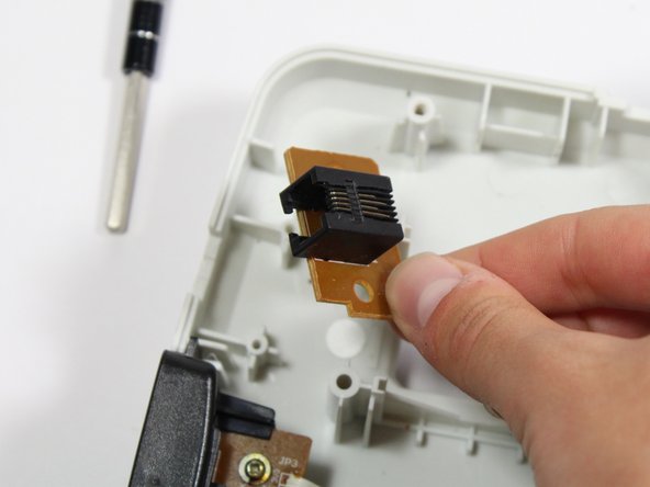

  5. RedOctane X-Plorer Motherboard Replacement, RJ-14 Connector: crwdns2935265:05crwdnd2935265:01crwdnd2935265:03crwdne2935265:0 RedOctane X-Plorer Motherboard Replacement, RJ-14 Connector: crwdns2935265:05crwdnd2935265:02crwdnd2935265:03crwdne2935265:0 RedOctane X-Plorer Motherboard Replacement, RJ-14 Connector: crwdns2935265:05crwdnd2935265:03crwdnd2935265:03crwdne2935265:0
    • Remove the two 10mm Phillips #1 screws from the RJ-14 connector board.
    • Lift the RJ-14 connector to remove it from the case.

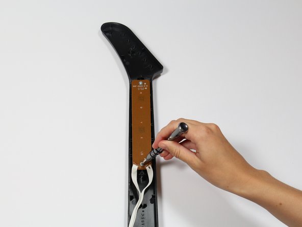

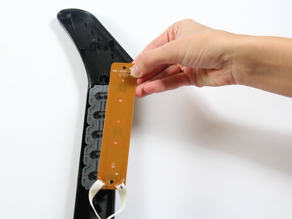

  6. RedOctane X-Plorer Motherboard Replacement, Keys: crwdns2935265:06crwdnd2935265:01crwdnd2935265:03crwdne2935265:0 RedOctane X-Plorer Motherboard Replacement, Keys: crwdns2935265:06crwdnd2935265:02crwdnd2935265:03crwdne2935265:0 RedOctane X-Plorer Motherboard Replacement, Keys: crwdns2935265:06crwdnd2935265:03crwdnd2935265:03crwdne2935265:0
    • Use a screwdriver to remove the 10 mm Phillips #1 screws from the key sensor board.
    • Lift up on the key sensor board to remove it from the guitar neck.
    • When using the screwdriver, make sure to avoid puncturing the wires.

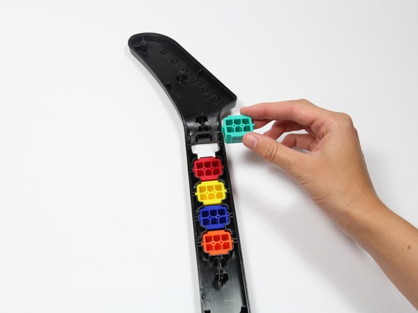

    • Using your fingers, remove the rubber pad to expose the colored keys.
  8. RedOctane X-Plorer Motherboard Replacement: crwdns2935265:08crwdnd2935265:01crwdnd2935265:02crwdne2935265:0 RedOctane X-Plorer Motherboard Replacement: crwdns2935265:08crwdnd2935265:02crwdnd2935265:02crwdne2935265:0
    • Reach one finger under the guitar to push the key out of the casing.
    • Repeat this step for the four remaining keys.

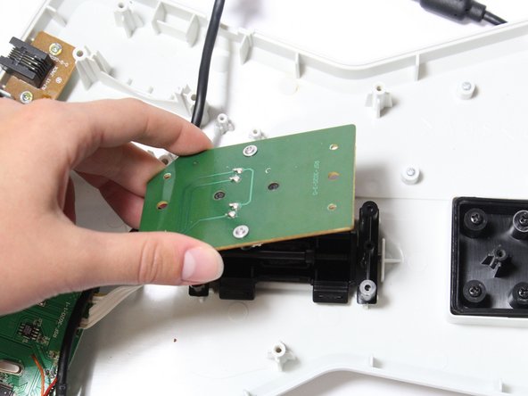

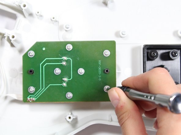

  9. RedOctane X-Plorer Motherboard Replacement, Strum Bar Sensor Board: crwdns2935265:09crwdnd2935265:01crwdnd2935265:03crwdne2935265:0 RedOctane X-Plorer Motherboard Replacement, Strum Bar Sensor Board: crwdns2935265:09crwdnd2935265:02crwdnd2935265:03crwdne2935265:0 RedOctane X-Plorer Motherboard Replacement, Strum Bar Sensor Board: crwdns2935265:09crwdnd2935265:03crwdnd2935265:03crwdne2935265:0
    • Use a screwdriver to remove the four 14mm Phillips #1 screws around the perimeter of the strum bar sensor board.
    • Lift up on the strum bar sensor board to remove it from the case.

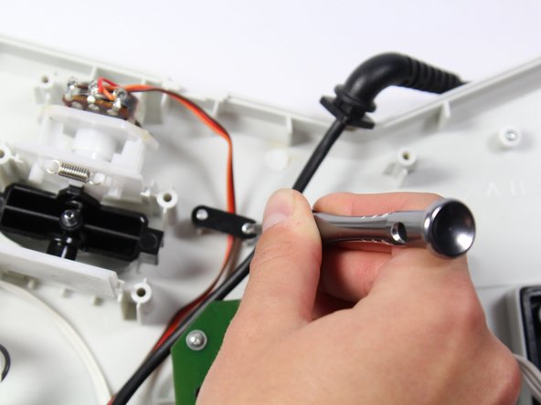

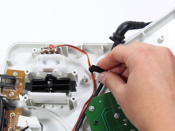

  10. RedOctane X-Plorer Motherboard Replacement, Whammy Bar Sensor: crwdns2935265:010crwdnd2935265:01crwdnd2935265:03crwdne2935265:0 RedOctane X-Plorer Motherboard Replacement, Whammy Bar Sensor: crwdns2935265:010crwdnd2935265:02crwdnd2935265:03crwdne2935265:0 RedOctane X-Plorer Motherboard Replacement, Whammy Bar Sensor: crwdns2935265:010crwdnd2935265:03crwdnd2935265:03crwdne2935265:0
    • Remove the two 7mm Phillips #0 screws.
    • Using your fingers, remove the black wire retainer.

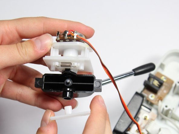

  11. RedOctane X-Plorer Motherboard Replacement: crwdns2935265:011crwdnd2935265:01crwdnd2935265:02crwdne2935265:0 RedOctane X-Plorer Motherboard Replacement: crwdns2935265:011crwdnd2935265:02crwdnd2935265:02crwdne2935265:0
    • Using one hand, remove the whammy bar and its attached components from the case.
  12. RedOctane X-Plorer Motherboard Replacement: crwdns2935265:012crwdnd2935265:01crwdnd2935265:01crwdne2935265:0
    • Using two hands, remove the whammy bar sensor.

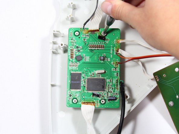

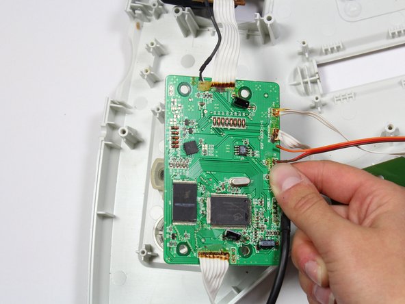

  13. RedOctane X-Plorer Motherboard Replacement, Motherboard: crwdns2935265:013crwdnd2935265:01crwdnd2935265:03crwdne2935265:0 RedOctane X-Plorer Motherboard Replacement, Motherboard: crwdns2935265:013crwdnd2935265:02crwdnd2935265:03crwdne2935265:0 RedOctane X-Plorer Motherboard Replacement, Motherboard: crwdns2935265:013crwdnd2935265:03crwdnd2935265:03crwdne2935265:0
    • Remove the four 10mm Phillips #1 screws around the perimeter of the motherboard with a screwdriver.
    • Lift the motherboard to remove it from the case.
