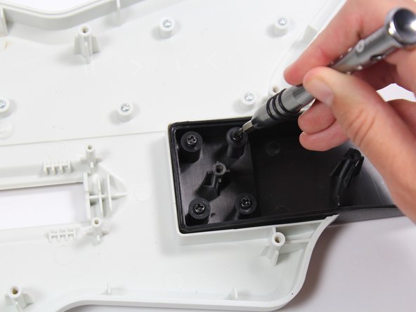

  14. RedOctane X-Plorer Front Case Replacement, Front Case: crwdns2935265:014crwdnd2935265:01crwdnd2935265:02crwdne2935265:0 RedOctane X-Plorer Front Case Replacement, Front Case: crwdns2935265:014crwdnd2935265:02crwdnd2935265:02crwdne2935265:0
    • Remove the four 12mm Phillips #1 that connect the body to the neck using a screwdriver.
  15. RedOctane X-Plorer Front Case Replacement: crwdns2935265:015crwdnd2935265:01crwdnd2935265:01crwdne2935265:0
    • Remove the neck panel from the front body panel.
