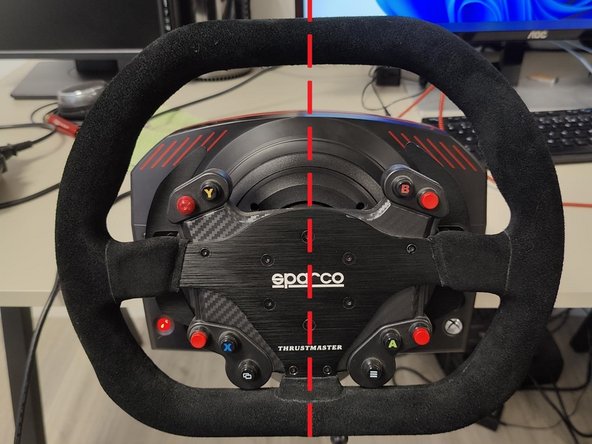

    • Connect your steering wheel to your console/computer.
    • On PC, set the rotation angle to 1080° in Thrustmaster Control Panel.
    • On Console, manually set the rotation angle to 1080°.
  2. Recentering Thrustmaster TS XW, Reset the center.: crwdns2935265:02crwdnd2935265:01crwdnd2935265:03crwdne2935265:0 Recentering Thrustmaster TS XW, Reset the center.: crwdns2935265:02crwdnd2935265:02crwdnd2935265:03crwdne2935265:0 Recentering Thrustmaster TS XW, Reset the center.: crwdns2935265:02crwdnd2935265:03crwdnd2935265:03crwdne2935265:0
    • Steer your wheel completely to the left, until it reaches a physical stop.
    • Steer your wheel completely to the right, until it reaches a physical stop.
    • Center your wheel.
    • Press the buttons to recenter your steering wheel. These buttons depend on the steering wheel used, you will find the list on this link.
