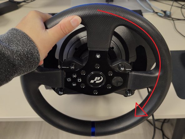

    • Connect and start the steering wheel.
    • If you are on a PC, set the rotation angle to 1080° from the Thrustmaster control panel.
    • If you are on a console, manually set the rotation angle to 1080°.
    • To do this, press the “Right D-PAD + MODE” buttons simultaneously to increase the angle of rotation. The base LED should flash 5 times.
  2. Recalibrating the center of Thrustmaster T300, Recalibrating the center: crwdns2935265:02crwdnd2935265:01crwdnd2935265:03crwdne2935265:0 Recalibrating the center of Thrustmaster T300, Recalibrating the center: crwdns2935265:02crwdnd2935265:02crwdnd2935265:03crwdne2935265:0 Recalibrating the center of Thrustmaster T300, Recalibrating the center: crwdns2935265:02crwdnd2935265:03crwdnd2935265:03crwdne2935265:0
    • Turn the steering wheel all the way to the left, as far as it will go.
    • Turn the steering wheel all the way to the right, as far as it will go.
    • Recenter your wheel.
    • Press the buttons to recenter the steering wheel. These buttons vary depending on what model you have, but you can find out which to use here.
    • Once the central value has been reset, the LED on your base should then briefly change color, validating the procedure.
    • You can then verify whether the wheel is steering properly using the Thrustmaster Control Panel.
