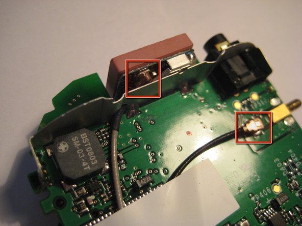

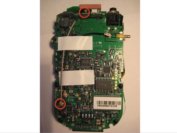

  10. Reattaching Delphi MyFi XM2GO Antenna Connectors, Reattaching Delphi MyFi XM2GO Antenna Connectors: crwdns2935265:010crwdnd2935265:01crwdnd2935265:02crwdne2935265:0 Reattaching Delphi MyFi XM2GO Antenna Connectors, Reattaching Delphi MyFi XM2GO Antenna Connectors: crwdns2935265:010crwdnd2935265:02crwdnd2935265:02crwdne2935265:0
    • In the first picture, a connection may be seen with the black cable connecting the external antenna connector to the internal logic board (PCB) via U.FL connectors. The connectors on the ends of the cable are circled in red.
    • In the second picture, a connection may be seen with the with the gray cable connecting the external antenna connector to the internal logic board (PCB) via U.FL connectors. The connectors on the ends of the cable are circled in red.

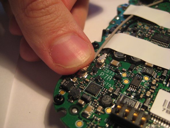

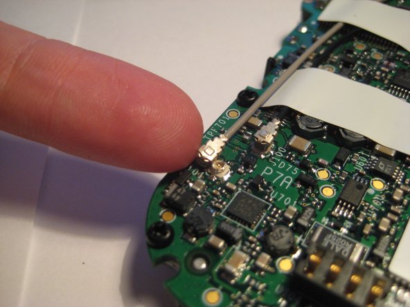

  11. Reattaching Delphi MyFi XM2GO Antenna Connectors: crwdns2935265:011crwdnd2935265:01crwdnd2935265:03crwdne2935265:0 Reattaching Delphi MyFi XM2GO Antenna Connectors: crwdns2935265:011crwdnd2935265:02crwdnd2935265:03crwdne2935265:0 Reattaching Delphi MyFi XM2GO Antenna Connectors: crwdns2935265:011crwdnd2935265:03crwdnd2935265:03crwdne2935265:0
    • These antenna cables may need to be replaced should the connection drop from the XM Satellite service.
    • To remove, catch the side of the connector with a fingernail moving upward until the connectors pops up from the board.
    • After the U.FL connector is loose, center the new connector cable over the mating U.FL connector and press down firmly.
    • CAUTION: The connectors are delicate, so take much care when reconnecting.
  12. Reattaching Delphi MyFi XM2GO Antenna Connectors: crwdns2935265:012crwdnd2935265:01crwdnd2935265:02crwdne2935265:0 Reattaching Delphi MyFi XM2GO Antenna Connectors: crwdns2935265:012crwdnd2935265:02crwdnd2935265:02crwdne2935265:0
    • The U.FL antenna connectors should be secure and immobile as shown in the pictures.
    • Try moving them back and forth on the board to assure they are secure.
    • The U.FL antenna connectors are shown to be secure in the pictures highlighted with red boxes.
