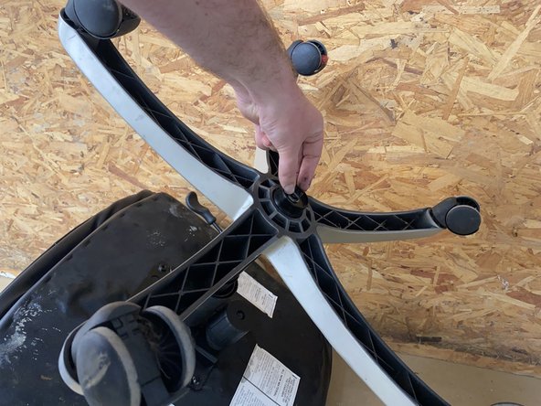

  3. Realspace EC600 Office Chair Lift Cylinder Replacement: crwdns2935265:03crwdnd2935265:01crwdnd2935265:01crwdne2935265:0
    • Lift the base off of the lift cylinder.
    • The rubber bumper, washers, and bearings may fall off during this step.

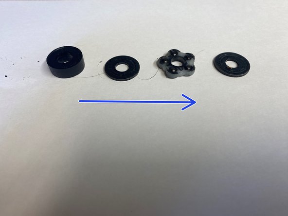

  4. Realspace EC600 Office Chair Lift Cylinder Replacement: crwdns2935265:04crwdnd2935265:01crwdnd2935265:01crwdne2935265:0
    • Remove the rubber bumper, washers, and bearings.

  9. Realspace EC600 Office Chair Lift Cylinder Replacement: crwdns2935265:09crwdnd2935265:01crwdnd2935265:02crwdne2935265:0 Realspace EC600 Office Chair Lift Cylinder Replacement: crwdns2935265:09crwdnd2935265:02crwdnd2935265:02crwdne2935265:0
    • Push the rubber bumper, washers, and bearings onto the lift cylinder.
    • The order should be from the chair to the rubber bumper, washer, bearings, and then the other washer.
  10. Realspace EC600 Office Chair Lift Cylinder Replacement: crwdns2935265:010crwdnd2935265:01crwdnd2935265:01crwdne2935265:0
    • Set the base over the lift cylinder and press it onto the cylinder.
