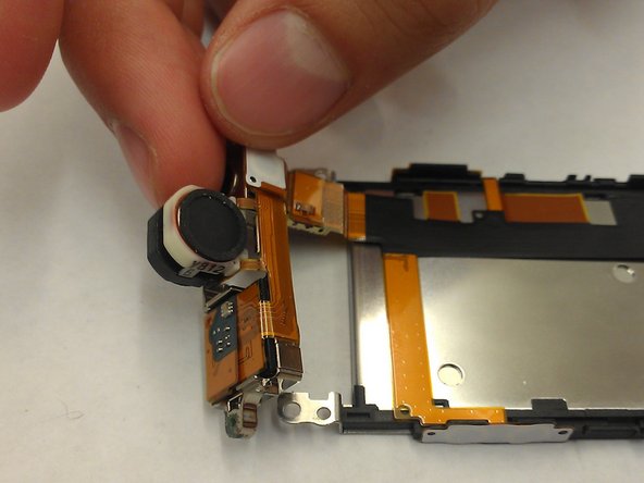

  8. Reaching the Speaker and Camera in SONY Ericsson W890i Cell Phone: crwdns2935265:08crwdnd2935265:01crwdnd2935265:02crwdne2935265:0 Reaching the Speaker and Camera in SONY Ericsson W890i Cell Phone: crwdns2935265:08crwdnd2935265:02crwdnd2935265:02crwdne2935265:0
    • The speaker and camera combo is accessible after the removal of two small #00 screws. Use the #00 Philips Screwdriver for this step.
    • The piece is now free to move from the phone core.
