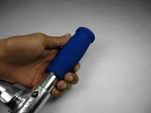

    • If the scooter does not already have handle grips, skip to step 2.
    • Locate the handle grips at the upper ends of the T-tube.
    • Be careful to keep the scissors away from your other hand while cutting the handle grips.
    • Wedge one end of a pair of scissors between the metal T-tube and a handle grip, with the cutting edge toward the handle grip. Cut the handle grip off.
    • Repeat for the other handle grip.
  2. Razor A Handle Grips Replacement: crwdns2935265:02crwdnd2935265:01crwdnd2935265:02crwdne2935265:0 Razor A Handle Grips Replacement: crwdns2935265:02crwdnd2935265:02crwdnd2935265:02crwdne2935265:0
    • Soak the replacement handle grips in warm water for 2-3 minutes.
    • The longer you soak the handle grips in water, the larger they get. Soaking the handle grips for a long time will not damage them.
  3. Razor A Handle Grips Replacement: crwdns2935265:03crwdnd2935265:01crwdnd2935265:02crwdne2935265:0 Razor A Handle Grips Replacement: crwdns2935265:03crwdnd2935265:02crwdnd2935265:02crwdne2935265:0
    • Each handle grip should now slide onto the T-tube with ease. If not, soak the handle grip(s) in warm water for another 1-3 minutes.
    • Holding the T-tube with one hand, slide a handle grip completely onto the T-tube.
    • Repeat for the other handle grip if installing both.
    • Let the handle grips dry for 24 hours before use.
