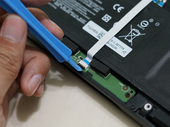

    • At the top center of the battery, use the opening tool to flip the ribbon cable ZIF latch up.
  4. Razer blade 14'' (2017) Battery Replacement: crwdns2935265:04crwdnd2935265:01crwdnd2935265:03crwdne2935265:0 Razer blade 14'' (2017) Battery Replacement: crwdns2935265:04crwdnd2935265:02crwdnd2935265:03crwdne2935265:0 Razer blade 14'' (2017) Battery Replacement: crwdns2935265:04crwdnd2935265:03crwdnd2935265:03crwdne2935265:0
    • At the bottom center of the battery, use the opening tool to flip the ribbon cable ZIF latch up. (similar way from step 3)
    • Slide both ends out of the ZIF connector. Remove the touchpad ribbon cable that overlaps the battery.
