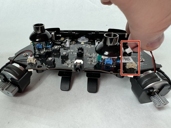

    • Locate the right vibration motor on the bottom right corner on the front of the controller.
  7. Razer Wolverine V2 Chroma RZ06-0401 Vibration Motors Replacement: crwdns2935265:07crwdnd2935265:01crwdnd2935265:03crwdne2935265:0 Razer Wolverine V2 Chroma RZ06-0401 Vibration Motors Replacement: crwdns2935265:07crwdnd2935265:02crwdnd2935265:03crwdne2935265:0 Razer Wolverine V2 Chroma RZ06-0401 Vibration Motors Replacement: crwdns2935265:07crwdnd2935265:03crwdnd2935265:03crwdne2935265:0

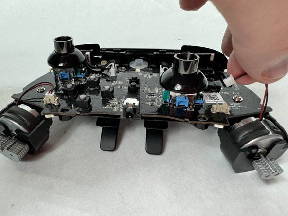

    • Unplug the red and black cord that connects the right vibration motor to the controller.

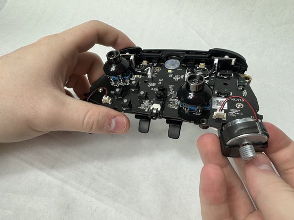

  8. Razer Wolverine V2 Chroma RZ06-0401 Vibration Motors Replacement: crwdns2935265:08crwdnd2935265:01crwdnd2935265:02crwdne2935265:0 Razer Wolverine V2 Chroma RZ06-0401 Vibration Motors Replacement: crwdns2935265:08crwdnd2935265:02crwdnd2935265:02crwdne2935265:0

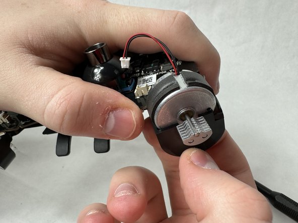

    • Remove the right vibration motor from the controller by pushing it up from the bottom.
    • Repeat steps 6-8 for the left vibration motor.
