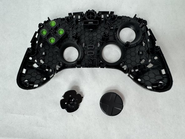

  6. Razer Wolverine V2 Chroma RZ06-0401 D-Pad Replacement, D-Pad: crwdns2935265:06crwdnd2935265:01crwdnd2935265:02crwdne2935265:0 Razer Wolverine V2 Chroma RZ06-0401 D-Pad Replacement, D-Pad: crwdns2935265:06crwdnd2935265:02crwdnd2935265:02crwdne2935265:0
    • Look at the inside of the inner front plate.
    • Where the curtains are, pop off the back of the piece that pushes the buttons.

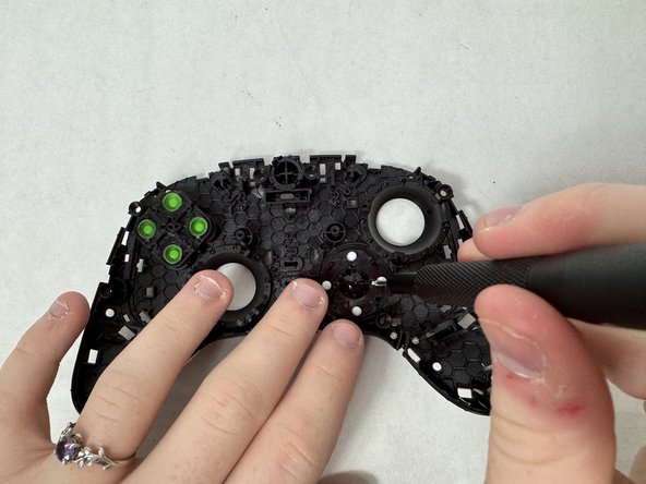

  7. Razer Wolverine V2 Chroma RZ06-0401 D-Pad Replacement: crwdns2935265:07crwdnd2935265:01crwdnd2935265:03crwdne2935265:0 Razer Wolverine V2 Chroma RZ06-0401 D-Pad Replacement: crwdns2935265:07crwdnd2935265:02crwdnd2935265:03crwdne2935265:0 Razer Wolverine V2 Chroma RZ06-0401 D-Pad Replacement: crwdns2935265:07crwdnd2935265:03crwdnd2935265:03crwdne2935265:0
    • Remove three 5 mm screws from the D-pad using a Phillips #000 screwdriver.
  8. Razer Wolverine V2 Chroma RZ06-0401 D-Pad Replacement: crwdns2935265:08crwdnd2935265:01crwdnd2935265:02crwdne2935265:0 Razer Wolverine V2 Chroma RZ06-0401 D-Pad Replacement: crwdns2935265:08crwdnd2935265:02crwdnd2935265:02crwdne2935265:0
    • Remove the D-pad.
